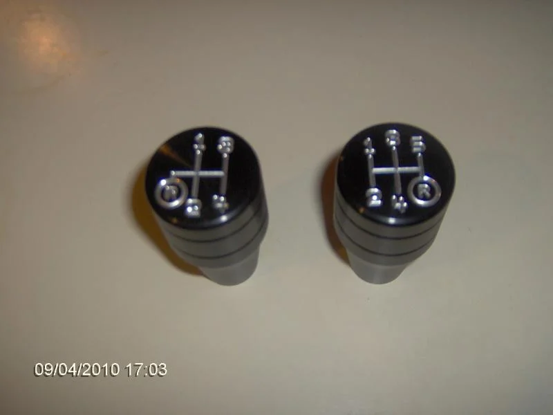

ps, here's something you might be interested in. Valley Hybrids exclusive:
i now offer 4spd and 5spd billet shift knobs for the h42 and h55f transmissions. these match the AA billet shift knobs for the twin stick setup. due to the low volume they're not cheap, $42.98 each.
here's a pic.
georg @ valley hybrids
