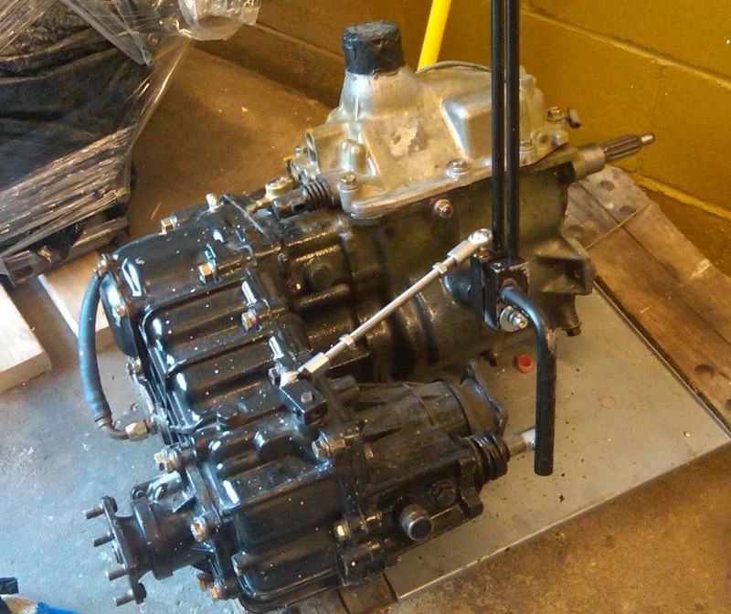

just finished another h55f combo for a customer/friend/fellow mudder. started with a used 5spd. rebuiklt it, added an fj62 split case, marks gears and modified it for mechanical shiift along with my twin stick kit. pretty happy with how it turned out, considering what i started with. :wrench:
"after" pic.:grinpimp:
georg @ valley hybrids
here are a couple of pics of the linkage attachment point at the 2-4 shift rod.
i don't have written instructions for the kits yet but i will do my best to write up an install thread on here later next week.

looking good, but your high-neutral-low shift block is on backwards. in order to get the proper geometry, take it off,flip it upside down and re-install it. take a look at the pics early in this thread and it should be very easy to figure out.
the set screw should come in from the front and seat on the flat part of the shift shaft ( sticks out of the top of the case ).
