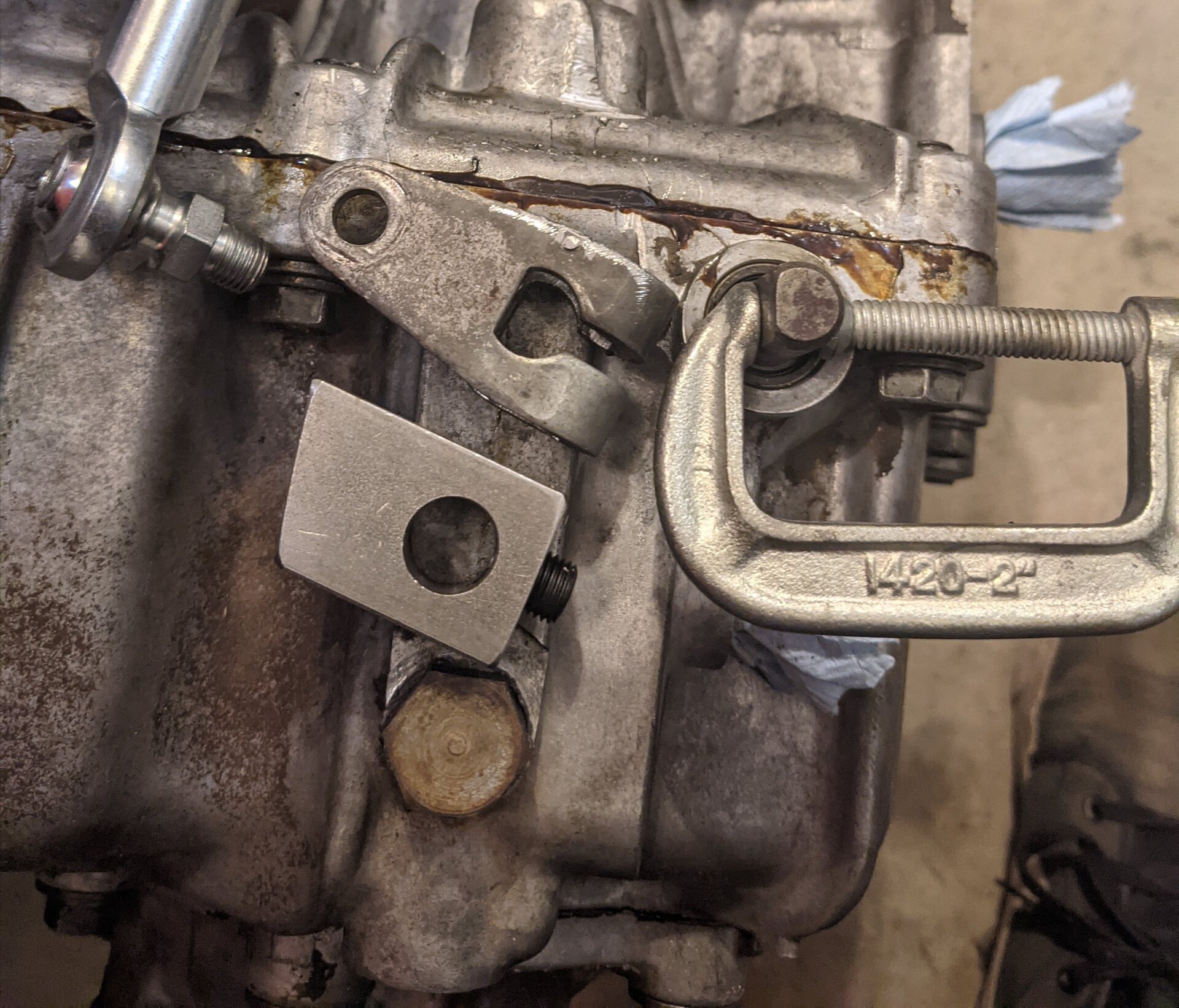

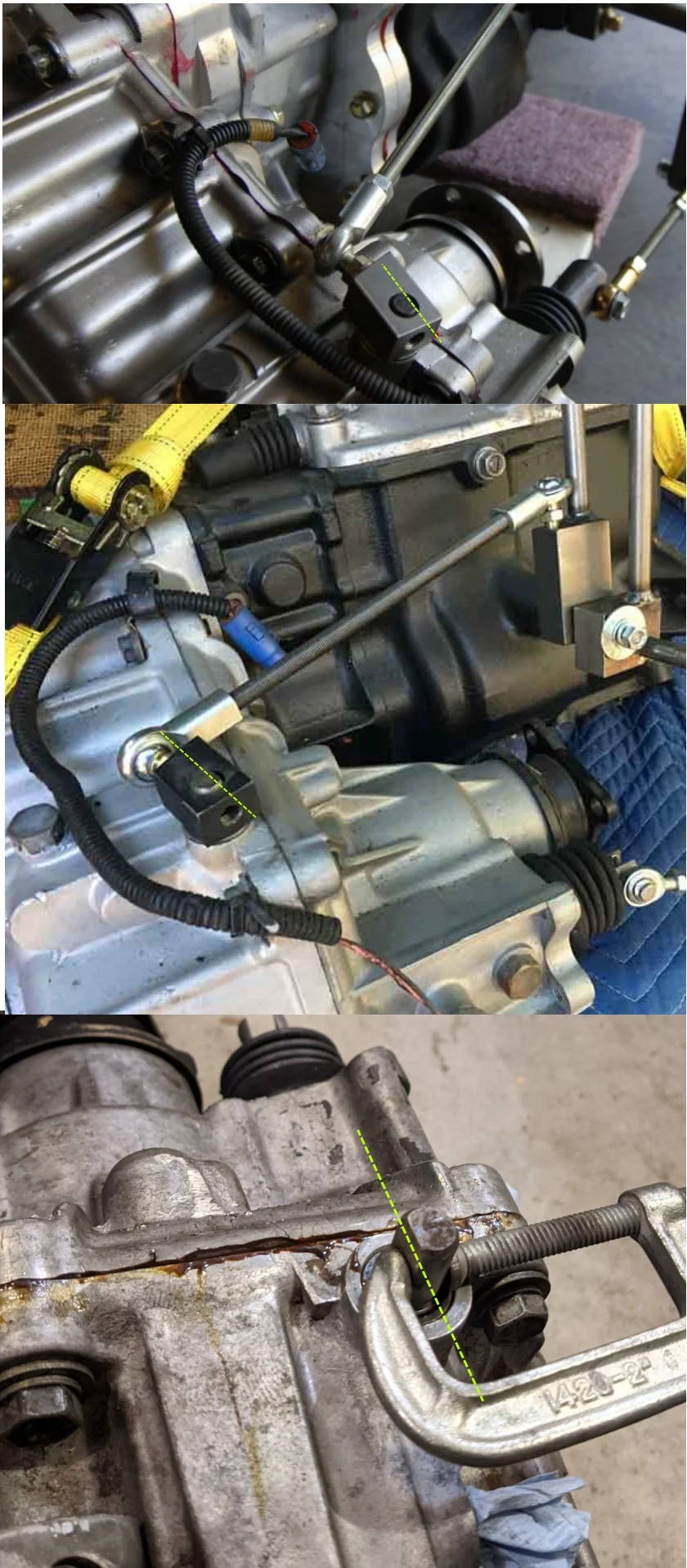

From what Ive seen, the HNL lever orients this way, however, the flat part of the shaft is on the opposite side of what it needs to be for the set screw. What's up with that, has anyone else seen this? Should I just rig it up with the stock lever pictured?
You’re 90 degrees off. Rotate it clockwise. …….
Edit: thanks to Georg for the call, turns out I had a vacuum shift lever thing in my non-vacuum case. I didn't know they had different parts, or how my used case ended up with that one, but things are making sense now.
Thanks for the reply. From what I've seen in this thread, it seems like the shaft in mine is off 90 degrees. Even if I shift it, I cant get it to rotate much at all to look like the other pictures (mine is at the bottom, the flat face of the shaft is more parallel to the length of the transmission, where the first 2 are perpendicular)
Send me a message with your info and I’ll give you a call. Let’s get this figured out.

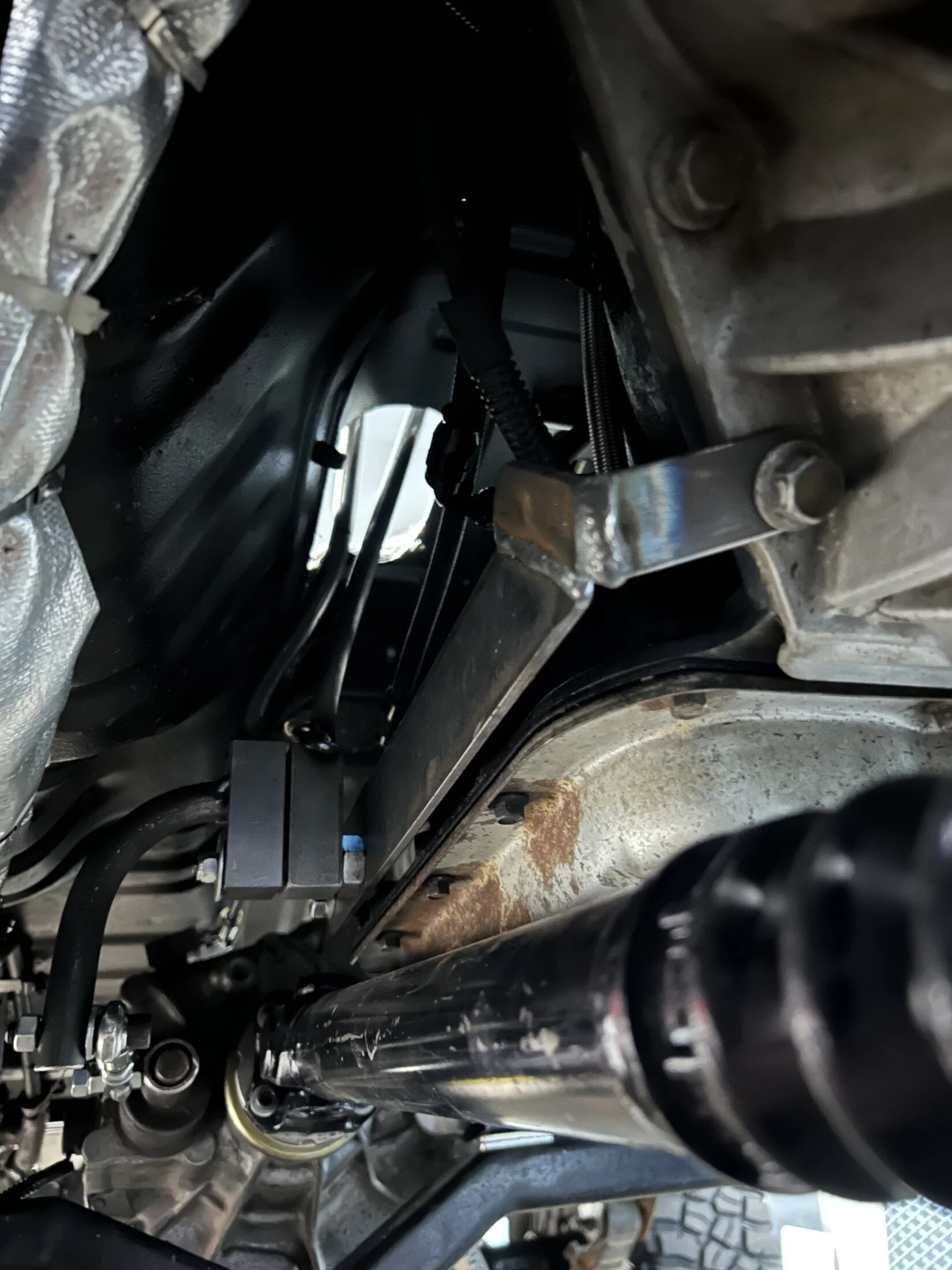

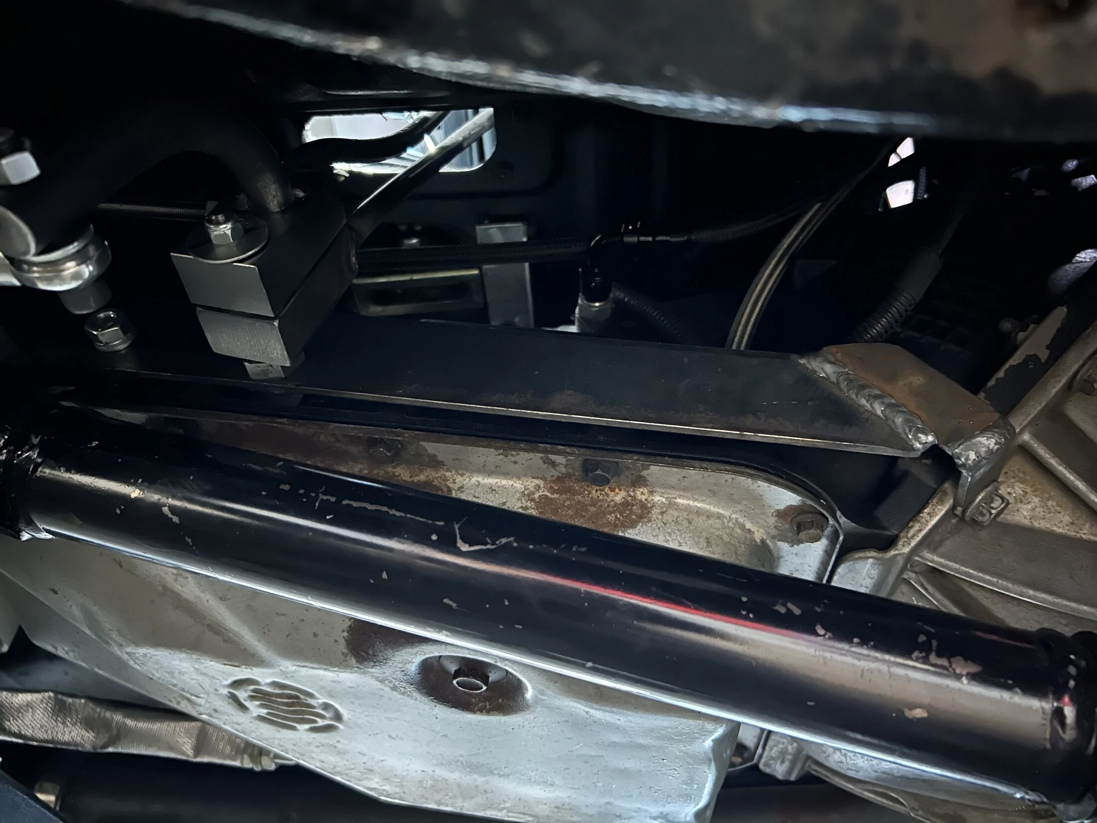

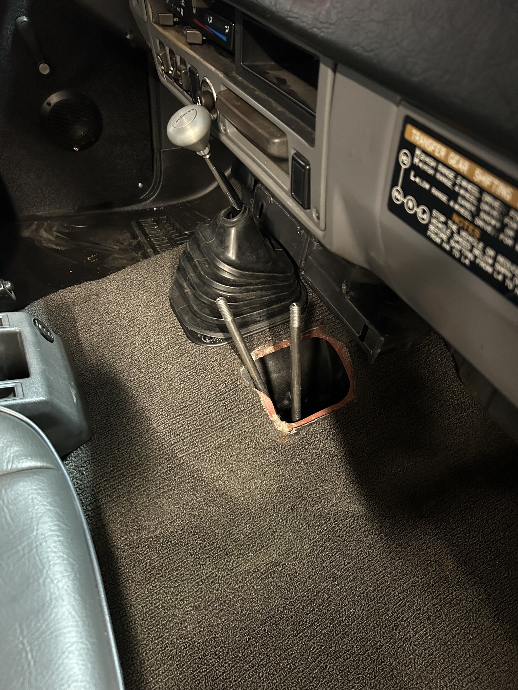

Haven’t seen any one document doing this with a stock split case and a 4l80. I did an LS swap with a 4l80, advance adapters tcase adapter, and stock Toyota split case. This would have been easier to do while the motor and transmission was out but totally doable with it installed. All I had to do was drop a piece of the exhaust. Handles lined up pretty good with original hole too.
When you have an auto matic you loose the mounting hole for the stud rhat the twin sticks pivot on so you have to come up with a new mount. Lots of different ways to build a mount but here’s what I did

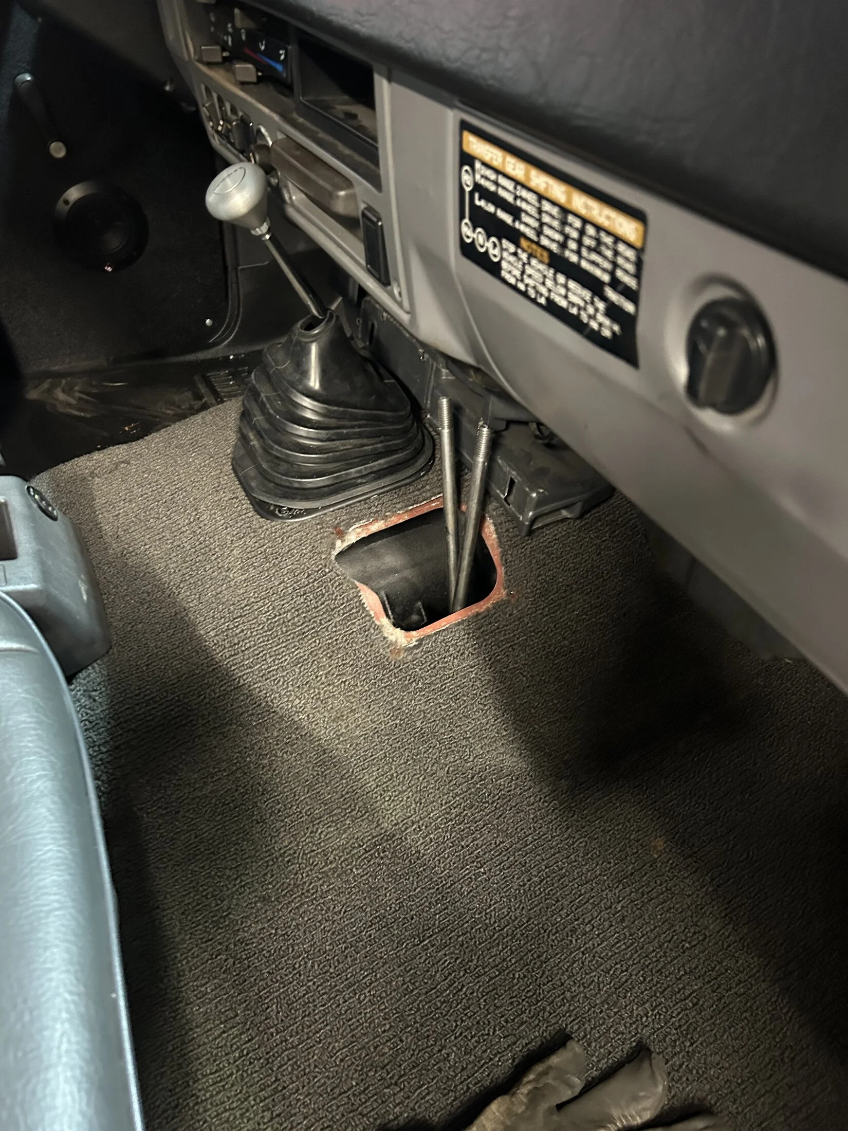

The throw for the high low lever got longer so I had to notch out about 3/4” from the top of the tunnel. First interior pick is high and 2wd. Second interior pick is in low and 4wd.
Hopefully this helps someone.
That's a good idea! I'll be doing a turbo 400 to a split case in my current project and like you I didn't see any type of mounting plate for the pivot. This looks doable.
There is a mounting plate available for the TH400. We actually have one in stock. It’s a cast aluminum housing that replaces the governor cover.
