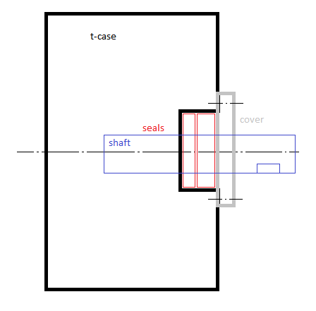

@Komanche are you using any sort of seal? It looks like you cut up a vacuum assembly and bolted that piece where the seal & boot would normally be.
No, there are two oil seals, 6mm and 7 mm thick. Inside the transfer case, there is space for it. 23 mm inside dia and around 40 outside dia, I have not the drawing anymore...
See drawing, I made for you :)
and the cover is cut part of the diaphragm cover
I thought the same thing when I looked at your pics above; where is the seal?!
Neat idea!!!!!!
