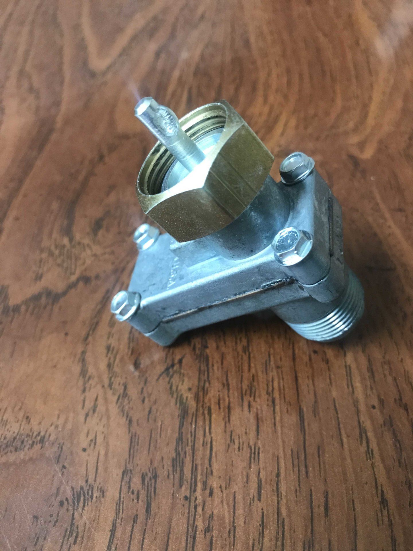

Here is the converter I used.

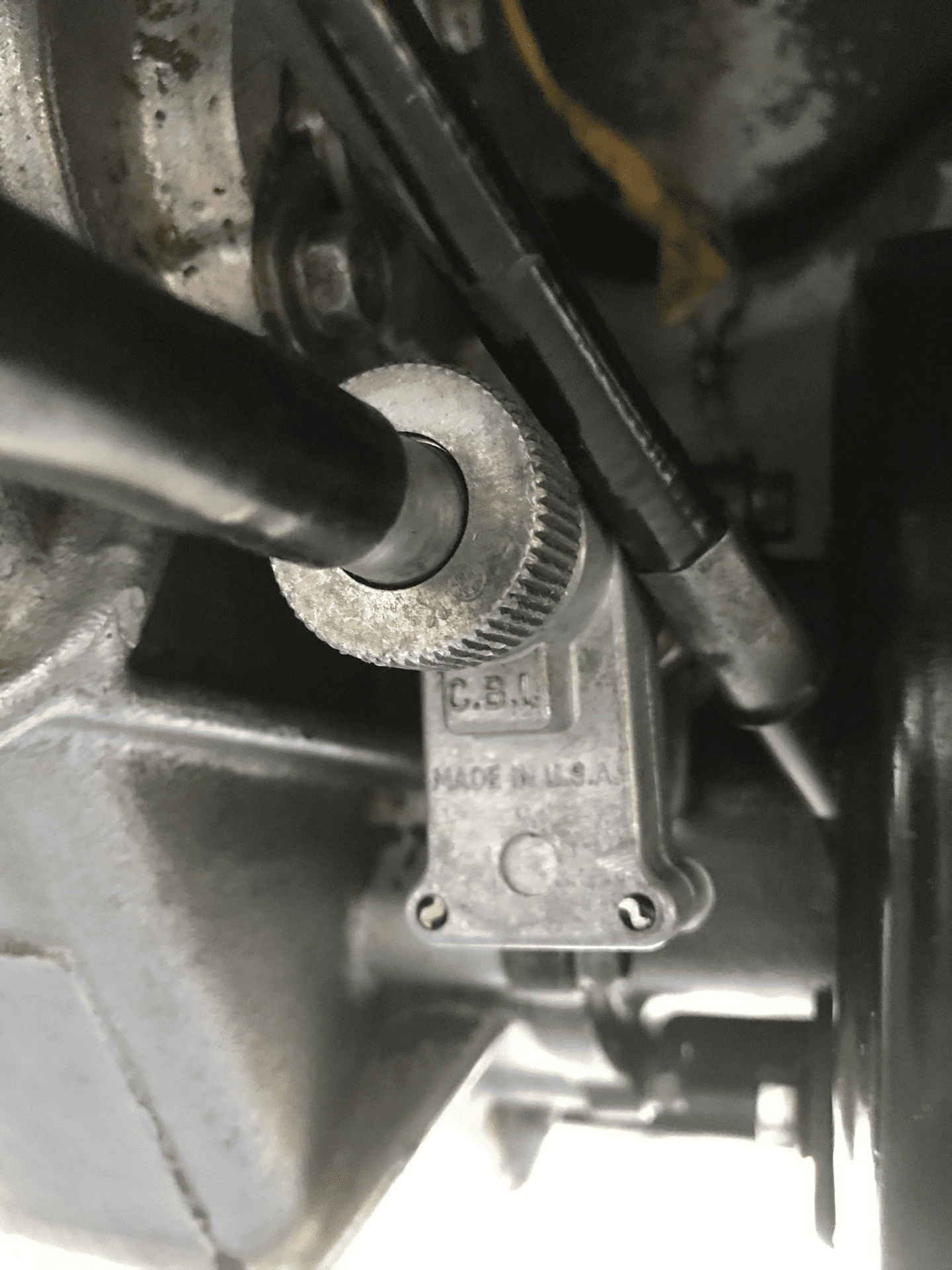

where does this mount? Does this converter screw into the speedo drive housing on the output of the transfer case or do you have to have two cables and connect it between them?
Please post a picture if you can. I contacted Abbot and they were uncertain. $125 for the converter and $50 to spice the speedo cable

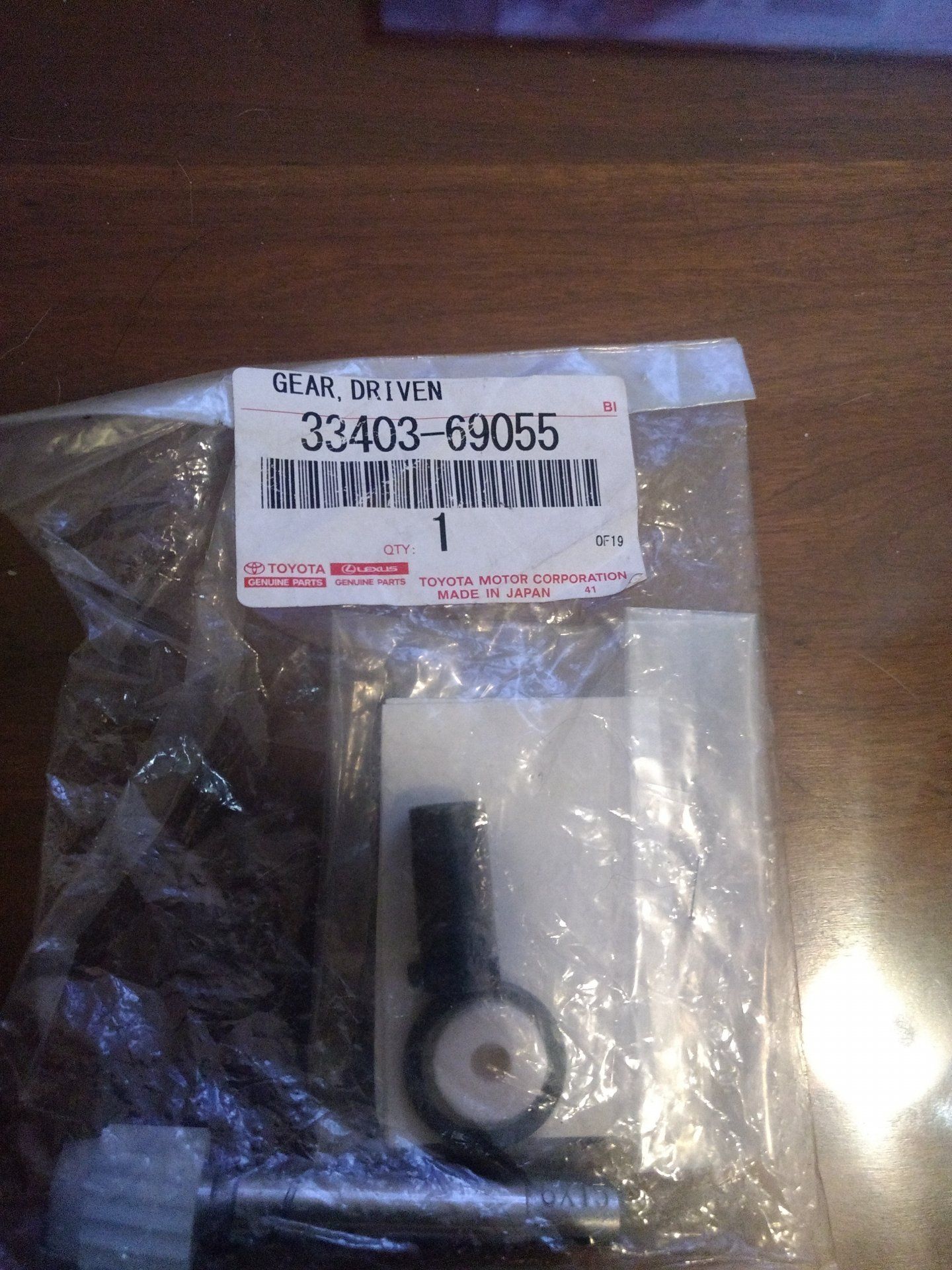

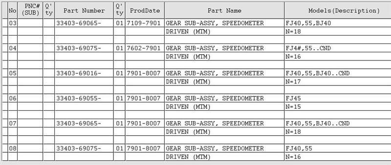

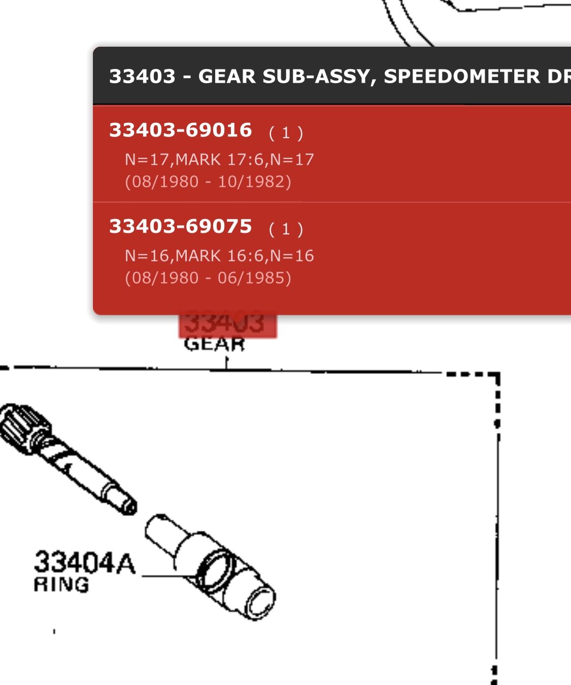

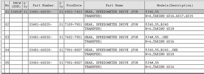

I tried to figure out what is the right speedo gear for my BJ42. Originally there was 16-teeth version. Now there is 35” tires coming, so speedo will be off about 10% (too less).
So no higher version (less teeth) seems to be available, only 17 which is worse than the original.
But I found that the gear allows 15-17 teeth, so there have to be smaller then.
Then I found this chart from page 2:
And I happened to found the right part 33403-69055. So this would give about 6% higher reading, close enough.

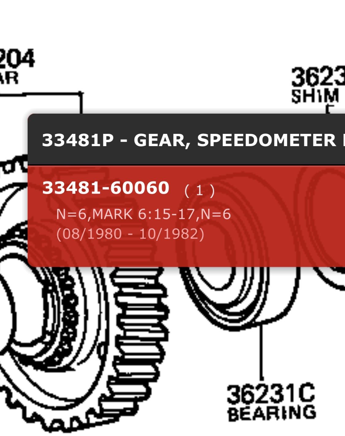

Just have to be sure you have the matching drive gear. Our FJ62 shows a different part number for drive gear. Seems to have to do with manual verses automatic transmission which seems odd since this is on the transfer case. Our FJ60 does have a the correct gear. 33481-60061 shows as a sub for 33481-60060.

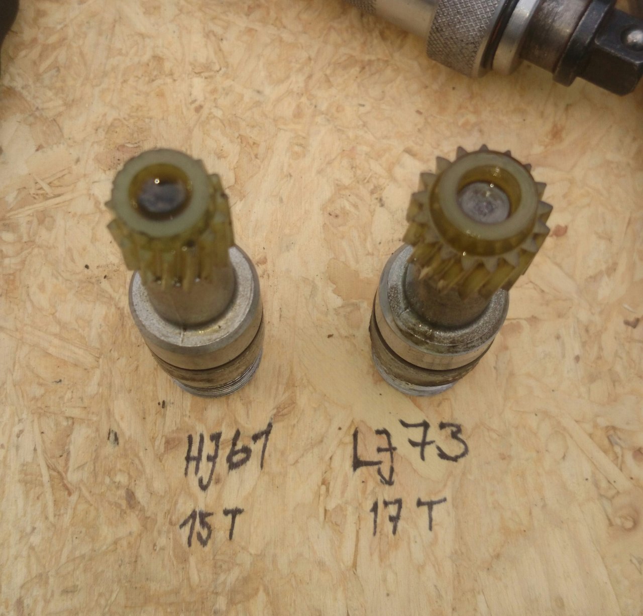

Happy updates now? I seem to remember my 15 gear is smaller OD than my 16.
Was it a direct swap?
Mine was direct swap. It works, but I have not measured the real speed with GPS (not reg.plates yet).
Here's the 15t from an early splitcase, 1981, and a 17t from a late splitcase.

I installed one of these units over the weekend (easy 5 minute job while I was waiting for my transmission oil to finish draining). My speedo is now spot on...
You can get them at SpeedometerCablesUSA.com (LINK). You'll need to do a comparison of your indicated speed on the dash to actual speed using GPS, then use the chart on the "Gearbox Adapters" page to figure out the correction factor you need.
NOTE: Actual speed / Indicated speed = correction RATIO.....NOT the % fast or slow. Pay attention to that when you're looking at the speed up / slow down correction factor. I goofed and originally ordered the wrong correction factor. They called me up after looking at my actual vs. indicated numbers and we got it squared away.
Give them a call and they'll help you figure out which configuration would work best for your rig. Had my unit in less than a week.....easy-peasy.

i put one on my 62 and agree crazy easy and spot on accuracy. no speedometer needle bounce either that i found with another type of adapter that kept breaking. i’ll be ordering another one for my 40 in the new year!
