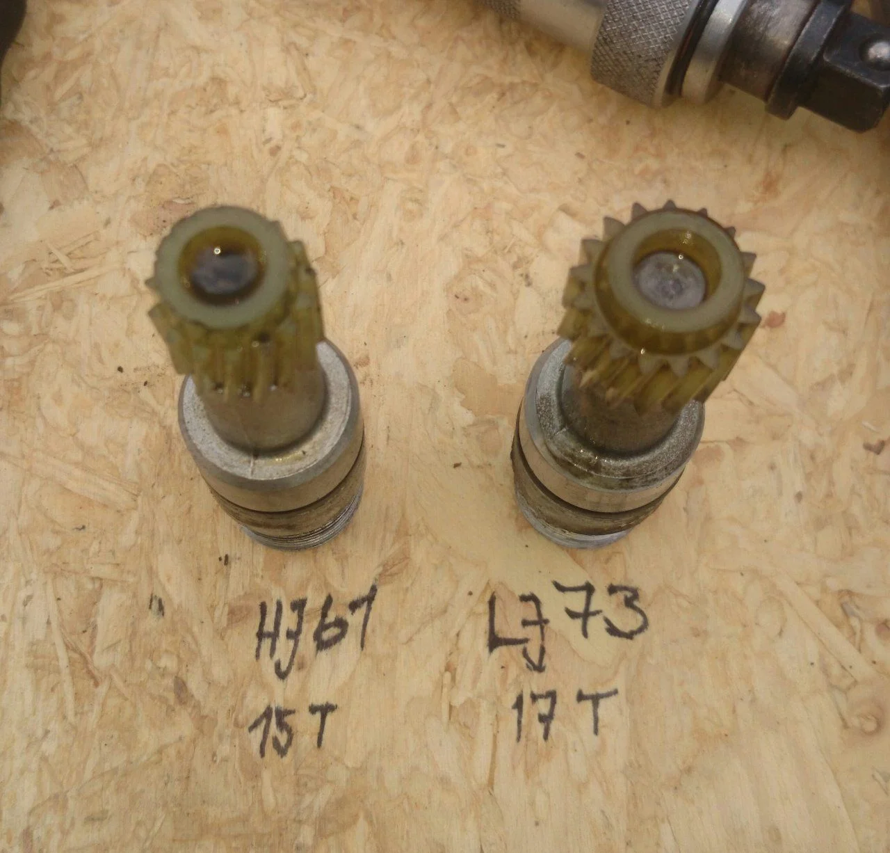

FYI ,the plastic gear counts are 15,16,17,18 , no 19 15 in a 79-80 fj45

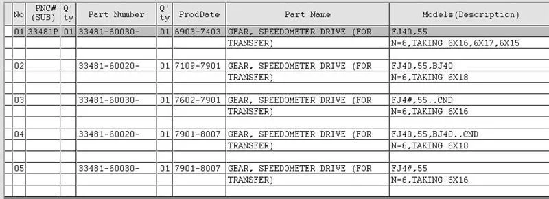

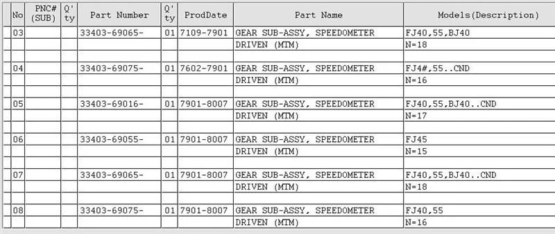

more info just to clarify what was posted earlier ,looks like there is new part #'s for the plastic gear if i am reading it right
pics show you what transfer gear will mesh with what teeth count ,other pic should be new #'s for plastic gear i think

Good tech... I'm looking for this info on a 81 and 87 split case.
Have the teeth out now, 15 on the 81' case from a 6x series with 3.7 diff and 35's. That is within the ballpark, pretty close.
Now, I have a 17 teeth gear from a 87 case, with mating drive gear.
15 and 17 is different in OD, so drive gear must mate.
I guess the speedo will be off (higher) with 17 teeth, as with the 15 I am off on the low side. 16 teeth would be perfect for 35s on 3.7 diff.
