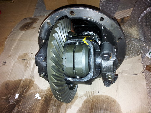

Here's a pic of the Spartan installed in my rear third.
Spartan locker
This drop in type locker is the easiest to install. You don't need to mess with the gears as it just replaces the spiders. In my 40 series, installation in the rear would just require to pop open the diff cover and partially back out the axle shafts. No need to drop out the third. Are the 80's the same? When I installed my Spartan in the front I definitely had to drop out the third, and the front is a little more involved. Anyone can do this install with basic tools. No gear master required. Learn to work on your junk and save $$$!
Oh I love my Spartan locked front btw!
