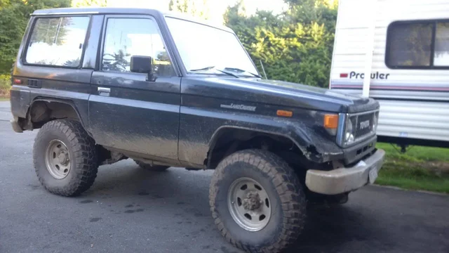

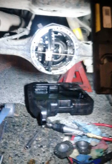

I just installed a SPARTAN locker in the rear of my BJ70, its gone from good off road to great! Highly recommend. IMG_20150922_221039.webp IMG_20150927_082304.webp
