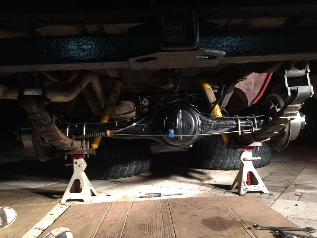

FZJ80 axle has rear disk with integrated shoes for a parking brake. The cables leave the ends of the axles and attach just like your oem ebrake.
If you do the 80 axle in the rear, you can do the (mini truck?) hubs with Tundra brakes and have better brakes and matching width.

60 series axle housing and you use Mini truck/ 4Runner hubs that get milled down to accept a slip on tundra rotor. This front axle width matches closely to the 80 rear axle after the change in width due to the different hubs.

It’s two different mods.
Stock 60 front can be upgraded with “the tundra mod” which makes it wider.
You can also do the 80 rear axle swap which makes the rear width match the “tundra mod” front width.
If you do one or the other you’ll have different width axles unless you use spacers on the unmodified axle.
I have two stock FJ62 semi-float rear axles in Los Angeles I will sell cheap if anyone wants them. Now that I have the FZJ80 rear axle I am no need for the stock one.s
