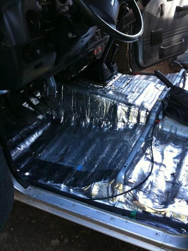

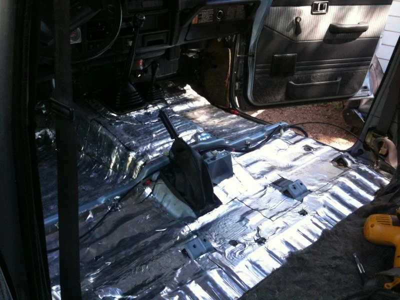

Well, while the rest of you were out wheeling this weekend I bit down with what little free time I have and installed sound proofing in my rig. Any of you that are married with young children know that free time is few and far between so I had to work fast to get it all done. I had ordered up some QuietCrap from CruiserCrap and I decided to go an extra step and replace all of my jute with sound absorbing foam from McMaster-Carr.
The PO had done a small bit of soundproofing under the front passenger seat and firewall but not much beyond that. He had installed some foil-backed insulating bubblefoam but it didn't do much for sound. I pulled it out and laid down the QC and the foam from MMC.

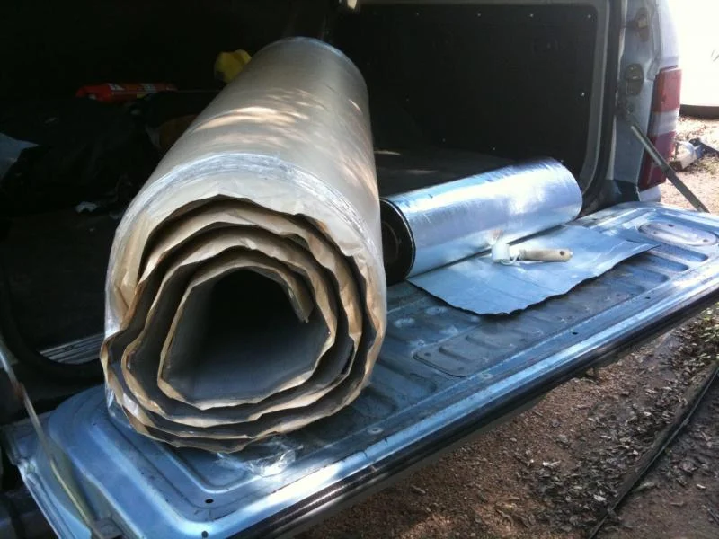

Here are the links to what I got from MMC - 10 feet of 5692T492:
McMaster-Carr
It was just over $12/foot and 10' was just enough for the floorpan and to have some left over to do the inside of firewall and the quarterpanels and possibly doors.
I went in with medium expectations. I didn't expect it to "sound like a Lexus" as some have indicated because, well, Lexus didn't make Diesel Landcruisers in the 80's.... That said - I am totally amazed at the difference. I installed the QC over the entire floorpan of the truck and the firewall (interior and enginebay) and it made a big difference.

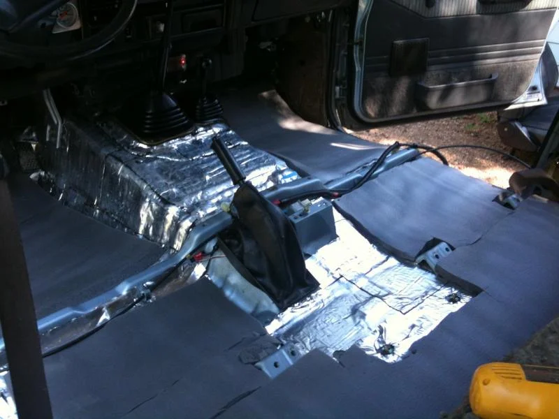

The magic happened after replacing the stock jute with the foam from MMC.... holy friggin toledo... it was amazingly quiet in there.... I really couldn't believe it. As comparison, I've owned a nice new Duramax and the other cars in our driveway are an '04 Sequoia and a BMW 325xi wagon. The cruiser is now as quiet as the Dmax was and not too far off of the bimmer or the Sequoia, especially on the highway.
Roadnoise is all but gone. Engine & Tranny noise are still there, but massively reduced. Massively. Pics attached. You can see how thick that foam is - kinda makes the carpet a little tricky to get back in but not a big deal.

If you are considering this project I can tell you it is 1000% worth it. One roll of QC was plenty for everything (including left overs for the doors and QP's) and 10' of the Skinned Polyurethane foam from MMC was plenty.

When I did the original install, I put QuietCrap everywhere I could on the floorpan of the passenger compartment (including the cargo area) to try and dampen the metal vibration. But I only laid the sound absorbing foam from McMaster-Carr (referenced above in post #1) in what I thought were critical areas only.
I had read in several sound deadening install posts (both here on Mud and elsewhere) that it wasn't necessary to get 100% coverage in order to get the job done. Well, I have since found out that in the case of my rig at least this is dead-ass wrong.
Last night I put a new carpet in and while I had everything out I figured "what the hell" and went ahead and laid the rest of the foam down everywhere I could in the passenger compartment just like the QuietCrap.... HOLY CR@P... It made a HUGE difference. The truck is a TON quieter now than it was. I think the sound absorbing foam really needs to be laid down as continuously as possible for it to do it's job, otherwise the sound "leaks" through.
