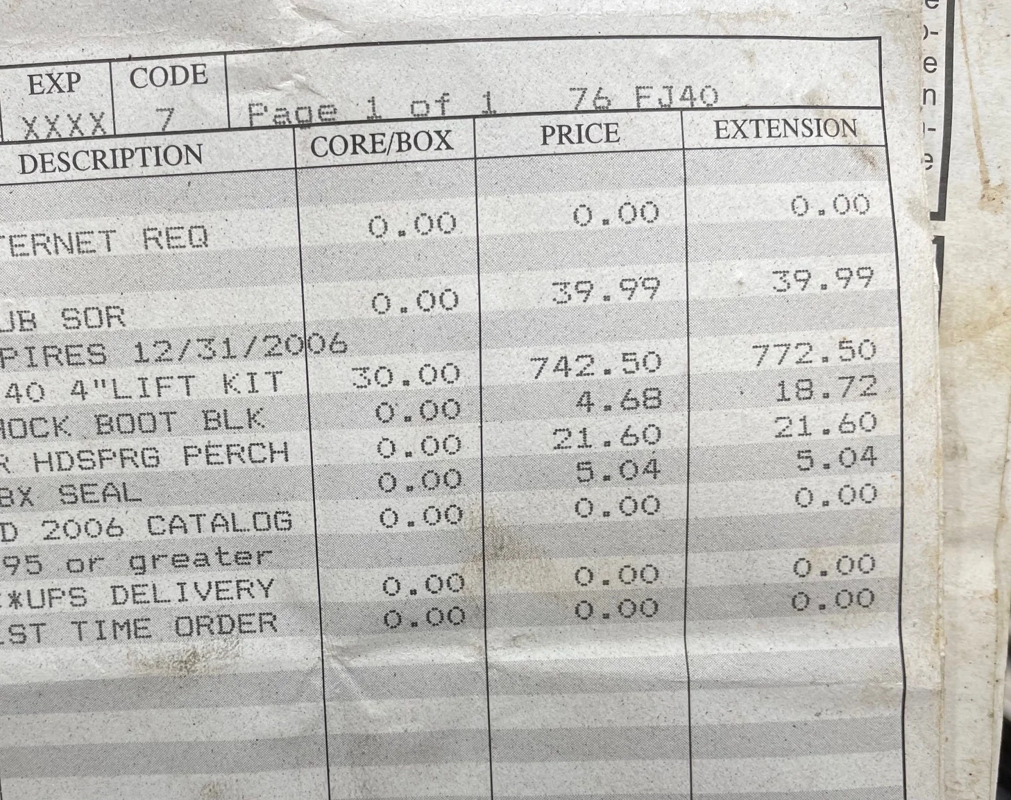

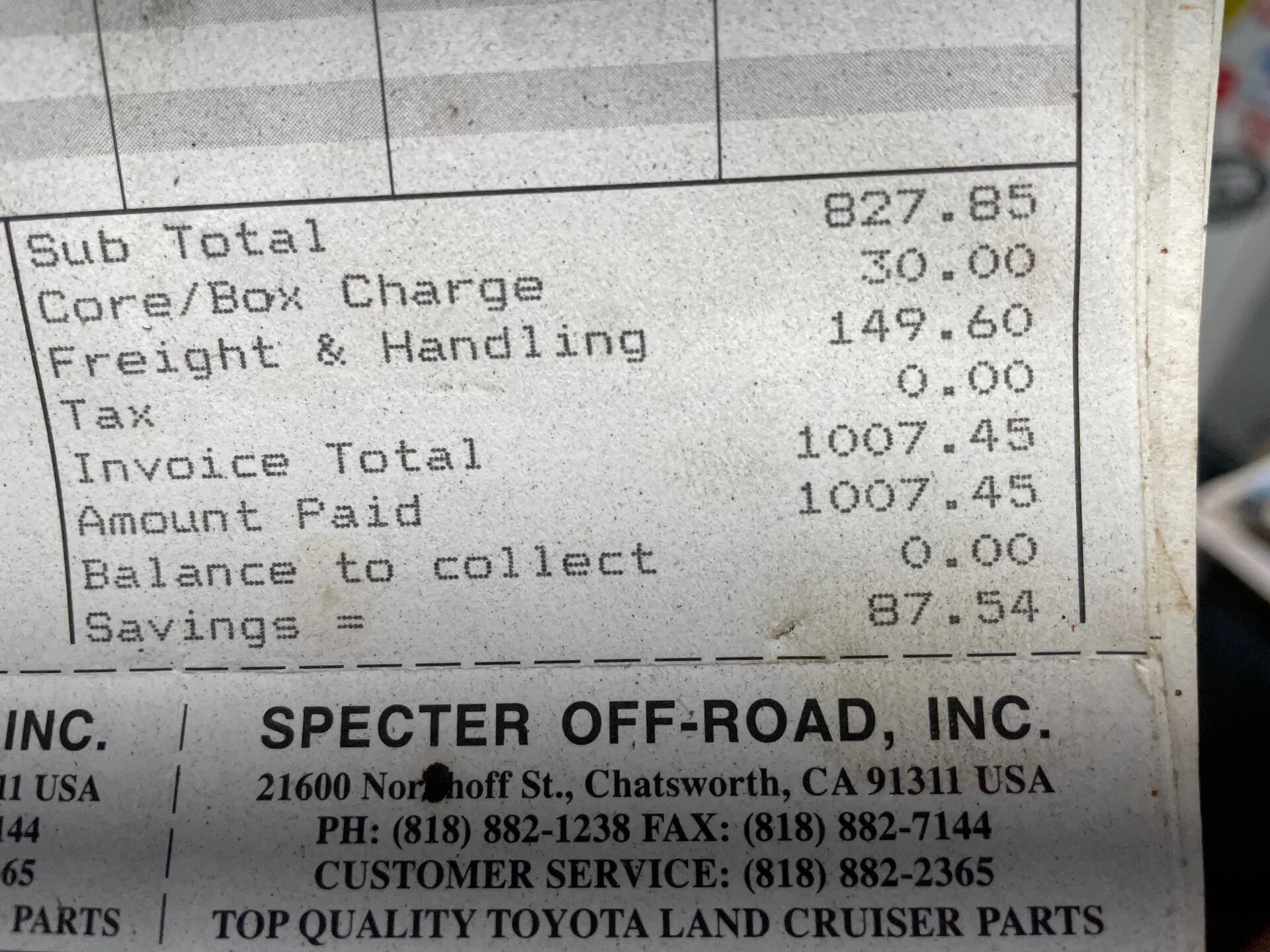

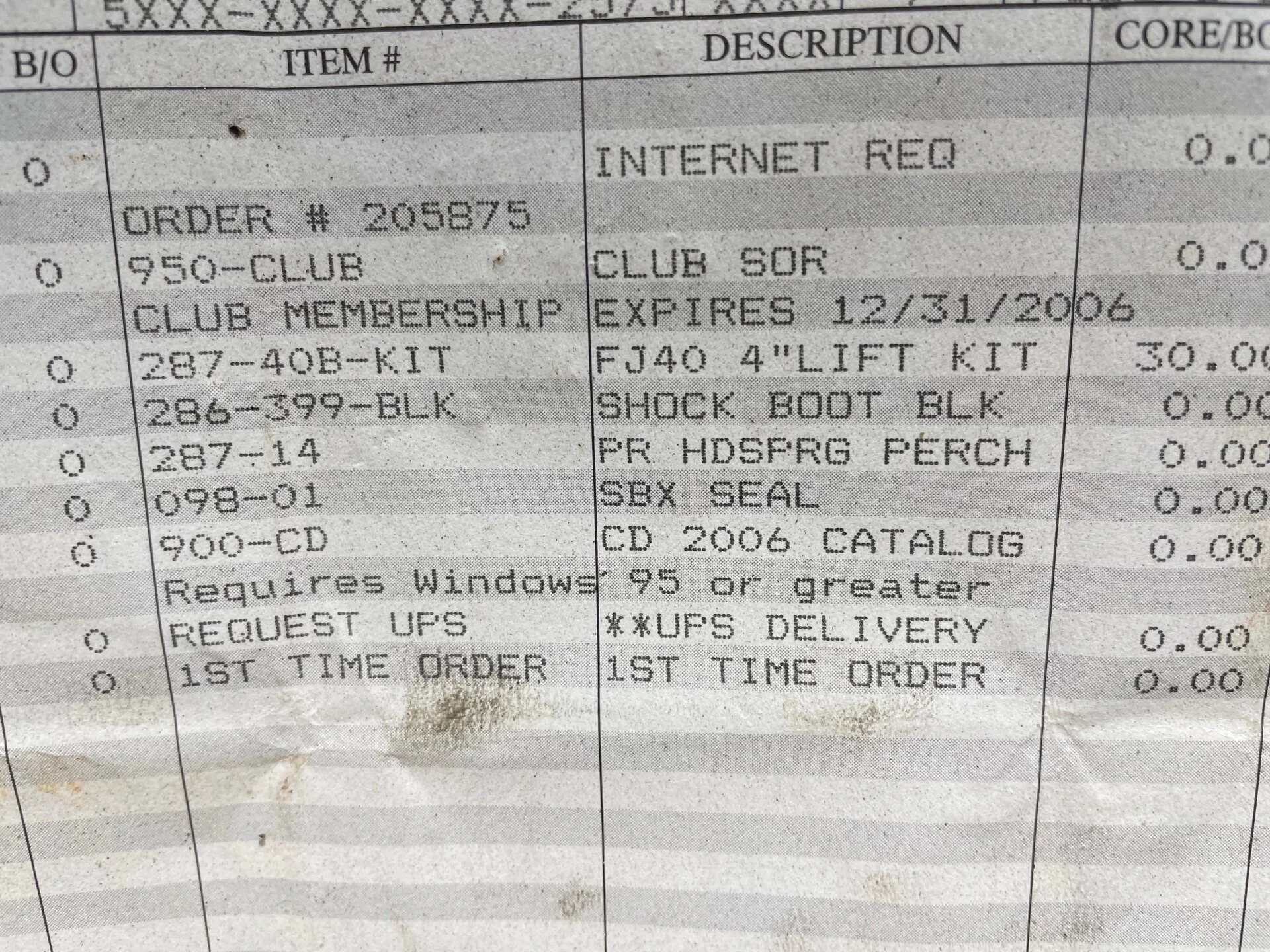

I recently acquired an abandoned project 76 FJ40, Included is a 4" Lift from Specter.......
In the paperwork was the attached invoice......wow, this was in 2006....
Anyone have experience with these?
Just wondering if it performs decent or beats ya to death..
Butch
