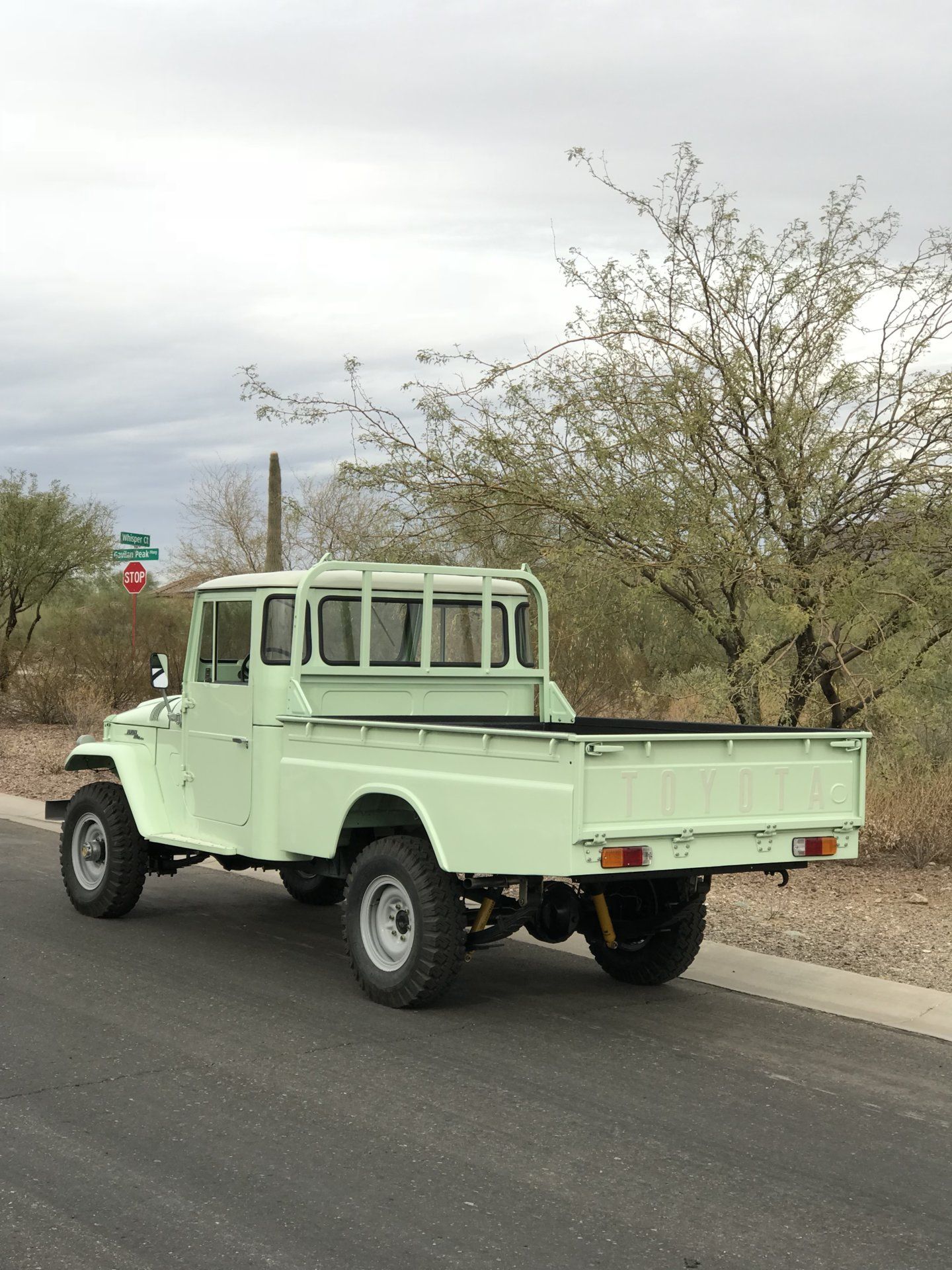

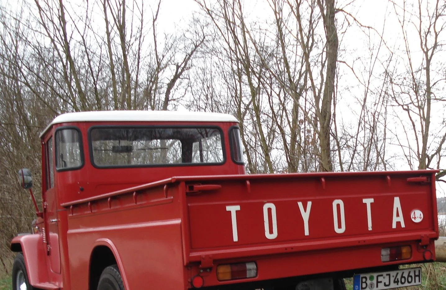

Nice 1....
.... the tail lights are 73-84 ones, right ?:)
couldn`t find the original rear lights (disconnect)for my 72 can. Wanted to store a pair.
The newer ones don´t fit without modification.

Nice 1....
.... the tail lights are 73-84 ones, right ?:)View attachment 1891356

The tailgate has four hinges so it's later. I purchased a three hinge tailage from Kevin @Awl_TEQ . When he made the valance available he made a three hinge with new style tailgate light cut outs. My bug catcher windows doors were replaced with newer ones. F135 was gone and early 2F in its place. Not worrying about being correct. This one may be titled as a 66 but bug catcher vent windows, vent in the bottom of the windshield and the 45 degree angle fresh air intake all ended in mid 65. If it doesn't have it now probably had the brass tag attached to the plaque under the hood when it was sold.

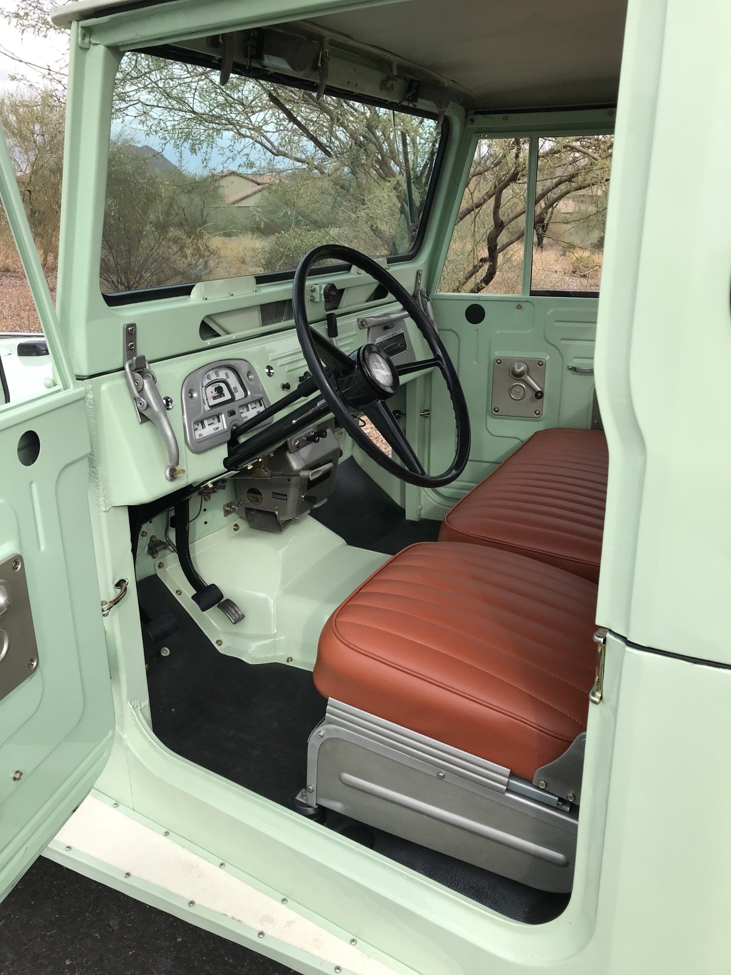

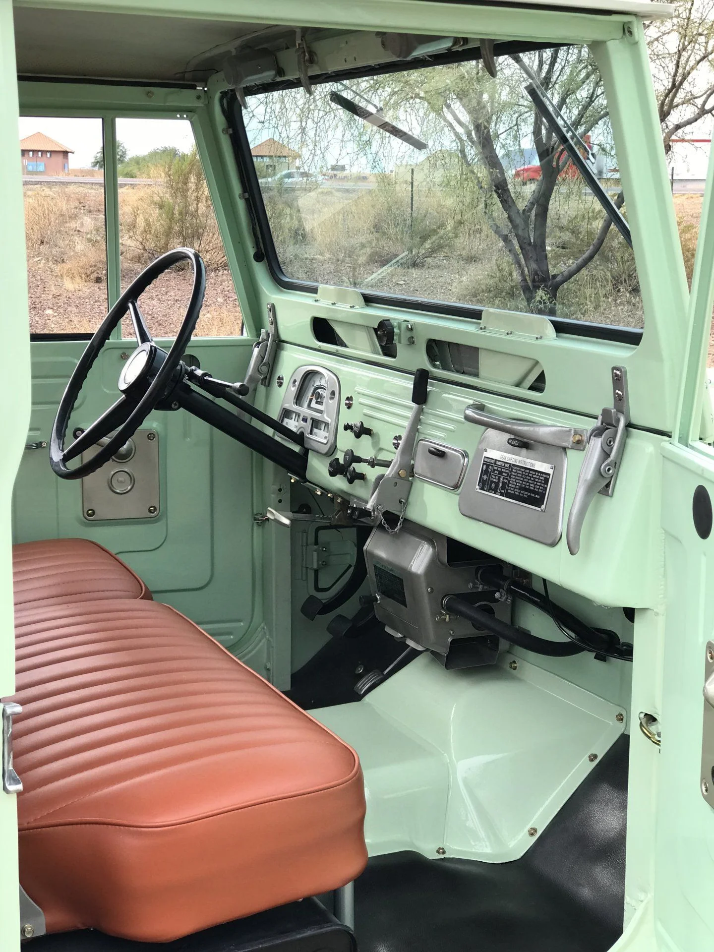

And heater ducting .
Nice rig!
You're right. the tailgate was missing from the original and I had to fabricate the hinges to fit the 4-hinge tailgate I was able to obtain. The heater ducting and rear- view mirror are now installed, and the tail lights are also from a later model. Good eyes and thanks!
