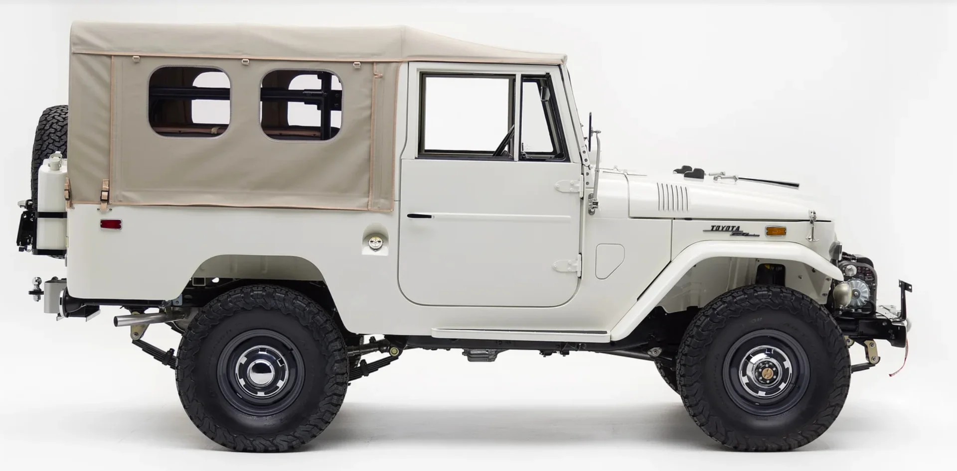

I think I want to retain my hard doors to be honest. I need to fix them up, but I do want to keep them.
The look I am going for.

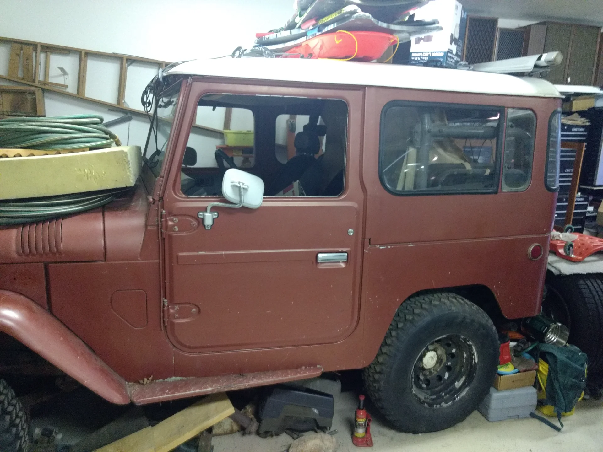

No, not 100% correct 73 hard top. Bought the 73 top in 1976. I flipped my 68 on it's side in fall 1975 Lake Tahoe. This was Thanksgiving weekend moving back to AZ. Not real easy to tell but back window opening is just plastic taped on.
I added vent windows, posts and weatherstripping off a 78 wrecked mid 1980s. Large glass was broken on both sides. At that time I bought both new windows from Toyota for $35.
77 model (8/76) is when vent windows started in some markets. The side sliding windows do not work with the factory roll bar so US only got the pop out vent window. At that time the radius on side bars on the roll bar was shorter to clear the latch on the vent windows.
