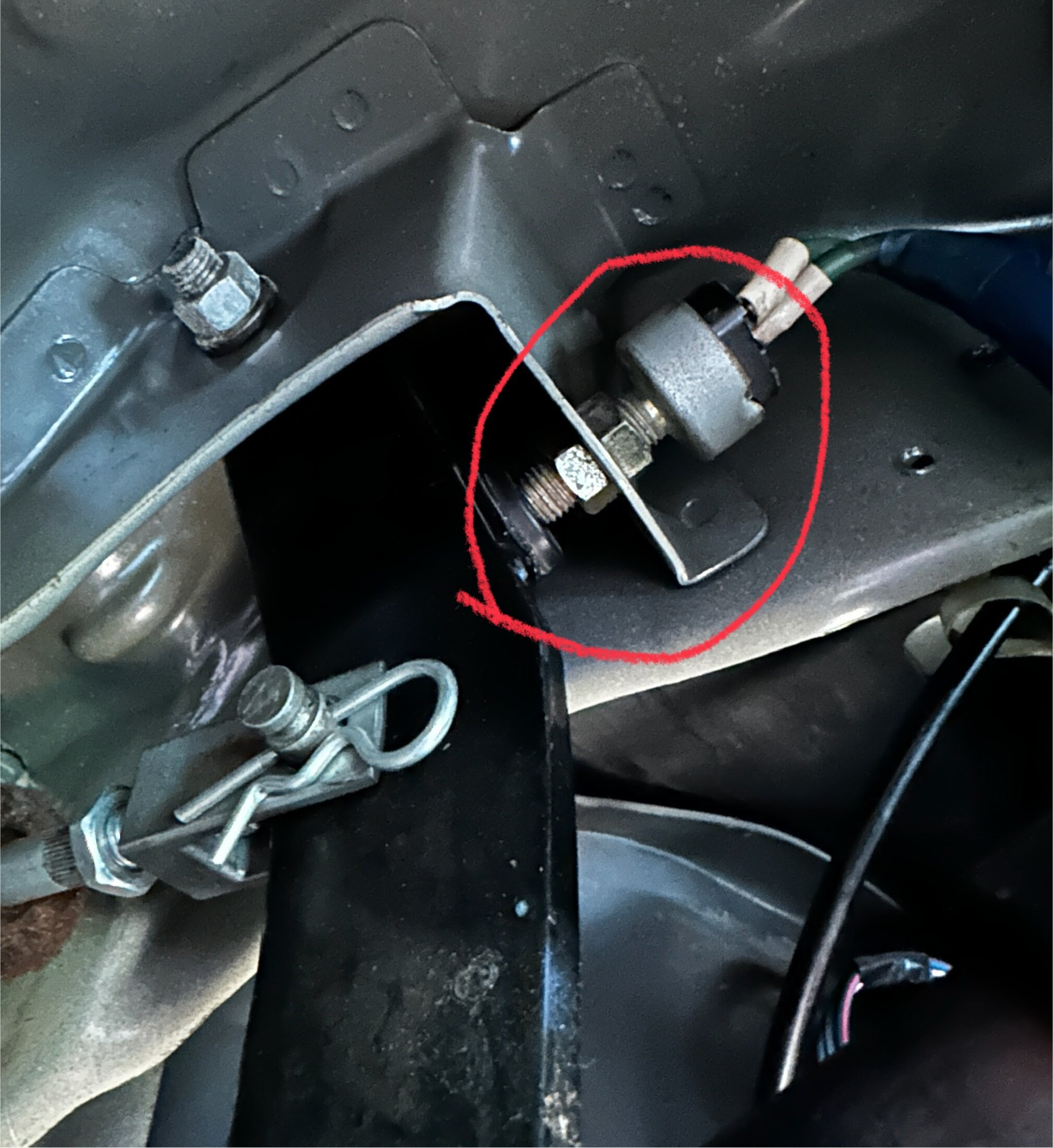

One thing worth mentioning is to check your brake light switch while you are doing the pedal adjustments. Some of us have had issues where the switch has been adjusted too far down and interferes with the brake pedal return, causing the booster and subsequently the master cylinder to not retract fully.

The only other adjustment near the brake pedal will be your brake light switch as shown circled in my picture below. If this is set too low, it will restrict the return of the pedal/booster. if set too high, your rear brake lights will be on all the time.
I adjusted that when I set the pedal height.
