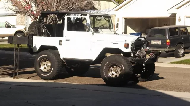

Question: Is the Spare mounted on the stock carrier? Can it handle the weight over time?
Thanks for the kind words everyone.....Yes the stock tire carrier is used in the previous pictures above,However here is the updated picture of the New tire carrier from manafre ( Dave G. AKA LCWIZARD).....the stock carrier hungout about 5 inches on the rt. side and was a little to low for my taste.

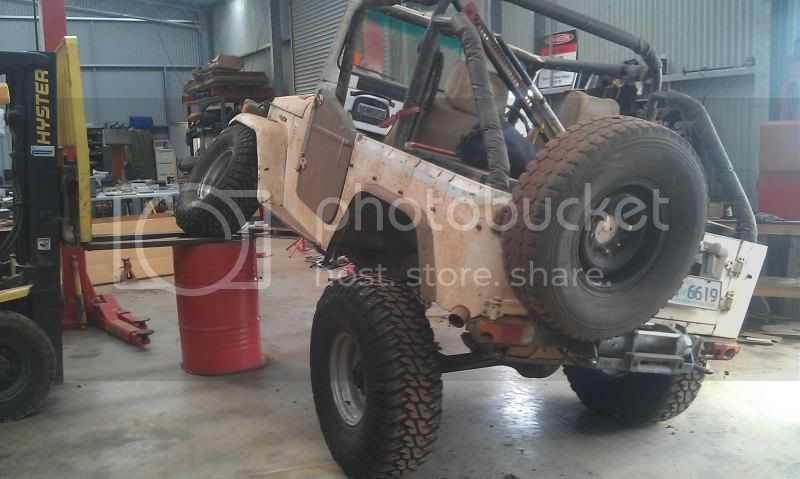

Right hand drive with 37x14.5 on 15x12. On going project.

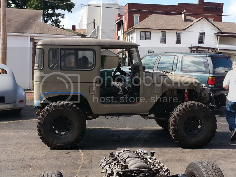

Stock FJ60 (HJ60) springs front and rear with the rear shackle hanger flipped to accommodate the extra length. I removed a couple leaves from the front and rear to soften the ride and level it out. There are still plenty of leaves in the pack.
It rides like a dream... seriously, it rides better over RR tracks and bumps better than my '07 Tundra. The wheel base is extended to about 94". the front bumps forward and inch or 2 and the back about the same.

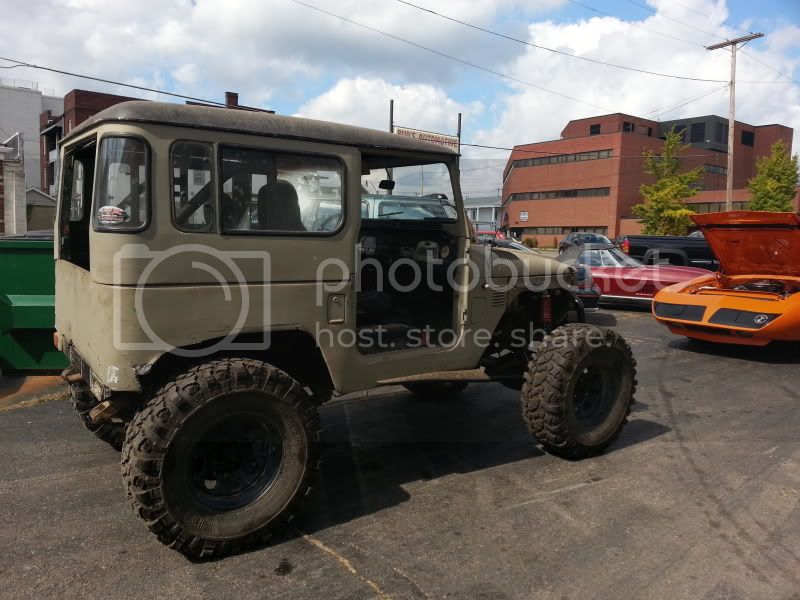

1972 FJ40 on 37x12.50 MT
Bought this as a parts car because the PO rolled it. It was a nice setup besides the fact that the steering was not done right (the reason he rolled) Sorry I don't have any better pics but you get the idea. Thanks for your service!

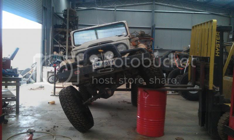

35's 70 series axle's and springs
