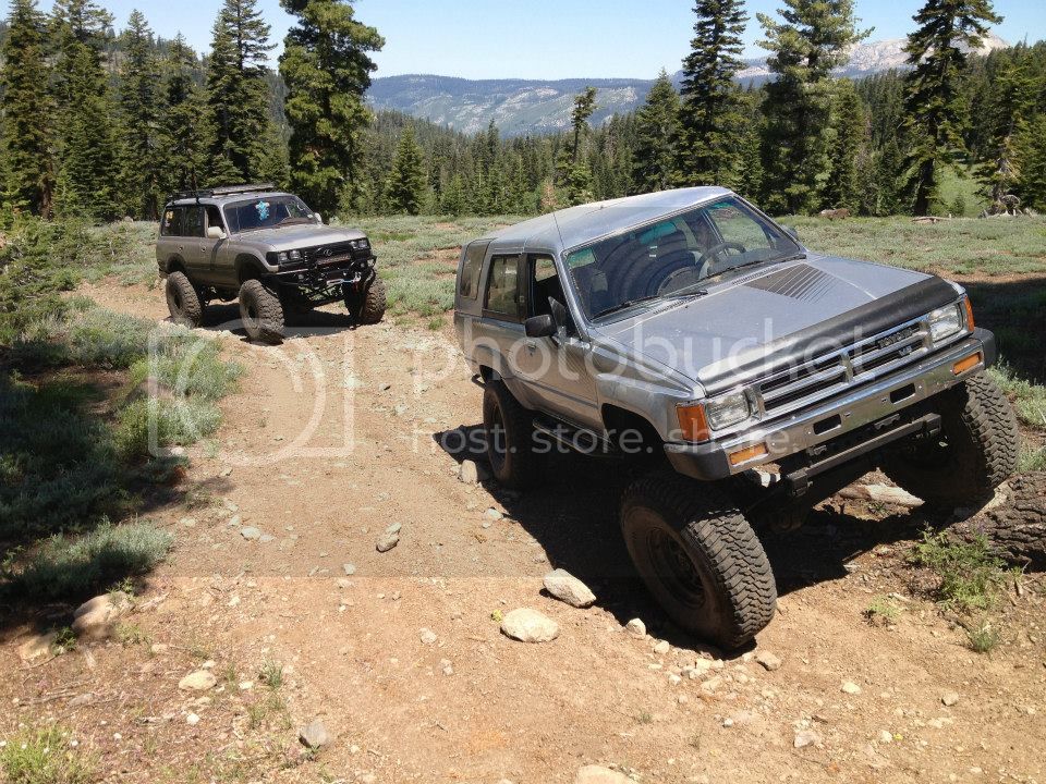

For good measure, here's a picture of my rig with the LX450:
