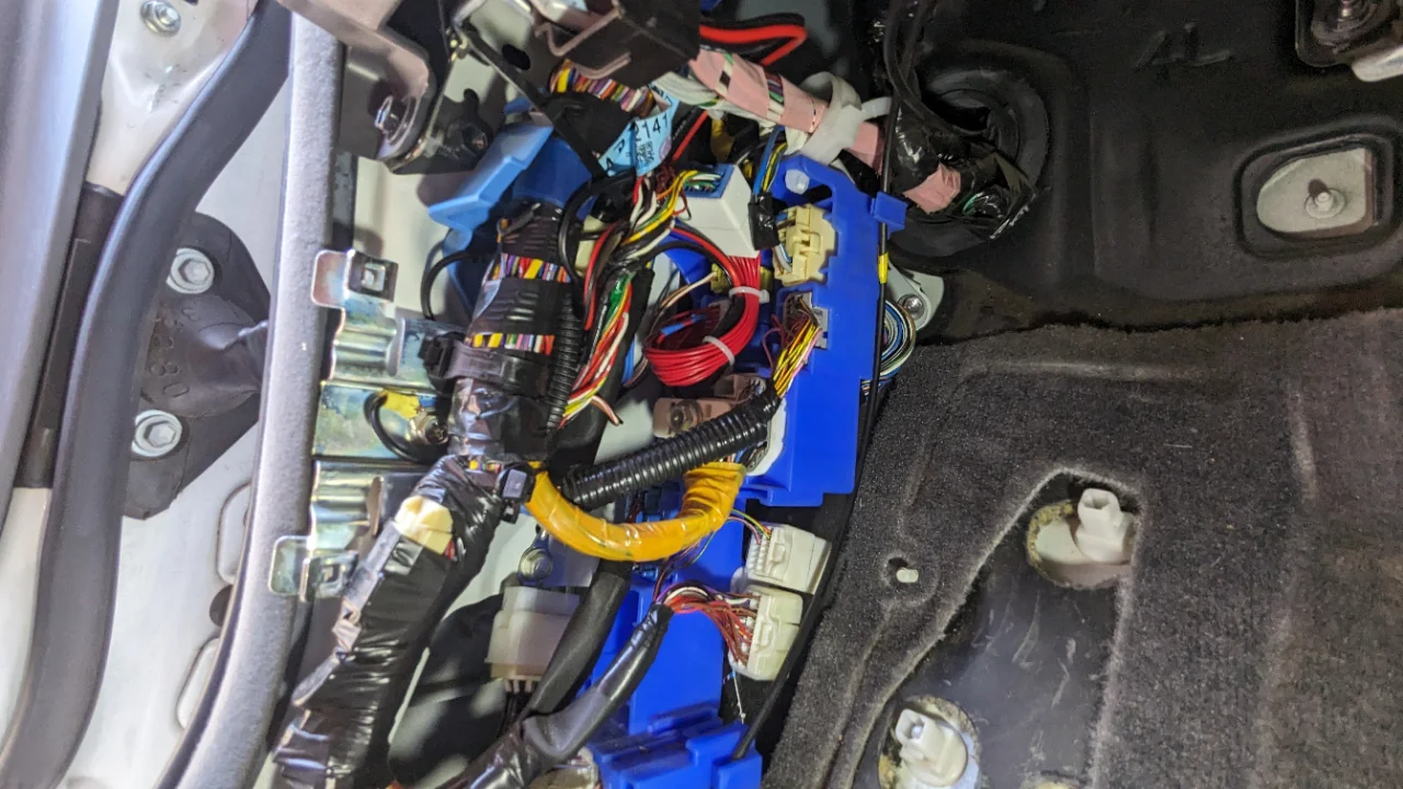

Based on this the "Center Diff Lock ECU" is actually in the 4WD ECU under the glovebox. The wires go there. I will hunt and see if I can find the J20
I got it! For an 03/04 you just splice into the Green White wire on the 4WD ECU on the back of the lower glove box panel. The wire is on the bottom left, look for violet wire, then a blank to the right, then the target green/white wire. Splice in to a switch and if you short it...VSC shuts off and on with no other errors. It does seem to think the CDL is locking when you start it up like that...but click click and it is fine. Considering I know exactly when I want no VSC, this works for me. I put the switch in the glovebox. Now I have to go out and drive it with the various states and see what it does.

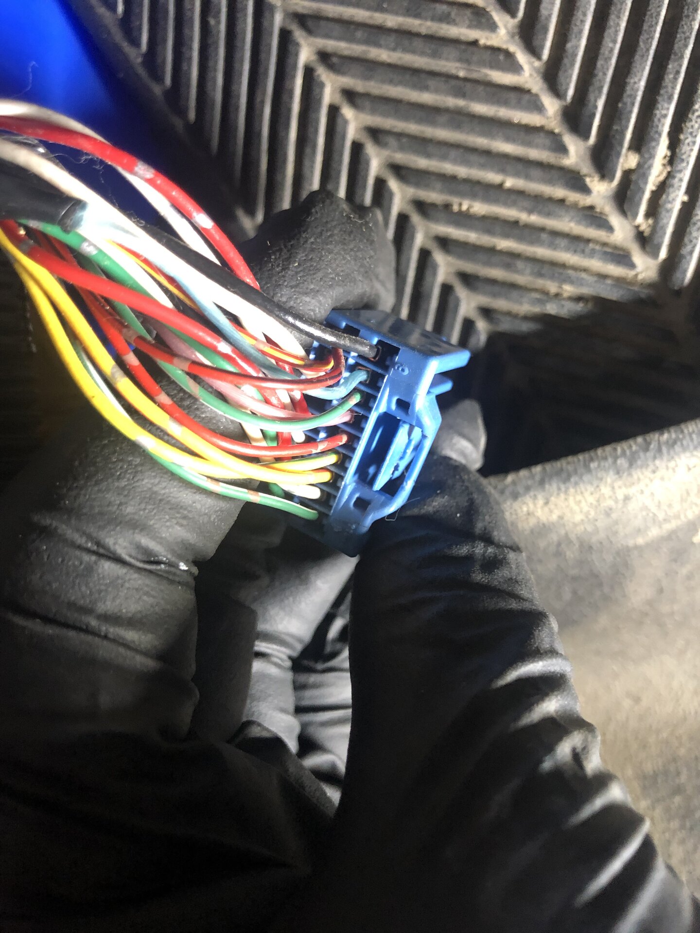

Double check the connector is the correct one then double check the connector number is correct. Which part of the connector you are looking at dictates the correct numbering pattern. Said another way, if you looked at both ends next to each other the pin numbering would be opposite. Another thing you can do is pull the pin you think is the correct one and see if that turns everything off, see what I wrote above about that. Without an EWD for you 2007 I cannot say for sure.

I know it is a pain but pulling the pin from the connector and testing is a way to confirm.

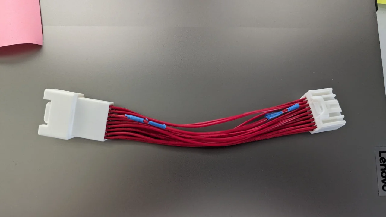

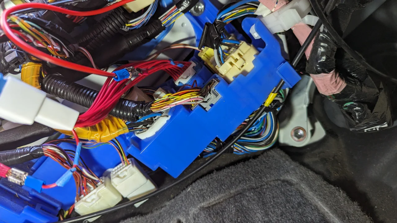

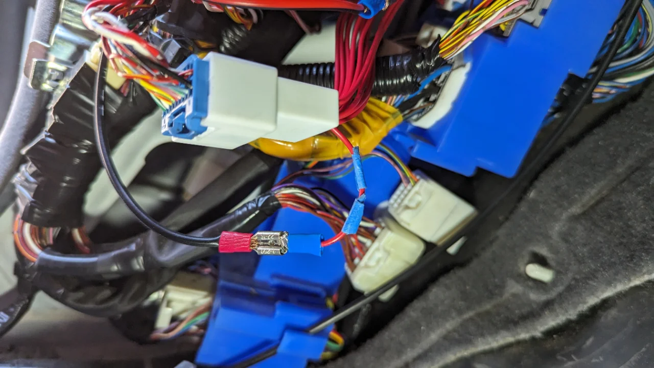

very cool modification. I too was frustrated with the engine limiting output and not let me rock the car, spin the tires in some snow. Being a little shy about cutting into my factory harness, i was able to find the 18 pin plug part number then found male and female plugs (with or without wires) on aliexpress. The vendor even made me an extension harness. So I spliced into that! Seems to work just as you all describe. dont worry, i taped up all connections you see before tucking it away.
here's how it was listed 1 Set 18P 7282-5833 7283-5833 90980-11912 Car Automatic Wiper Switch Wiring Terminal Socket For Auto Toyota Crown
vendor: Cargry Store
