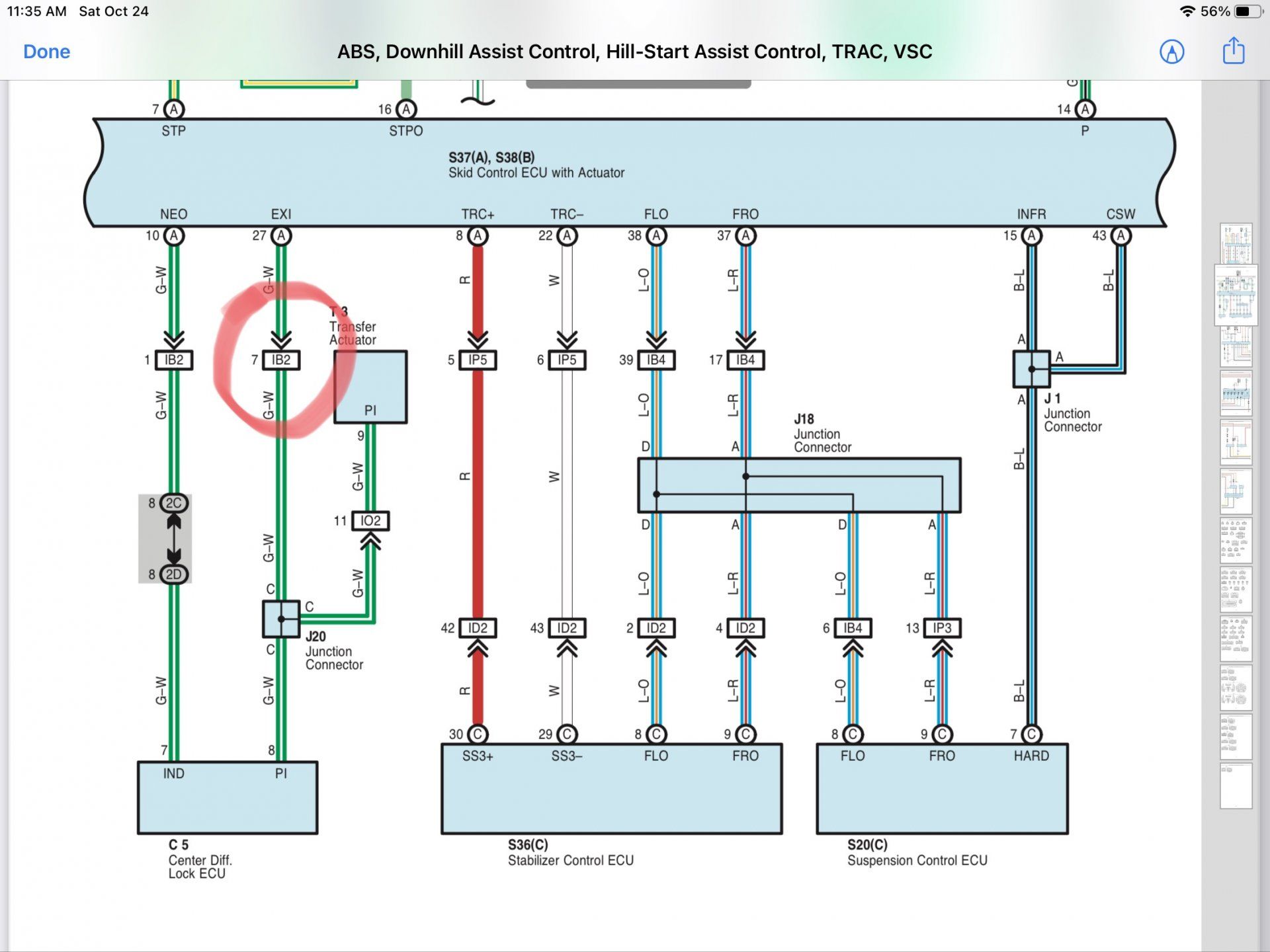

IO3 pin 16 looks like where the ground signal goes into the Skid ECU from the 4Lo signal, see page 45. I’ll look more into it tomorrow, but it looks like you are missing the blue connector path and the ground goes by way of the J20 junction connector. It looks like you want beak the G-W wire connection between J20 and Skid ECU to be consistent with how I did the mod.

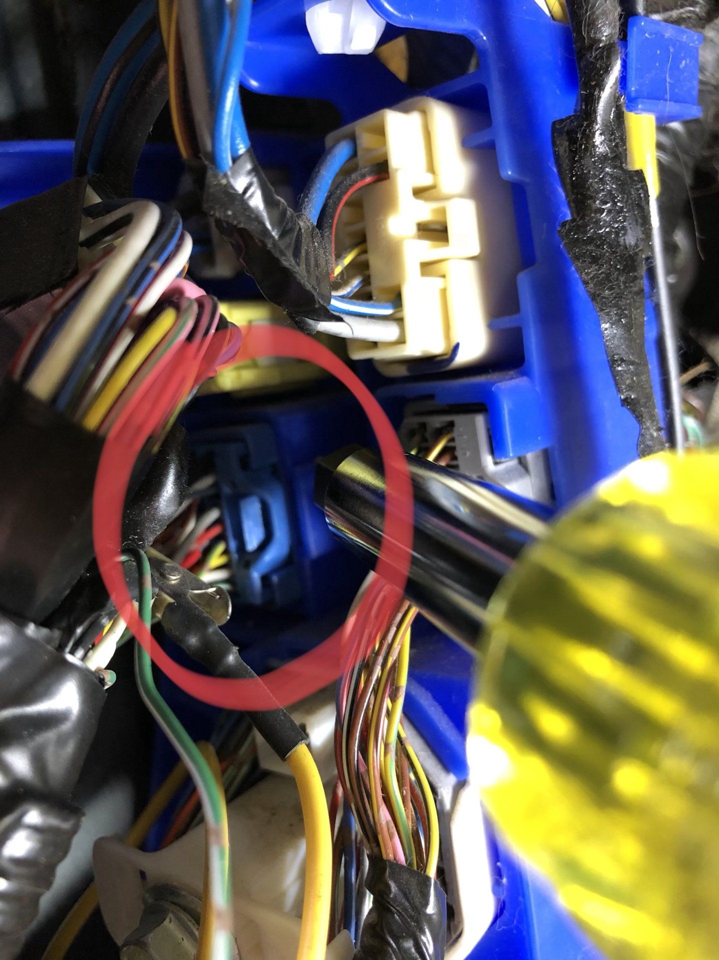

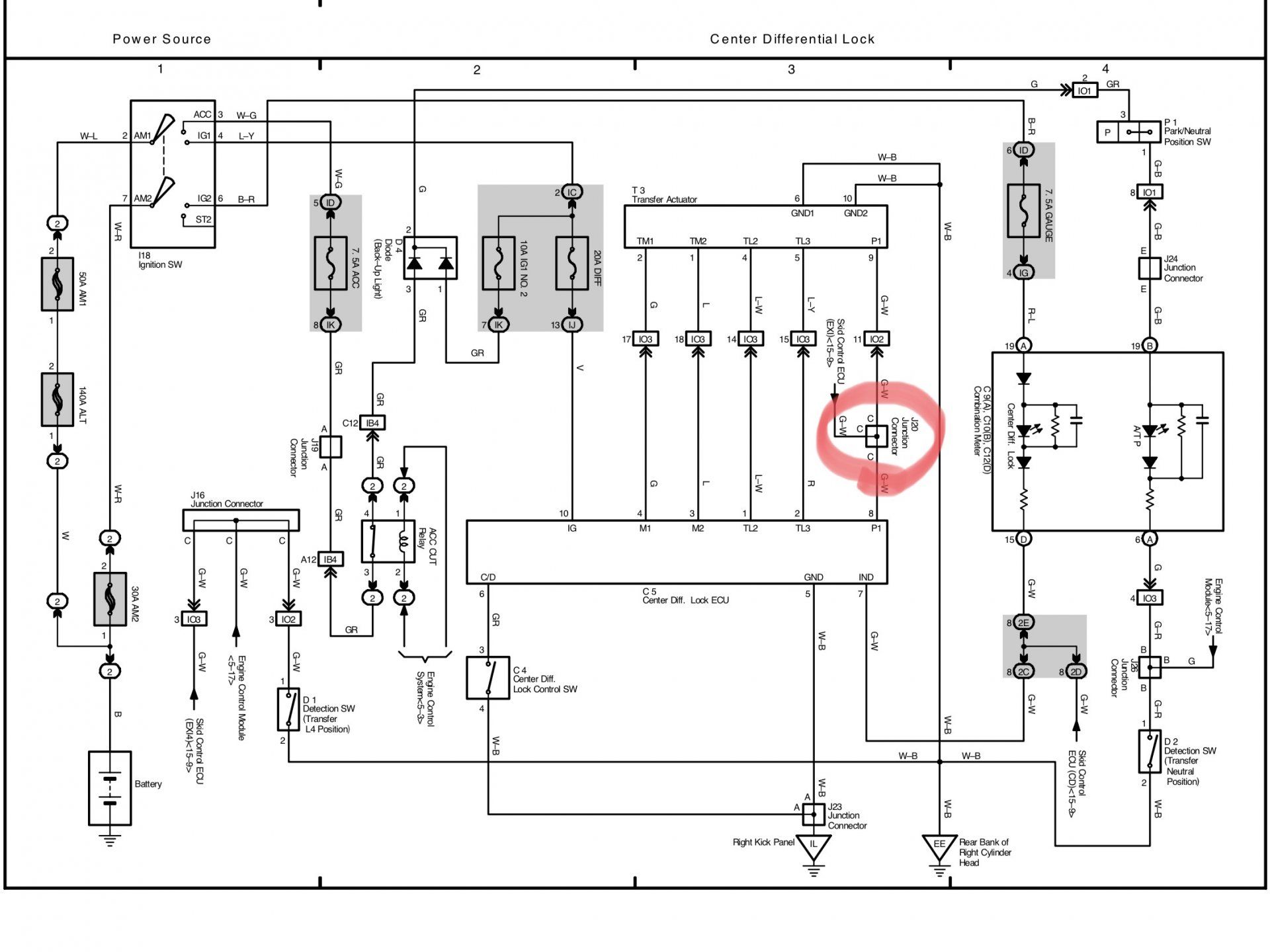

Below are a couple of pics. The first is mine showing the blue IB2 connector. You can see the CDL ECU wire is labeled PI and goes to the Skid control ECU marked EXI. The second and third are from your EWD.
On yours below you can see the CDL ECU wire marked PI. Note: <15-9> corresponds to page number and section to continue tracing.
Below you can see the same wire connected to the Skid ECU marked EXI. Note <18-3> corresponds to page number and section to continue tracing.
If it were me, I would insert the switch between J20 and the Skid ECU. You can test by grounding with a probe first.
