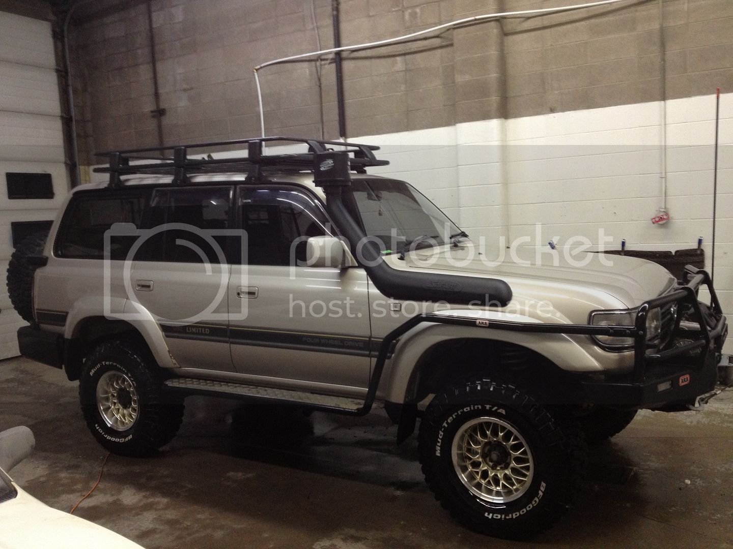

I finished up the TMS snorkel install last night. Overall pretty smooth. The supplied template wasn't quite accurate. The two holes closest to the windshield were not in the correct place but that was about all I needed to change. After drilling the holes, I removed the fender to make it easier to tighten all the bolts and remove the factory intake plumbing. The quality of the snorkel is really quite good, in fact excellent considering the price. For a $40 Snorkel it is great. Comparing it to the Safari snorkels I've used in the past, the obvious difference is the lack of the embossed Safari logo on the main body. Fitment is and construction is good although it may not be quite as precise where the snorkel follows the contours of the fender at the front, but I'm getting quite nit-picky. Material seems to be the same plastics. Time will tell if this one has problems with UV exposure and fading or cracking, but I doubt it. So with the exception of needing to do some double-checking of measurements I'm very please with the purchase.
The snorkel really compliments the new hod scoop! So where did you get the scoop, is it a Lund by chance?

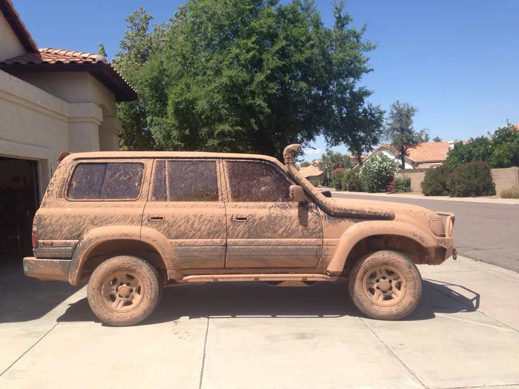

OK, snorkel showed up on my doorstep today, as did the mushroom hat topper for it. BTW, the topper was shipped from Malaysia on June 2nd, its June 4th !!!!!! Anyhow, my initial impression of this snorkel is that it does not feel cheap. In fact it feels like a pretty quality unit. I'm going to set it in the parts bin limbo for now until the rest of the bodywork is done.
