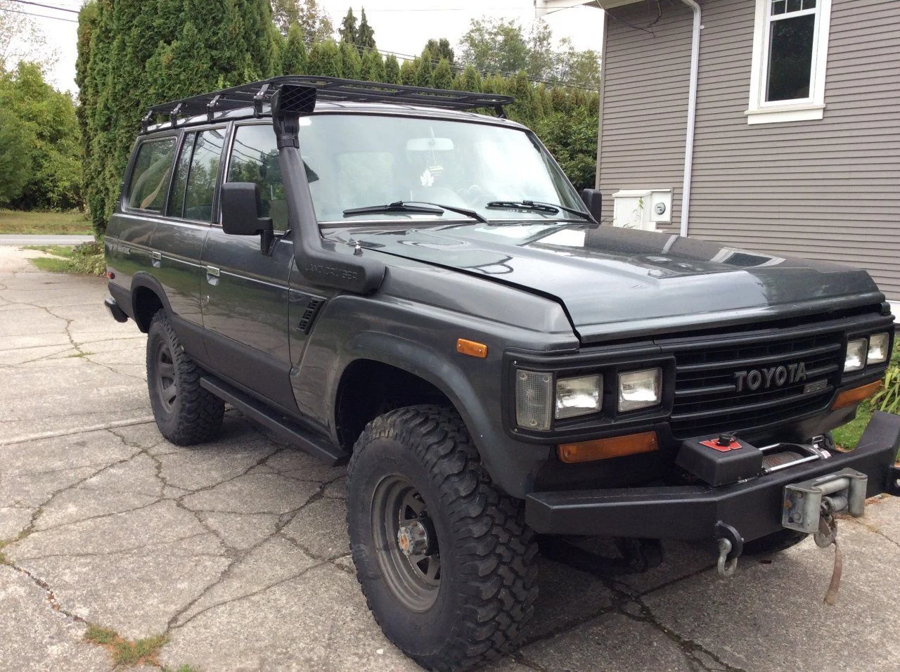

Just put my chinese snorkel in my 60 and well... The stencil was 4 inches out and l had to reform the pillar support for it to work. Would do it again...yup. Would I buy from the exact same vendor...nope. Would I buy a fender if I botched it...yup. Is this topic worth 8 pages of bickering... Nope. Did I add to the bickering...yup. Do I care...nope...

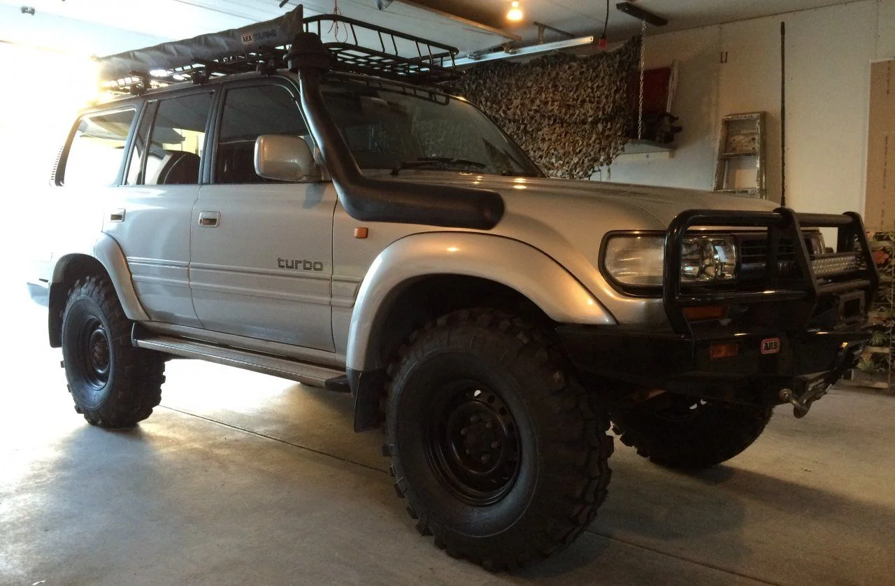

Chinese snorkel, almost 3 years old, not faded... run in winter and summer, all year. Awesome stuff for the price...
I'd do it again no prob...
That, sir, is a nice rig!
