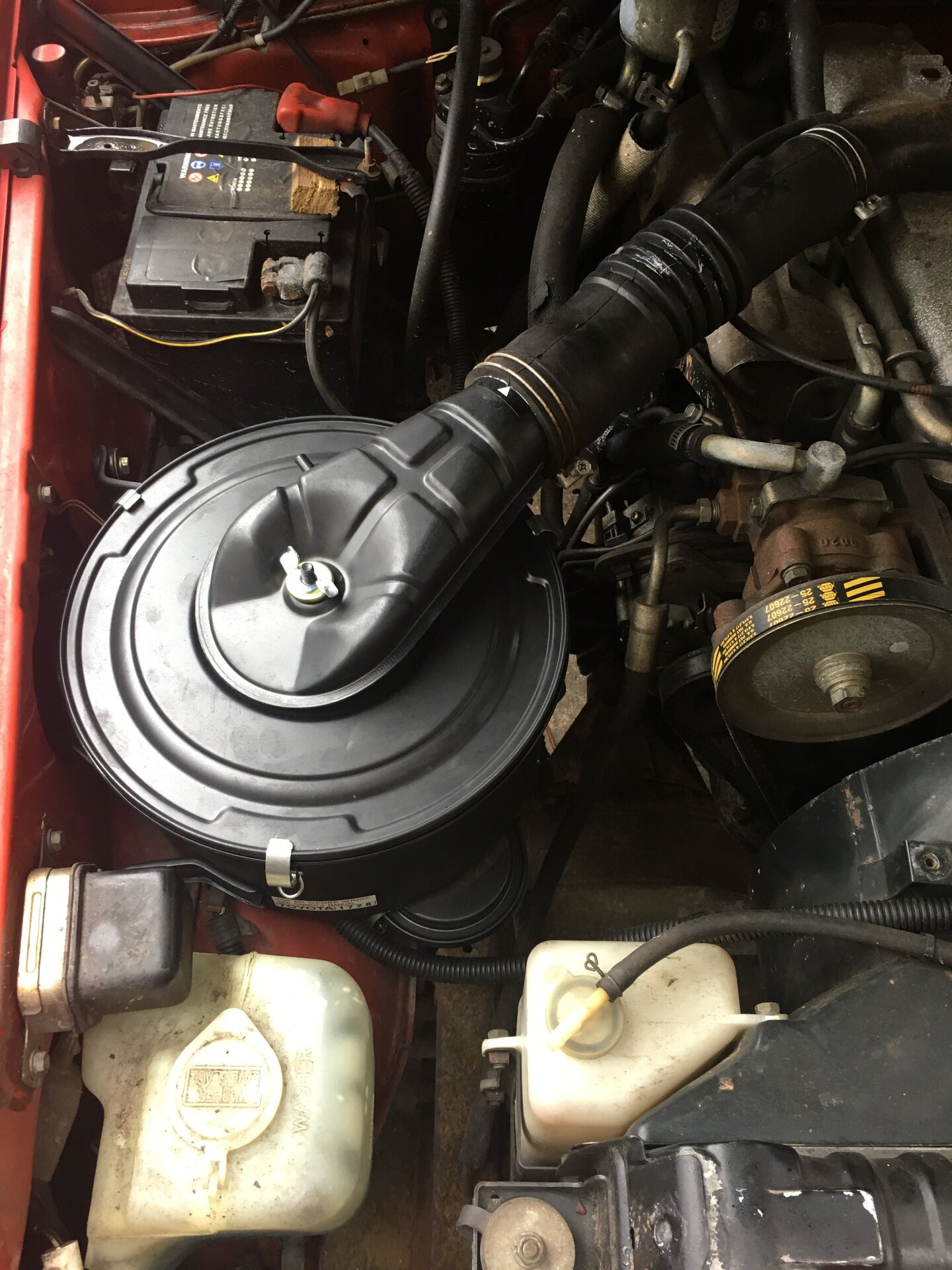

I’ve got all the needed part numbers. Your air filter box is going to need modified.

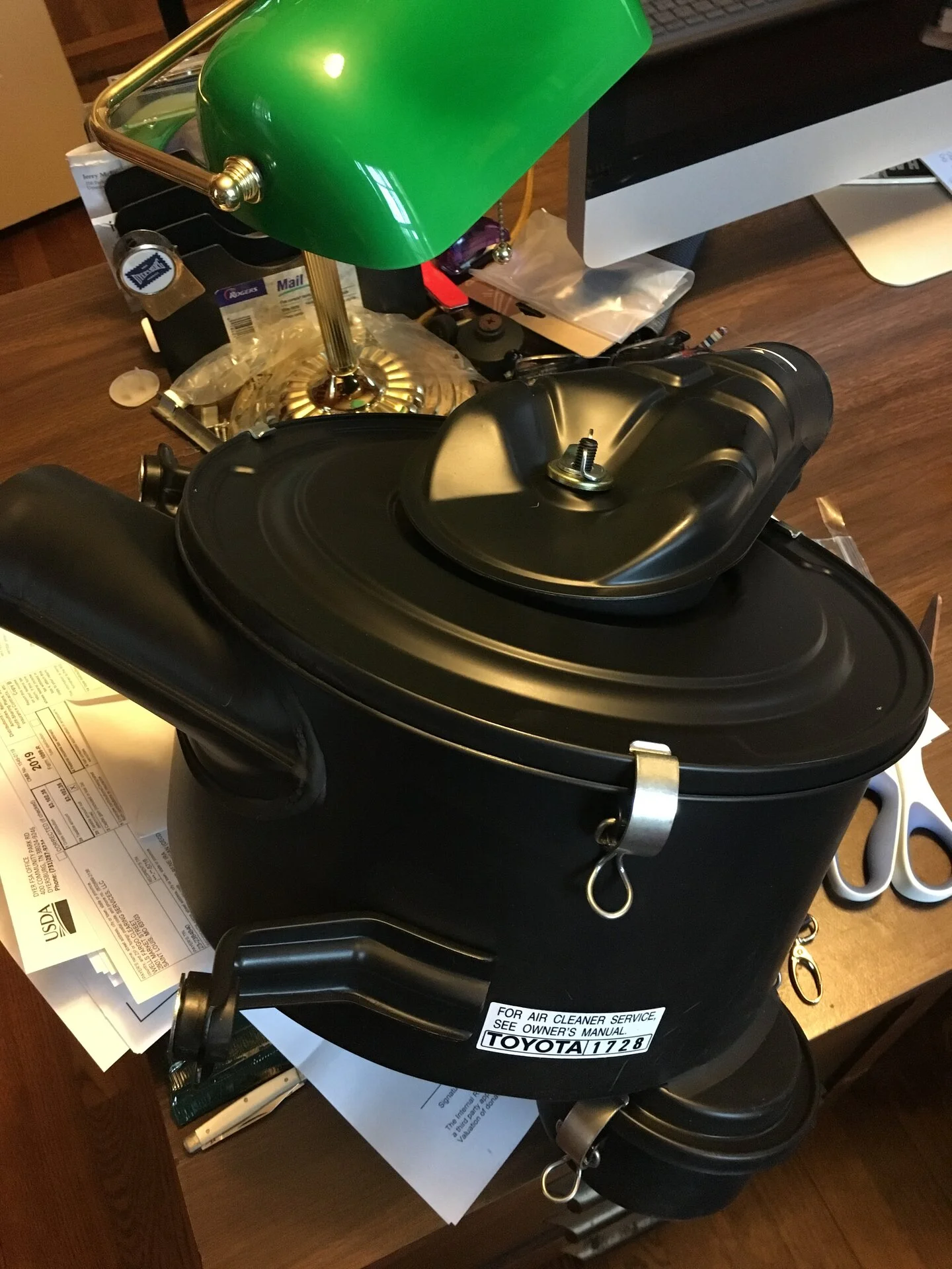

Correct me if I am wrong and it may be NLA but can you get an OEM air can bottom for snorkel equipped 70 series? Would also require a different washer reservoir as well. I believe that is how the FJ73 I had was set up.

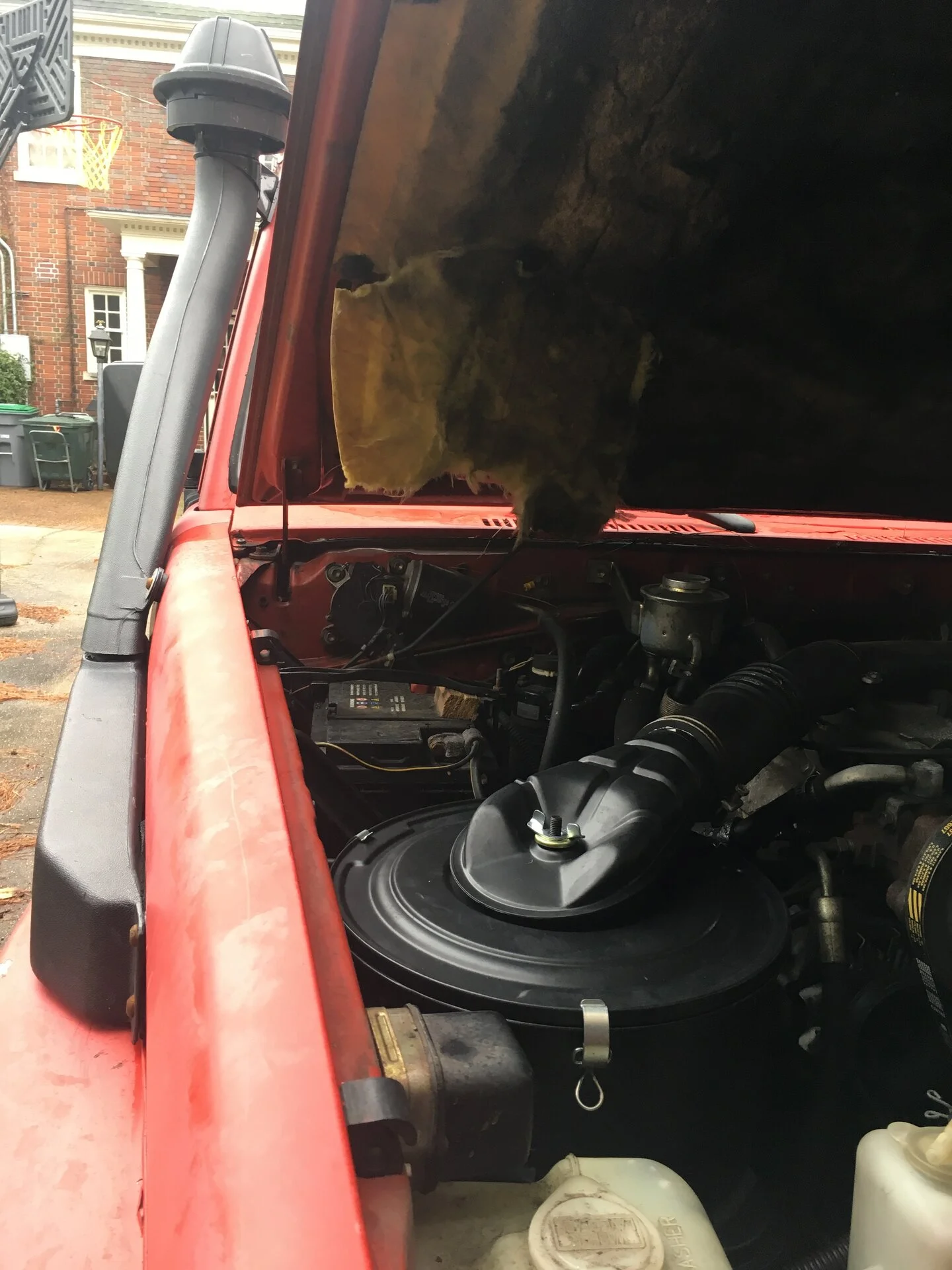

that said, a non-snorkel sir can be modified to suit an oem snorkel. It’s a fairly simple process. In the theory one could do it with a drill and jb weld.

There are OEM air cleaner bottoms available for snorkel equipped 70-series... but they are the wide nose version bodies and don't fit directly into our older ones. The OEM snorkel equipped air cleaner bottoms are NLA for the narrow noses. This is, at least, what I turned up in my researching. Like @divemedic, I just modified my existing housing.

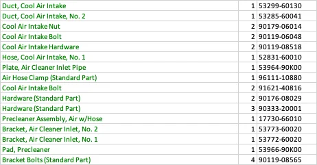

OEM snorkel parts for the narrow nose 70-series trucks... note the Toyota parts system calls it a cool air intake.
Columns are Part Name, Quantity, OEM Part Number

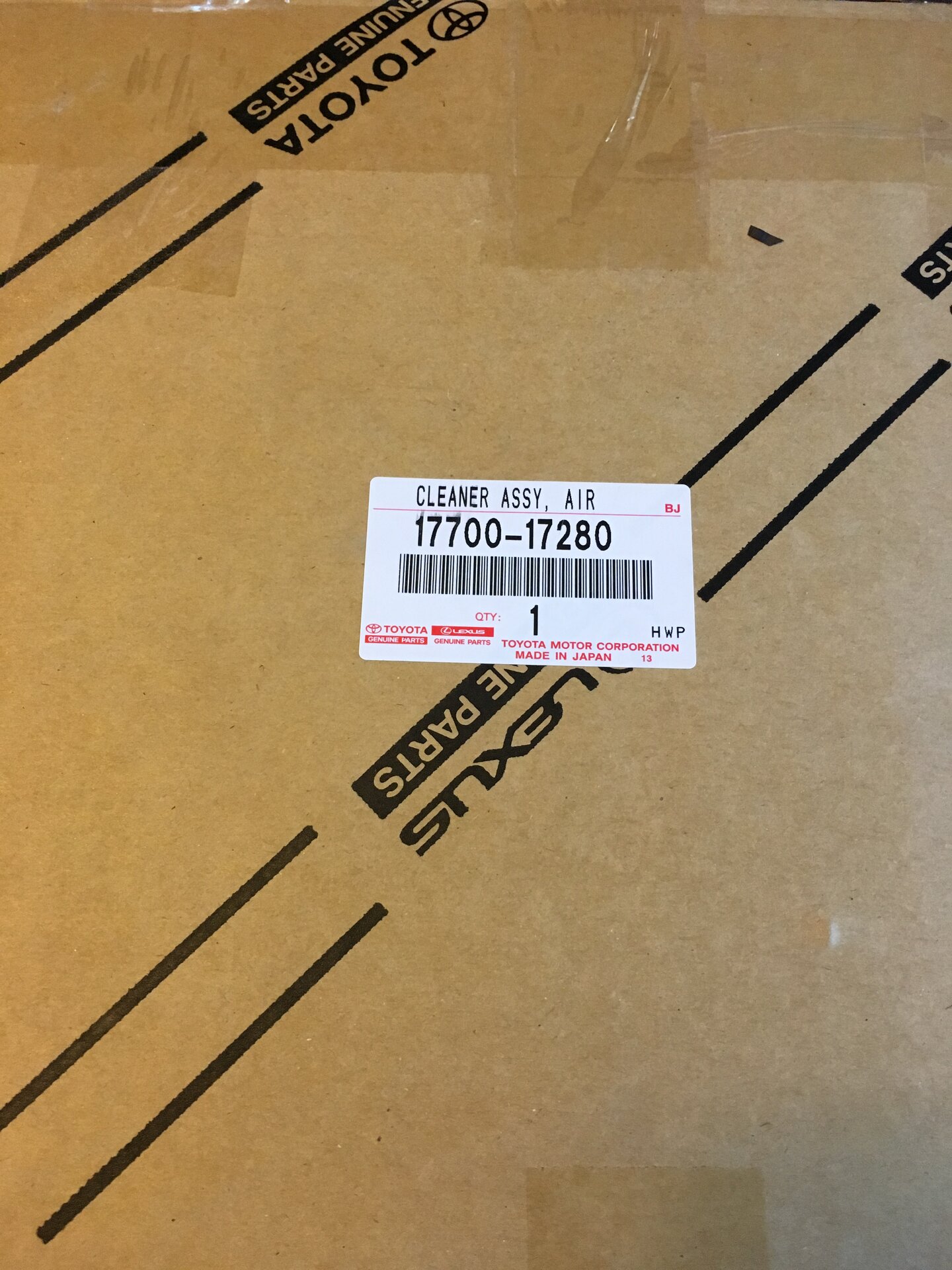

Reviving this old thread. I ordered all the parts, but does anyone have the part # for the snorkel version of the air cleaner box? This would be for the narrow nose 70. HZJ77 to be exact.
Hello,
Part number for a post-1999 model is 17700-66201.
Chances are the part for your model year, 17700-66051, is discontinued.

Super helpful. Looks like I need to go aftermarket or modify my current box.
