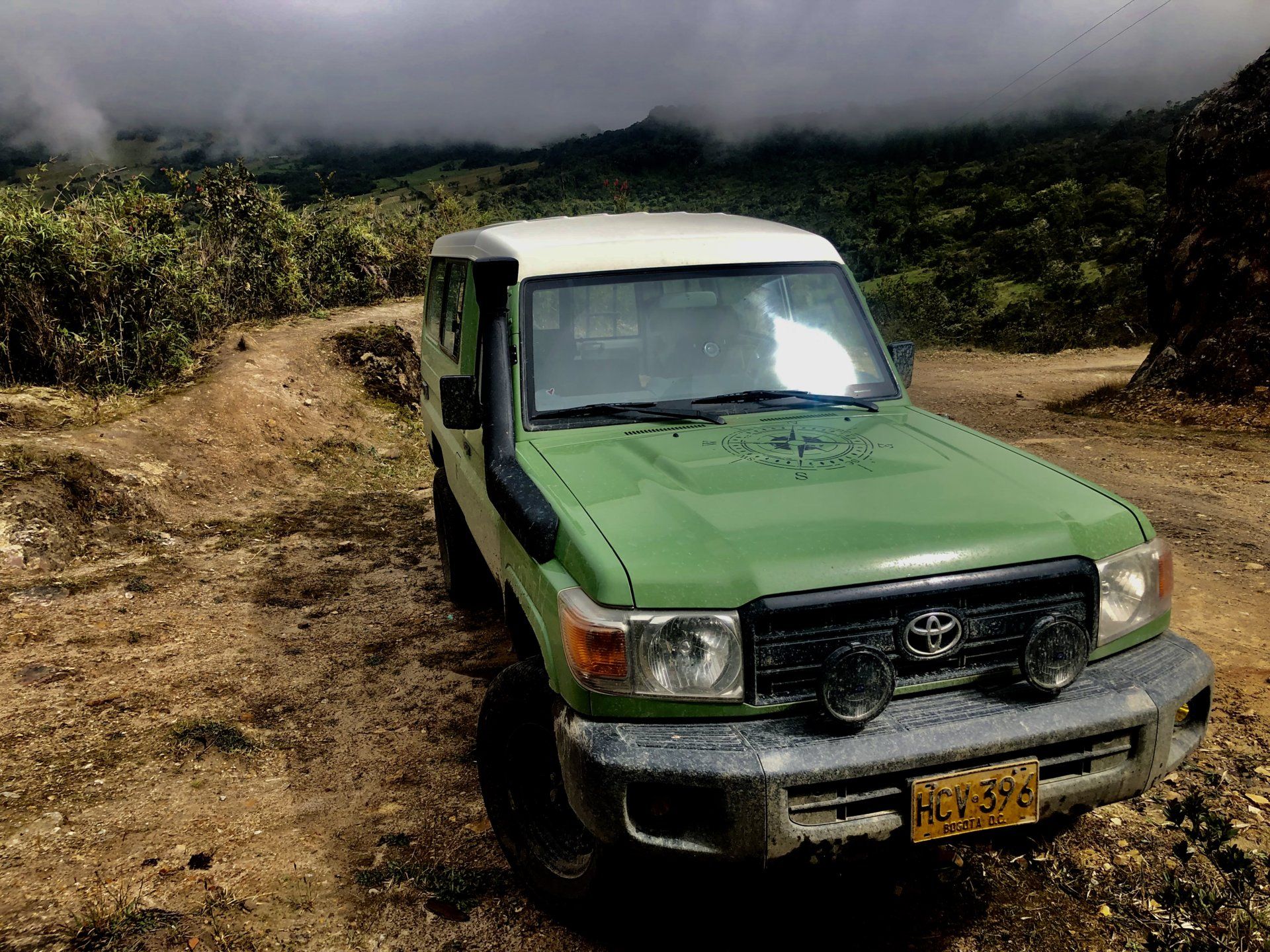

I drive on extremely dusty conditions on dry season and frequently cross hood-deep water on the rainy season. For me, its there to avoide being stranded, which sucks, or a trip to the mechanic. Its worth its price in peace of mind.
It is not generally a performance modification. Not without modifying the complete intake on the vehicle and the ECU. If you do all that, then I suppose it could be.
All my vehicles have and have had snorkels. Land Cruisers, Prados, Hiluxes.. all of them. I've used a few brands as well, cheapies, Safari, TJM.. They're pretty much all the same.
Those are legit reasons. Thanks for sharing.

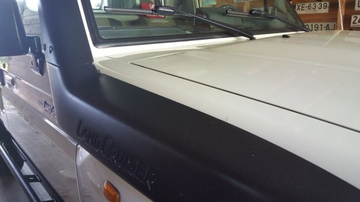

I went with the oem two piece and added a good bead of black silicon caulk to the joints. Let the silicon cure before assembly so it’s basically a silicon gasket. You have to seal the elbow fitting outside the fender and the inner fender plumbing in two places to seal it. Mine works well as installed.
Not entirely applicable to you truck due to motor and body differences.

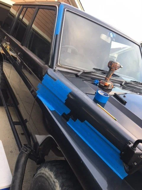

Perfect! I was just gonna go grab this thread and link it here...
