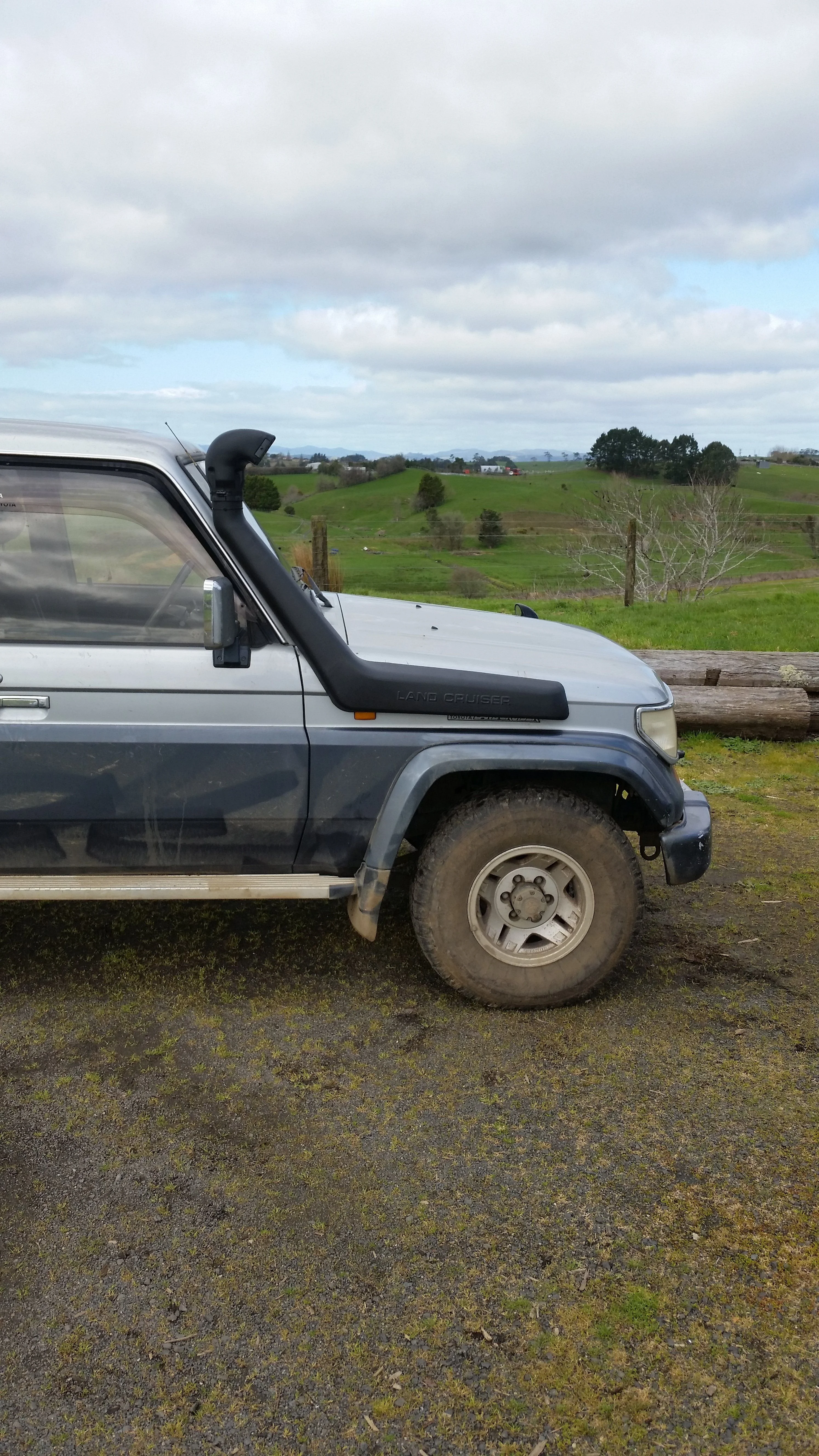

so my results from the Landcruiser branded snorkel that I fitted
so its for a 6 cylinder or v8 not sure but pretty much fits guard ok, no template but my guessing was pretty close(couple of beers and a close one eye line up with a 100mm holesaw eeek!)

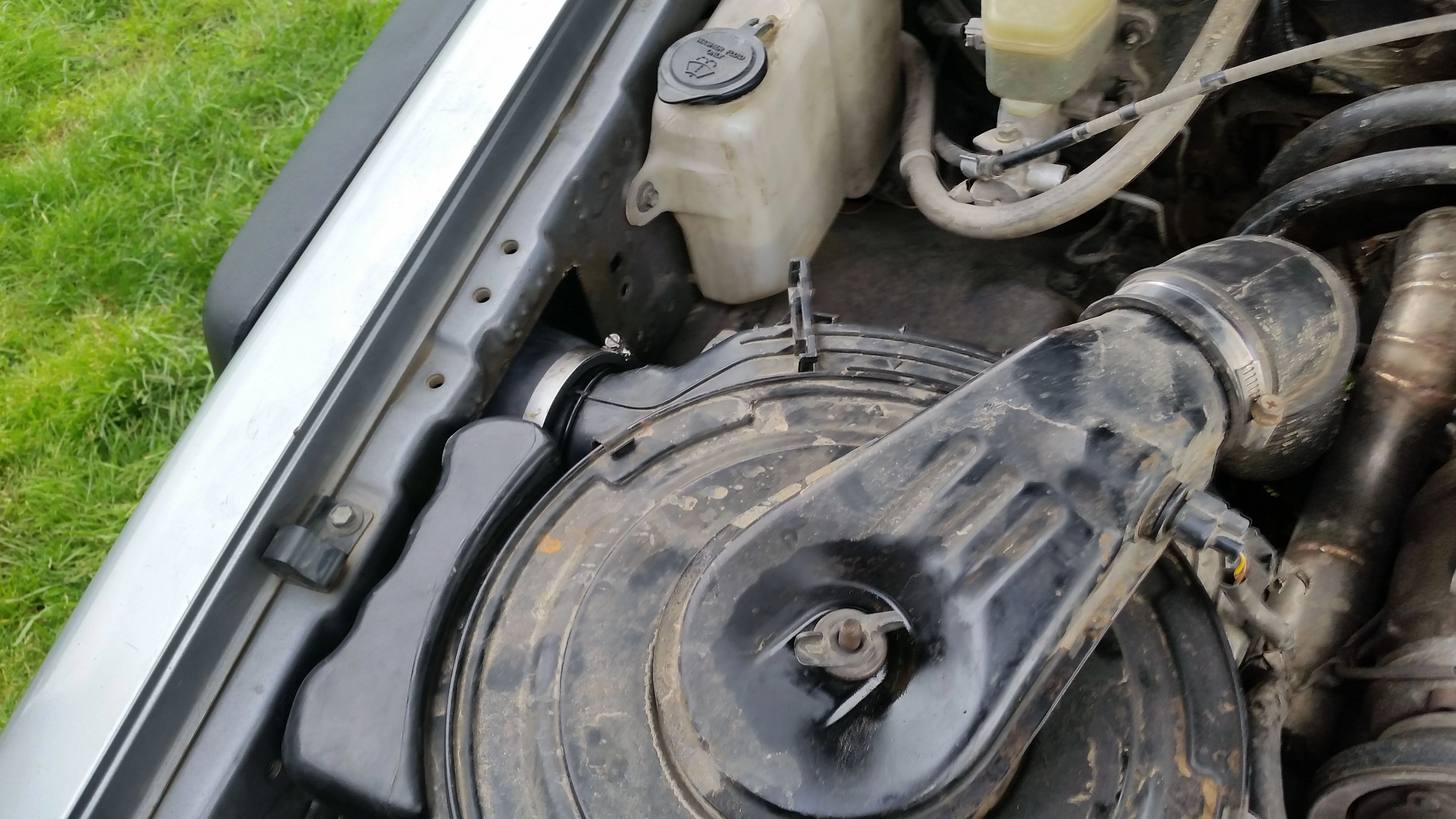

little mod and it goes straight onto factory airbox
Up my "test hill" which is on my way to work, commonly known as the "Bombay cook" (the area is called Bombay) where all the truck and trailers, nissan terranos, toyota surfs,nissan navaras and mistsi 2.8s all blow up or cook I am actually seeing a speed increase of around 4-5KM/HR after fitting snorkel which is really good , snorkel is fully sealed, factory airbox and cheapo paper filter

some pics that I sent lenny but for anyone else that might want to have a looksee
Just when I thought I had this all figured out, you go and send me an example of a snorkel working the way I would want it to work! 😉
