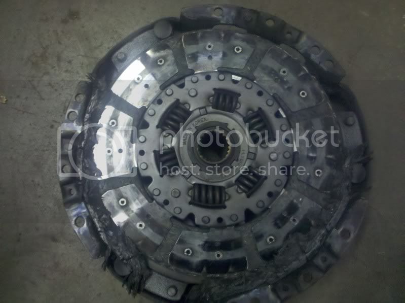

this POS lasted three runs
this ones a VALEO
Jesus I can smell that across the internets. I'll bet you're tired of doing clutches.
I hate not being able to shift but is an auto in your thoughts? Could work out better in mad rocks.
