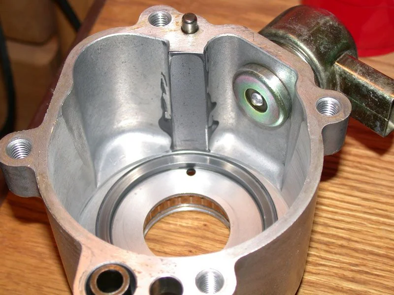

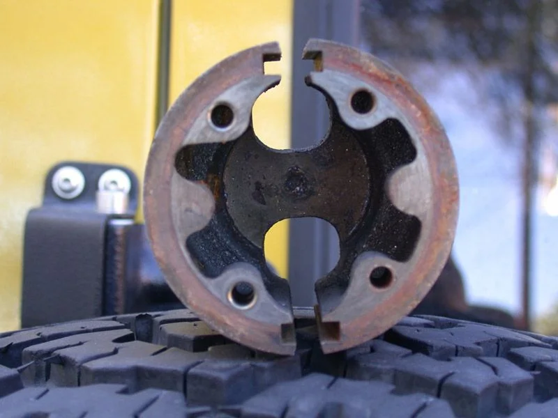

Many post on people replacing these and some rebuilding these but nothing with pics. From what I can tell this rebuild will work for any pump between 1/75 and 1/79 and possibly earlier models.
Rebuild parts can be found in this thread.
https://forum.ih8mud.com/40-55-series-tech/156216-smog-pump-rebuild-bearings.html
So pics. Pretty much self explanitory on how to disassmble.
Note: The nut retaining the pulley comes off clockwise. If you put and impact wrench on it and turn it the wrong way it will strip the nut. Ask me how I know.
