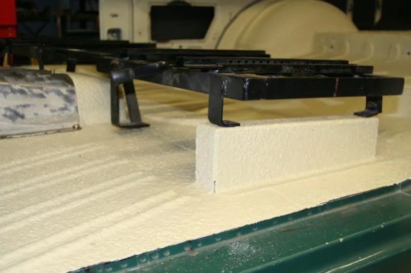

The seat bracket is from Corbeau Seats. Landcruiserman sent it to me, as I'm useing Corbeau seats. The bracket is made for a 55, both seats can slide seperate of each other.
I'm not sure if the rear heater will fit. I might have to remodel the frame, so it does fit. A Tuffy type center console will fit on the bracket, also.
Ron,
May I ask a favor?
Would you mind, when convenient, measuring the height of the bracket?
As long as I know the reference point from where you measured, think I can decipher how that relates to the concoction I have in 76, to see if the Corbeau is a feasible alternative.
If for whatever reason, you wind up needing another hump, let me know. I have five total, now and only need two.
Here you go. The seat bracket is 3 7/8" tall, from the stock toyota seat mount. For some reason the two front bolt brackets don't touch the floor. I'll have to use a spacer.
Thanks, Ron.
This pic confirms that your base won't work without considerable work that I didn't have planned until much later.
The outer base on mine in question, isn't there, but can use on of the others to fab one.
Guess a guy could get the corbeau base and use to adjust height to ensure clearance at heater and contact at floor, but at 6' 1", hate to raise too much.
