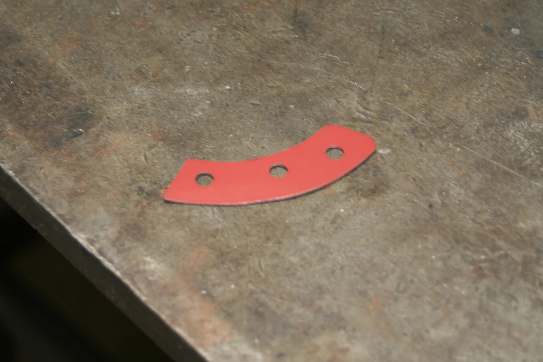

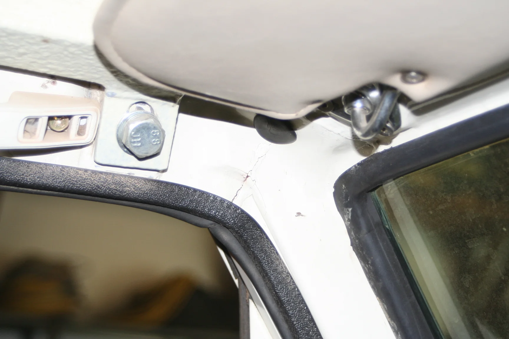

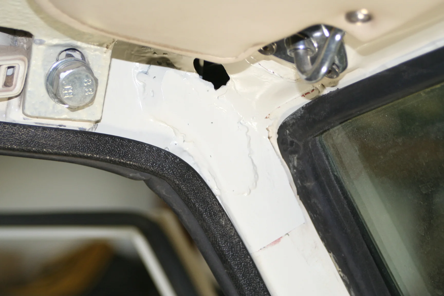

On the Pig Party trip we discovered a crack on each A pillar going up to that hole in the pillar. I'm not sure if this is a common crack with the pigs, but it looks like someone had welded both before. Either way it needed to be addressed and I knew it wasn't going to be pretty. As you know I'm not using a headliner, so it's all hanging out, the good, bad and ugly. I made a scab plate with some rosette weld holes and welded them up. There was plenty of anti rust products inside the pillar that started burning when the welding started, not to mention blowing holes in the metal making it lively. Hopefully it will hold another five years or so until I'm done with it. I had paint mixed to match which didn't 🤷‍♂️, but it's sorta close. It might be a good place to check when you have the headliner out.
Interesting! I wonder about putting that extra weight up on the roof, now we know!
