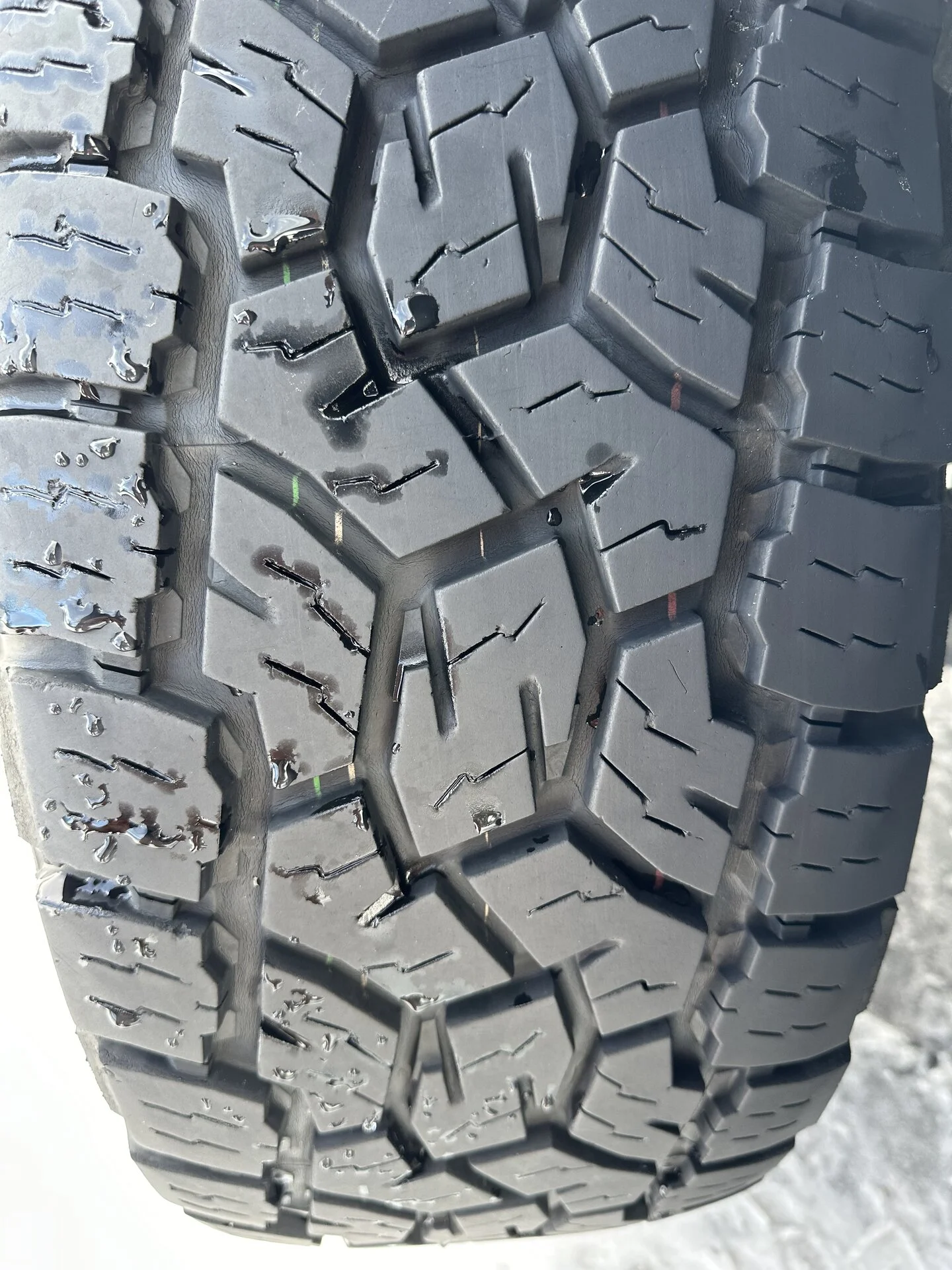

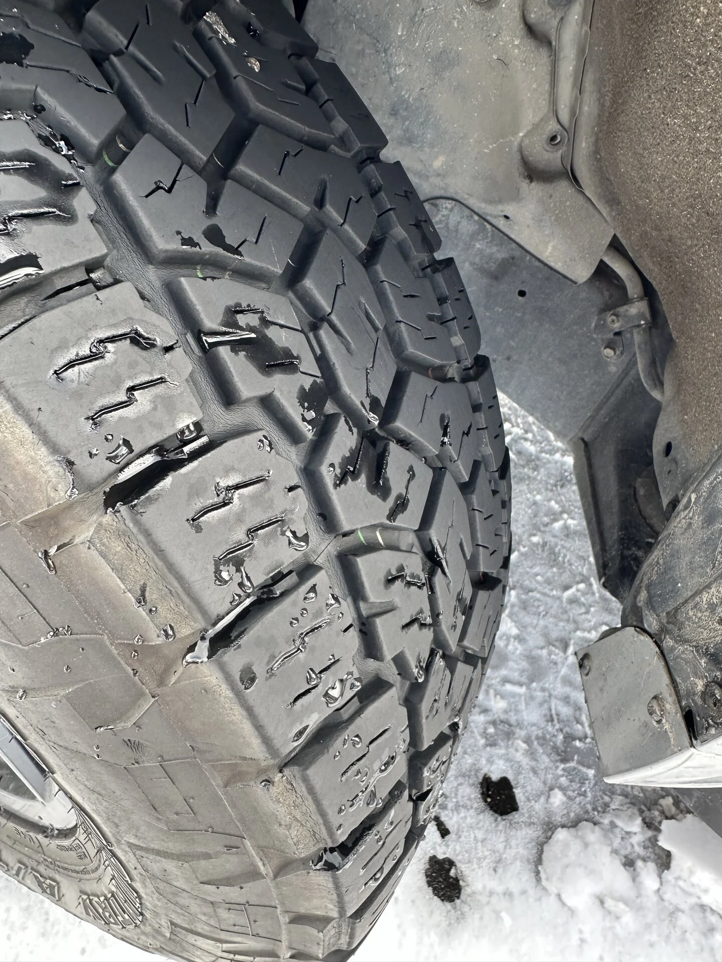

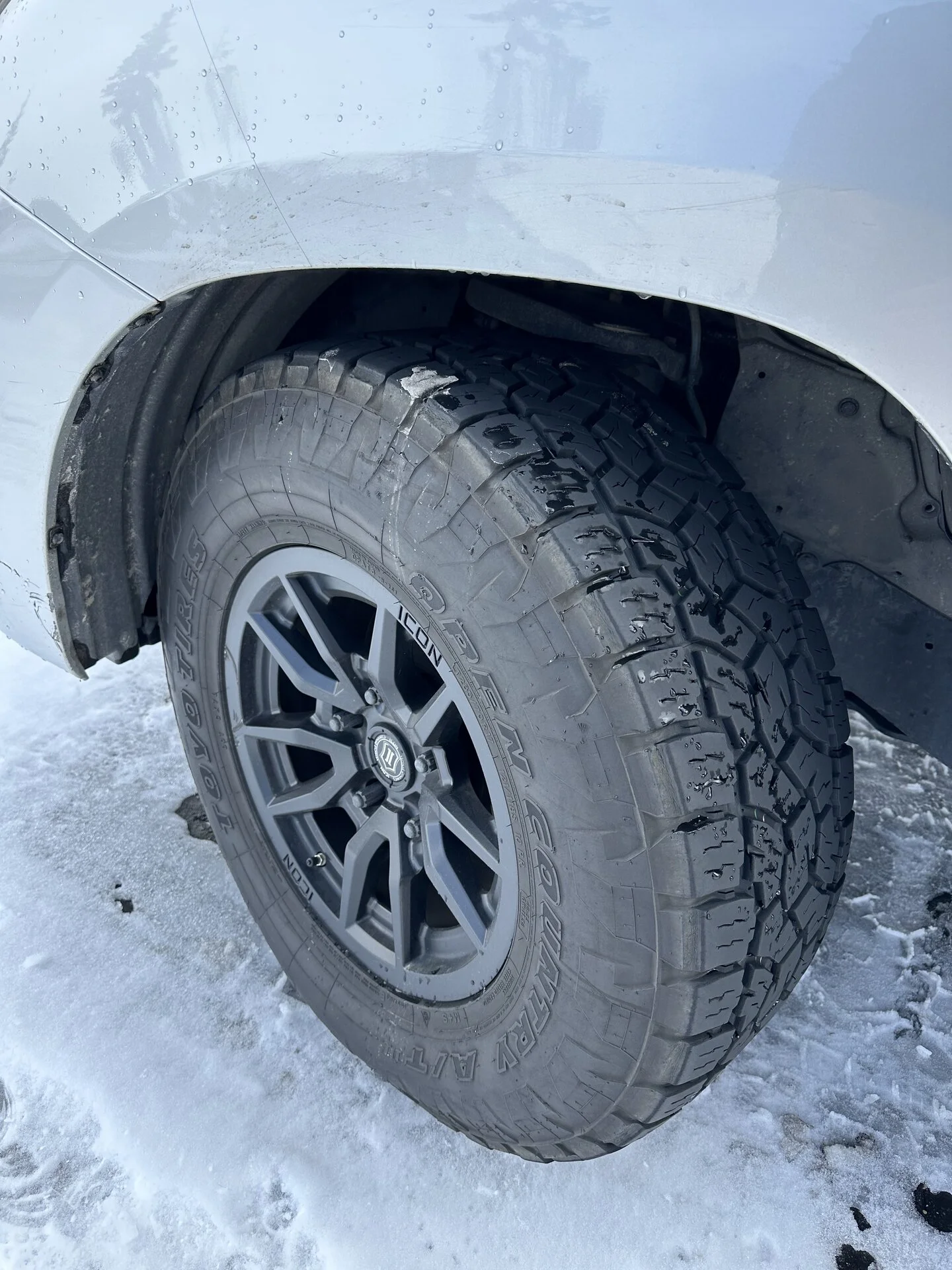

The Toyos have 25k miles on them and lots of tread left (see pics).
Any thoughts?

Looking at the tires I do not see many sipes which is what really helps improve traction. I am surprised they got the the 3Peak rating. That said, one should understand what the 3P means on a tire.
  • Testing measures a tire's acceleration traction on medium-packed snow only. Braking and turning on snow, along with ice traction are not components of the test.
Though the tires only have 25k on them how old are they? I see a fair amount of cracking. With age tire rubber dries out and becomes stiffer, leading to cracking. As such, I am wondering if their life in Bay Area has aged them more than expected thus their winter performance is degraded????
@TheIcemanCometh - The tires were installed about 2.5 years ago.
I can't find the date code tonight (will look again tomorrow in daylight) ... but I usually check those before taking delivery, so I think they should be reasonably close to ~3 years old.

OP should've gone with the passenger version of the Toyos ATIIIs. They have tighter packed lugs, a lot more siping and more silica in the compound.
