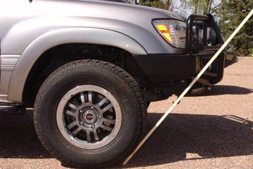

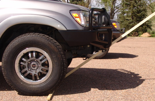

Here is a teaser side shot showing the differences in wing design and also the differences in how far it stocks out. The truck on the left has about 1" more lift.
OK...so if I see the pics correctly I see that:
*The side wings are back farther on the Slee (good)
*The bottom of the side wings however are higher from the ground on the ARB (and after factoring in the lift hiehgt difference) (good)
Seems like a wash?

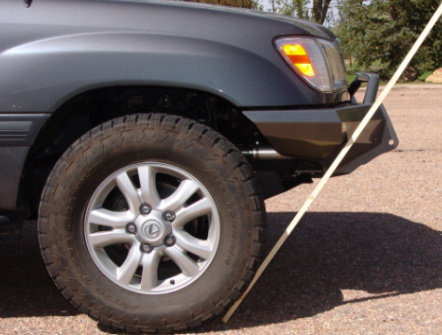

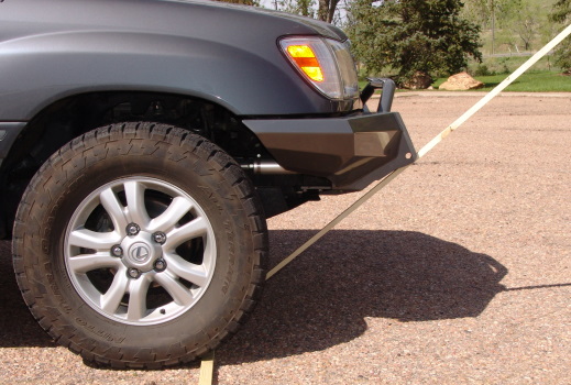

Actually it is not. Right in front of the tire we have about 5 degrees extra approach angle. I actually measured it. That is not taking lift height into account.
Gotcha. I was viewing it as though there was a rock under the bumper wing. Looks like the ARB will clear the taller rock without scraping. Looks like your bumper will clear the taller obstacle better (something higher than the bumper wing bottom itself).
Why isn't the approached measured at the lowest part (center) of the bumper? Measured at the wings does not seem to give the actual approach available.
This was just one of the places we measured it. Most times if you want to climb a rock, you are going to try to get the tire up, not the nose. Unless it is a ledge, and even then an angled approach is better. Again lift height is not taken into account. We put a piece of wood in front of the tires to get the spot in the middle of the truck.

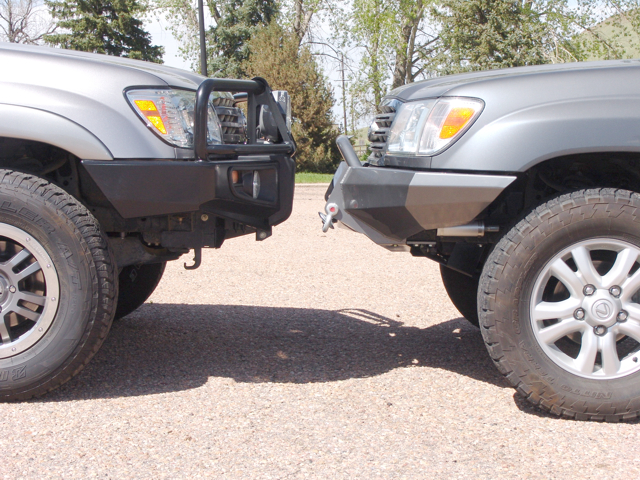

Here are the center measurements. These are the leading edges, but ignoring our tow points and the ARB bumperetes.
