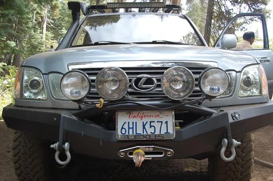

Slee Front Bumper
I wanted the winch to be easily removable for servicing w/o removing the bumper. On the LX, the front grill goes up with the hood. All that obstructs the winch is some plastic trim and a metal crossbar. I've sectioned the crossbar so it can be unbolted. The headlamps are still very secure without this piece. I could even leave the trim and this section of the crossbar off permanently if I desired. The M12000 slides in/out easily now.
Some front bumper photos

I'm super happy with the bumper. The only improvement I can think of is closing up a couple of chambers inside on the sides to use as air tanks :).
