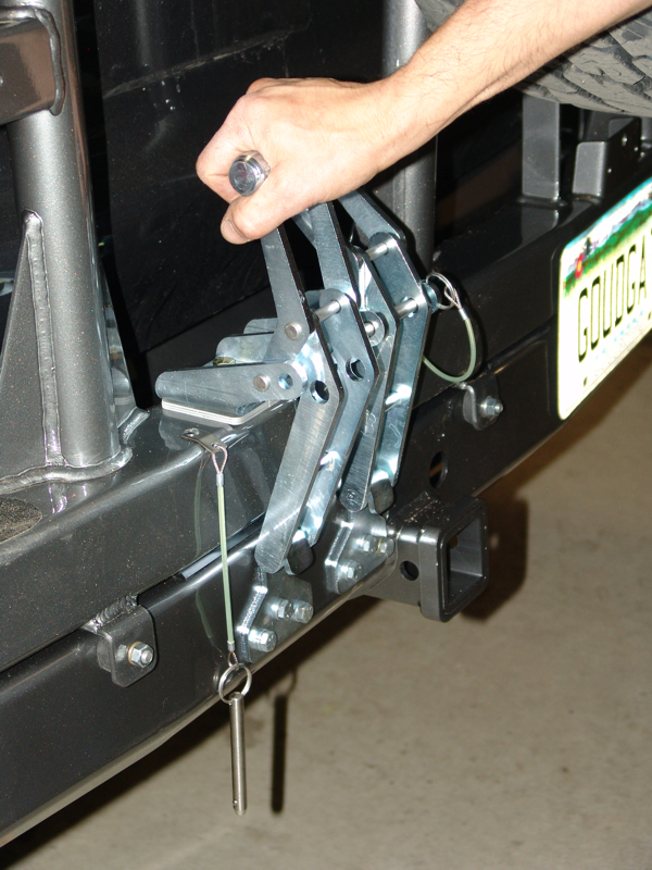

Are those 747 controls in the middle of the bumper :)? Any closer pics of what he's using to latch the swing outs?
Yes, that is what we stole them from :D
Those are new latches we are designing. Yes, they are big but they have several advantages.
1. Easier to operate for the weaker sex.
2. Locking pin to prevent accidental opening.
3. The pull direction has been designed to be optimum for the tire carrier design.
4. Modular design to easy in servicing when damaged.
The nickel plating is a little obnoxious and we are looking at what we can do to get them black.
Oh, and they don't look like they were bought at the hardware store.

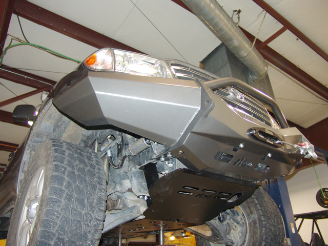

I dont know if its the picture (we need better pics) what purpose does the center dropping down so much serve?
It allows access to the winch line if it gets tangled up. Also adds additional space for the M12k winch. The winch pictured on the truck is a 9.5XP.
There are several other reasons why it is open. Some has to do with bumper install, others with visual impact. If you make the front taller, then it looks like a bulldozer blade. I know it is not everyone's cup of tea, but we have had good response to it.
This bumper is made for wheeling people. If you use your winch a lot, it will eventually tangle the rope or wire on the drum. Fixing that in an enclosed bumper is a pain. But then John would not know about that since he never needs a winch :D
We might look into making a cover for non-winch users.
Again from the picture the first thing to come in contact on approach angle is the fairleed, cable or rope?:doh:
Not sure what you are trying to say here. Yes, if you run straight into a brick wall it will. The wings are significantly smaller than any other bumper out there. The most clearance is in front of the tires where you need it the most.
The front edge is the minimum you can have and still fit a M12k winch. As it is, you have to trim the hood/grill support bracket. It is also the highers it can go to clear the bottom lip of the front valence.
The bottom is sloped as much as we can and still meet with the crossmember on the truck. I can assure you this is as tight as you can get it and still run a M12k.
The side wings apear to be huge and hand down too much. :confused:
The wings need to be that big to protect the truck. There is very little excess on them.
This shows the botoom of the bumper more. We have some cosmetic issues to fix with how it interfaces with the skid plate.
The place where the skidplate and the bumper meet is the bottom of the crossmember.
Again from the pictures I see no advantage in the approach angle. Speaking of approach angle what are you getting with your ARB (be honest:flipoff2:). I get 40* approach with 285's on my TJM and much better on the ends/corners.
When I get a 100 with ARB in here again I will shoot some pics to show the comparison.
Christo: I know you are in the home stretch so to speak with this bumper and it's current form has been the result of countless hours/days/years(!) for you and your staff but I wonder if you could: Raise the "mouth" edge a little to lessen the "gate mouth affect" but still allowing winch access?
That is not going to happen. If we do that, we are back to square one.
And could you move the recovery points...where the bow shackle attaches...a couple inches higher (not atop the bumper but just a little higher for lessened snagability?
They are as high as I am confortable putting them thinking of the guy that will snatchblock back to the truck with a M12k winch. Any higher will putt a lot of stress on the mounting system.
FYI: I really really like the wings and left/right of the "gate mouth" in design and construction: This design appears to be the most robust of all bumpers yet to be designed for the Hundy.
We tried to make them as strong as we can considering we do not have upper tubing to help in the strength of the wings.

I did not like the rear bumper at all. But I didn't like my Slee single carrier rear bumper either. These new latches have too many steps to them. If you have something big in your arms and you have to pull a pin, then flip a latch, and do another pin you're screwed. I know Christo does a lot of this stuff for safety but some of the redunancy gets excessive. I welded my hole shut on my Slee bumper so the pin only latched in the open position as my wife was frustrated with always having to pull the pin after releasing the latch.

The metal latches on the rear bumper would be a deal breaker for me. Superbly ugly. Needs to be black and/or paintable.
I do realize this. We might eliminate the 2nd hole that drops the pin in the hole when closed. Then the locking pin for the latch is optional to use. Again, probably not the bumper for people that use the truck daily and have to get kids and groceries etc etc into the truck all the time.
I know, but I wish you could tell than to the insurance companies.
Gas struts are a solution to this, however I have seen them break before. Not common, but something that does happen. We will look into that again as well.
They are clear zinc plated for corrosion protection. They can easily be painted. Other than powder coat I have not found a black corrosion resistant coating. Powder coat won't work in this application. I till just chip and the leave rust prone spots.
Believe me, I would really like to do a billet machined latch that does not look transformer like, but it is cost prohibitive. This latch is a way better design than what we currently use. It was designed for the tire carrier, and not just selected out of a catalog. The old latch served us well but time for an upgrade. Also this is not the final design. It is a test set to determine functionality and strength. However don't expect it to change much. You have to use them compared to the old one to really feel the difference.
