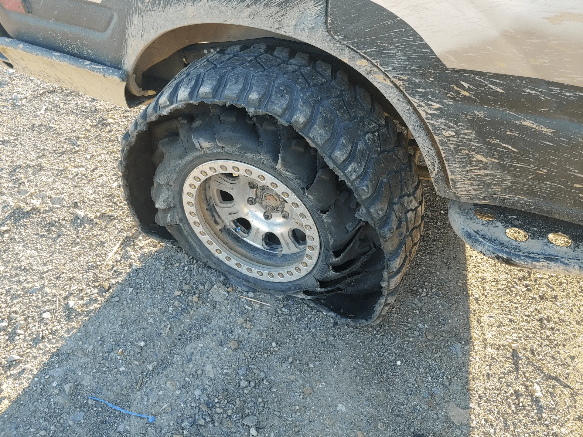

This is an example of what can happen to a tire that's seen a lot of off road miles - and it's LT rated! Tire was about 5 yrs old and the owner, @spyduh could probably give you more history of the tire. This happened on the highway and same thing happened before with another tire from same set. What failed? Looks to be the sidewall, although the tread looks fairly worn, too. And I can imagine that a lot of the damage happened after the blowout, before the rig could be stopped and thankfully it was on the rear. Most tires are not subjected to the use this tire saw, but the sidewall was extremely weakened to rip like that. Although the beadlock may have assisted the tearing apart sidewall from the tread, the sidewall was seriously weakened to allow this result. Conclusion: Sidewalls are the Achilles heel of tires. Ignoring punctures, your sidewalls are the most "at risk" part of your tires.
So, what's my point? Not a good idea to run unsuited tires off road habitually, not that this tire was unsuited. You may get away with it, even for an extended time. But a failure at the most inopportune time could have disastrous consequences for you and the passengers in your rig. Most tires have sturdy enough treads, but the sidewalls need at least as much consideration when choosing what you're going to use, especially if off road use is your future. And pay close attention to the psi that you're running, because your sidewalls are as much affected as tread wear. As much as under-inflated tires affect tread wear, it's the sidewalls that suffer without much visible evidence and go unnoticed until it's too late.
I would argue that the beadlocks saved the tire from coming off the bead and was less scarry. My other Turbo80 on oem 16s blew out on the freeway as well 2 years ago. That was only a 2 year old tire (Duratrac 35) and the bead came off of that one. That was way scarier than the blowout in that pic. It was just a couple months ago going down the freeway to Hammers.
37 STT Pros that were 4.5 years old with about 50% tread life left.
None of my cruisers are daily drivers and get very little miles on them on pavement.
IMHO, P tires on any cruiser is asking for death. Cruisers are heaaaavy and need a E rated LT TIRE. The Duratrac was a E rated. The STT Pros were a D rated.
Ive blown out 4 tires on the highway in 2 different 80s. Front driver and rear driver on the Turbo80.
Front driver and reae passenger on the Crawler80.
Don't be cheap and buy yourself a new AT tire and inspect the crap out of them.
