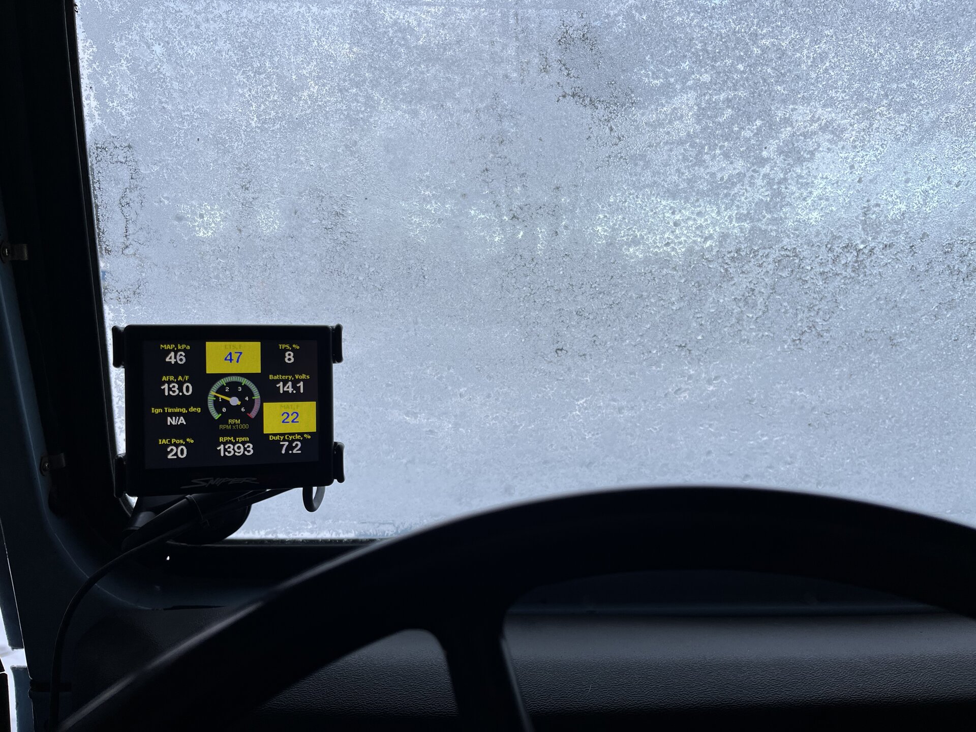

Aaaaaahhhh that’s better. Still sub 30 manifold temps. Nice dense air charge for all that raging horsepower.

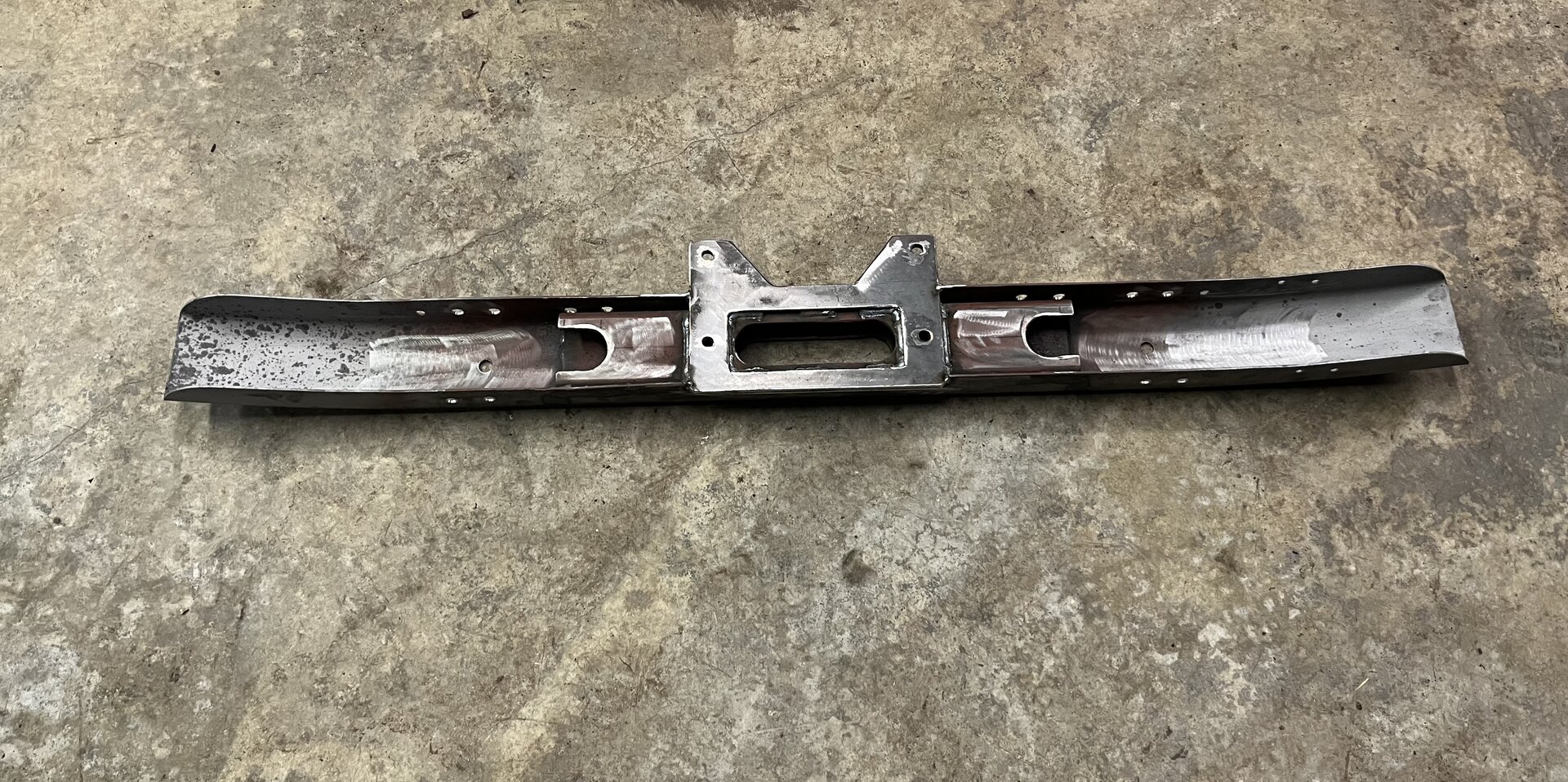

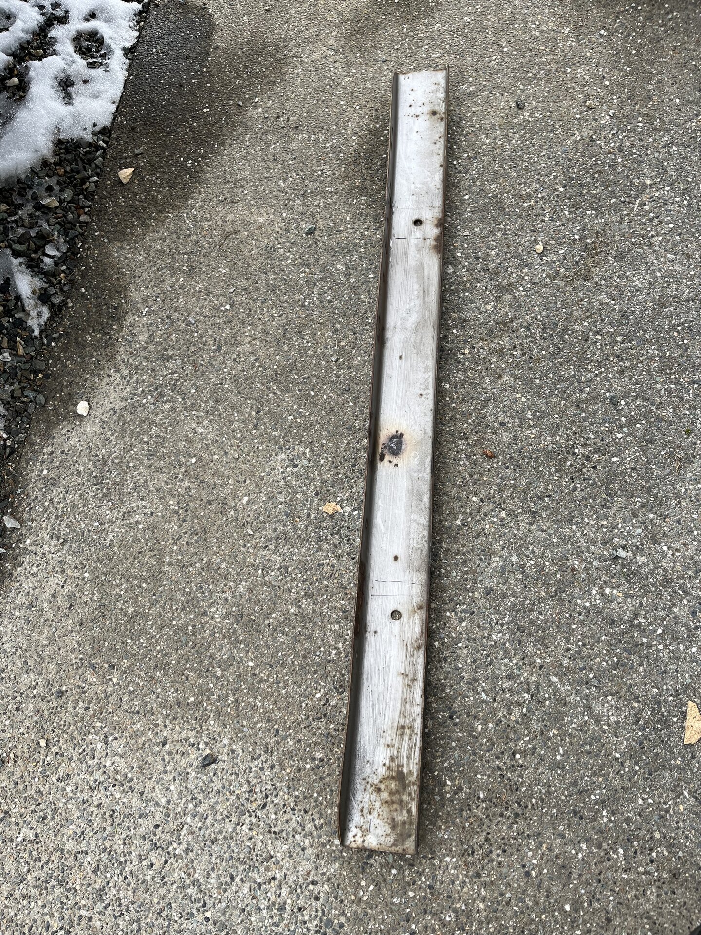

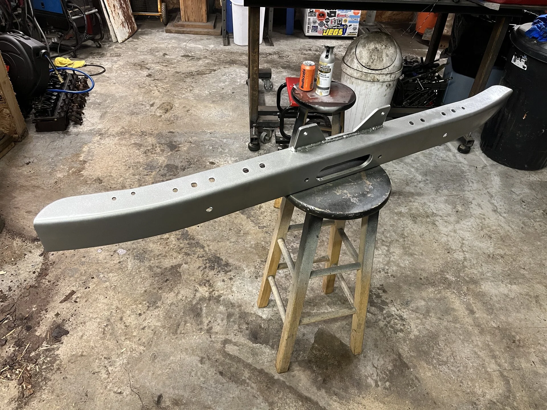

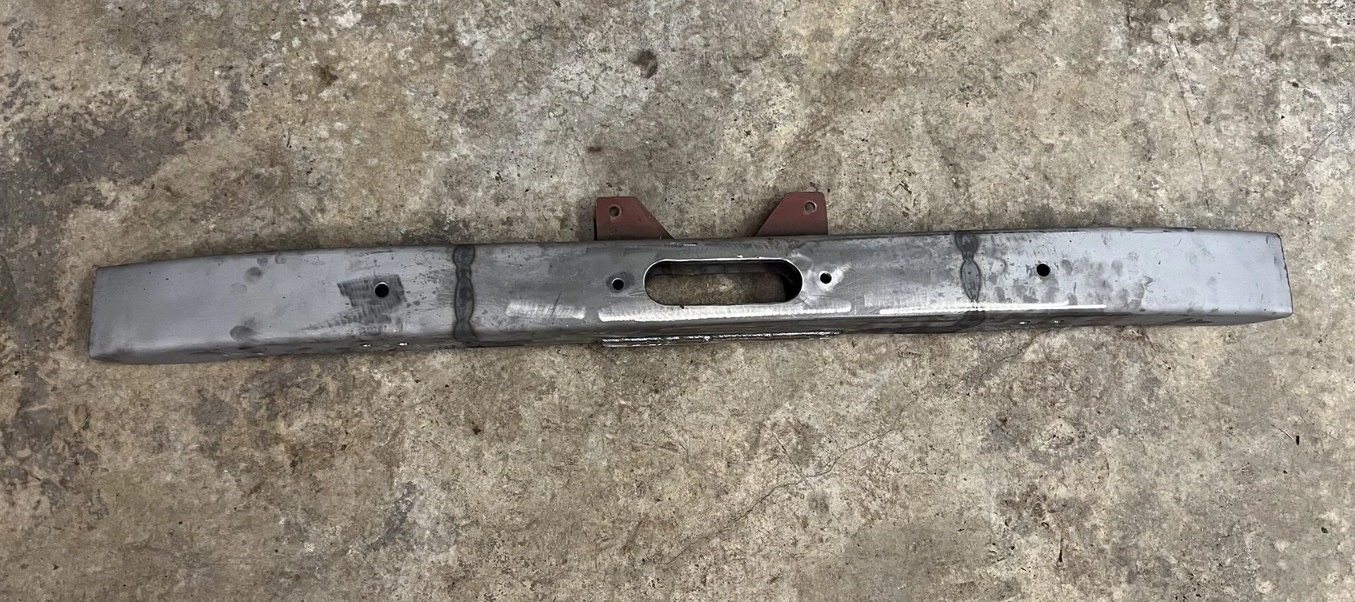

Started with this FJ55 bumper and had it sandblasted.

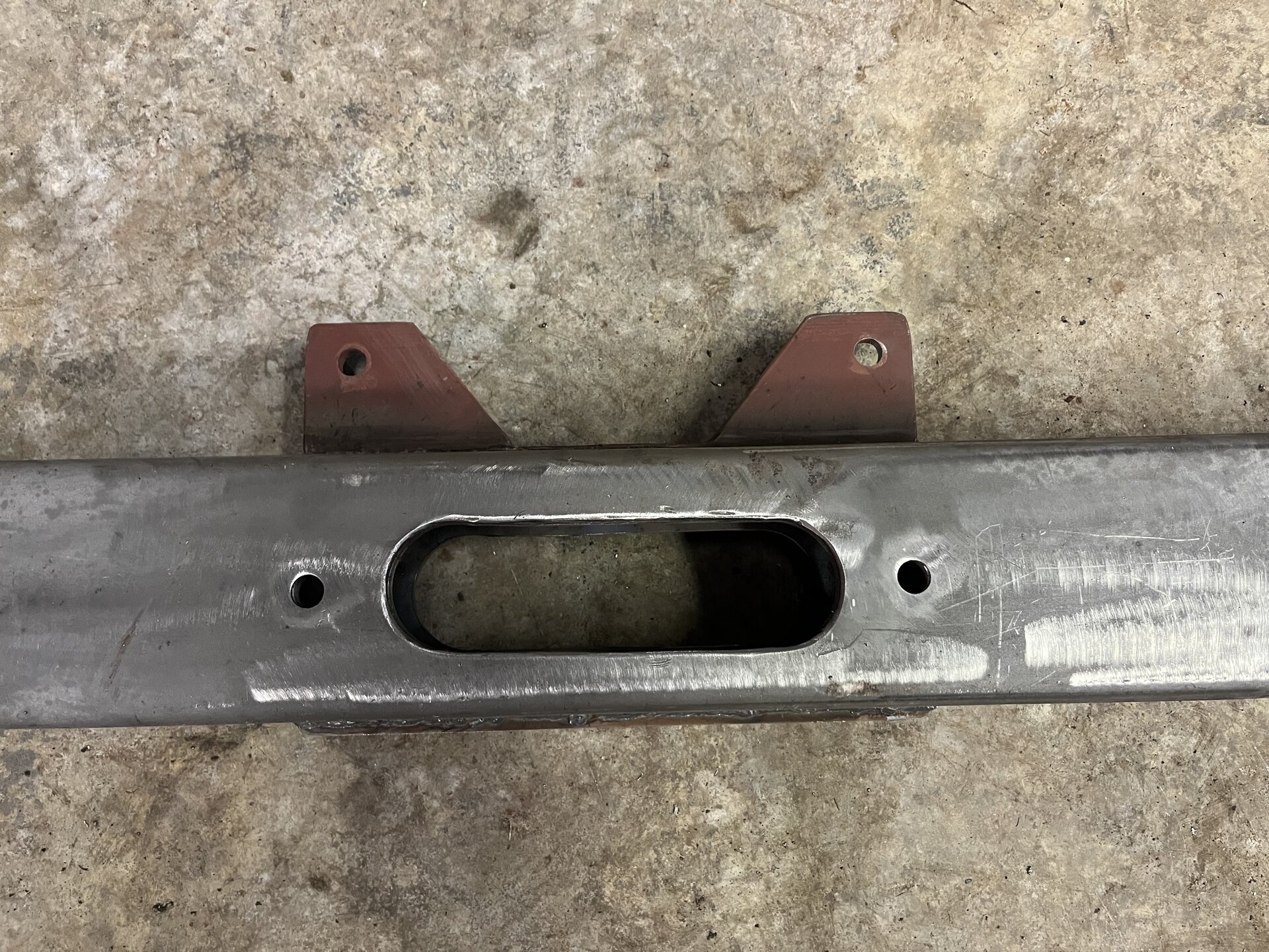

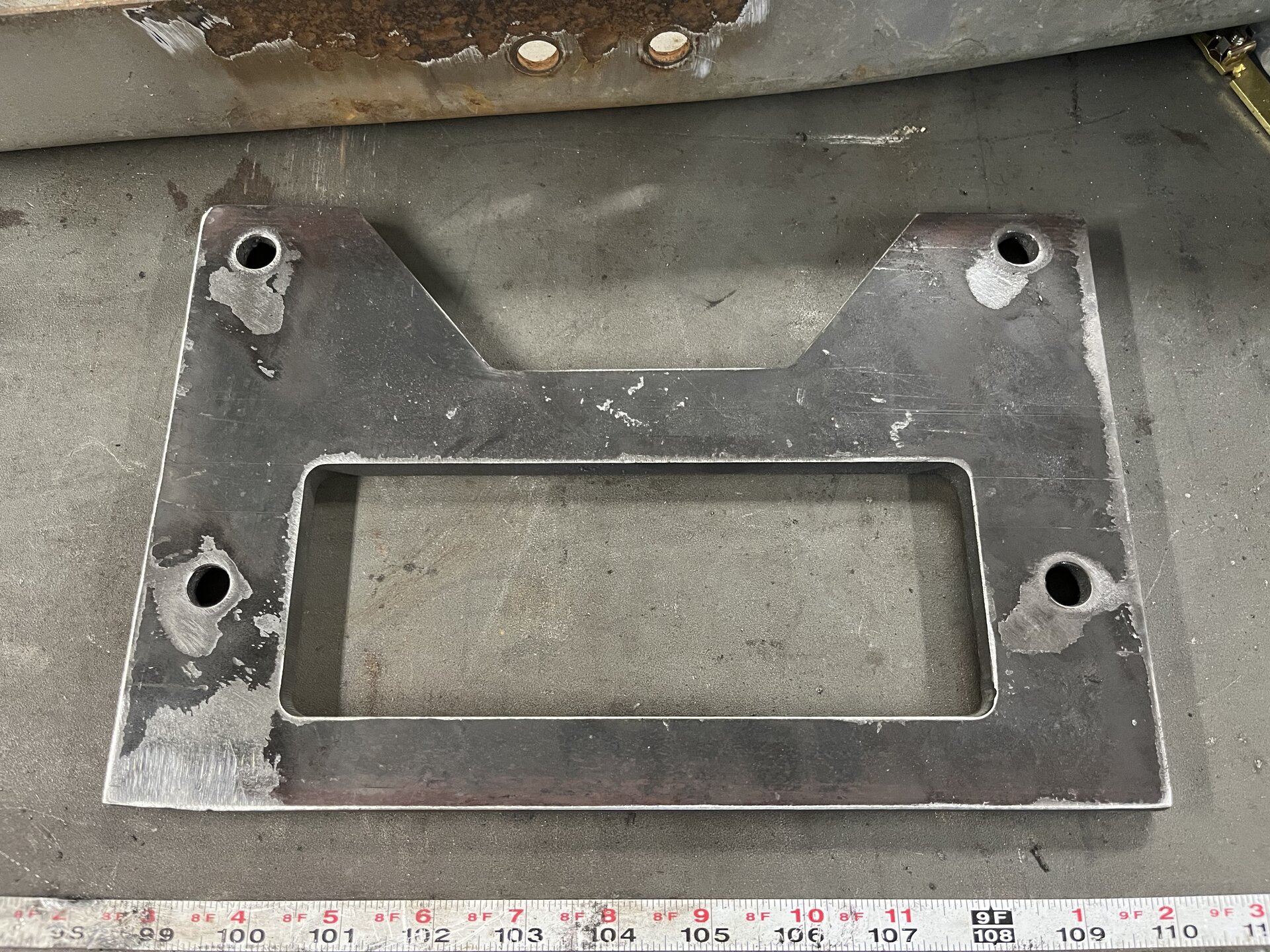

Had to hammer a couple dents but ended up pretty straight. @mr2m1 cut me out a couple of these winch plates on his plasma table. Anyone nearby get ahold of him and he can cut out your design or his. He powdercoats too.

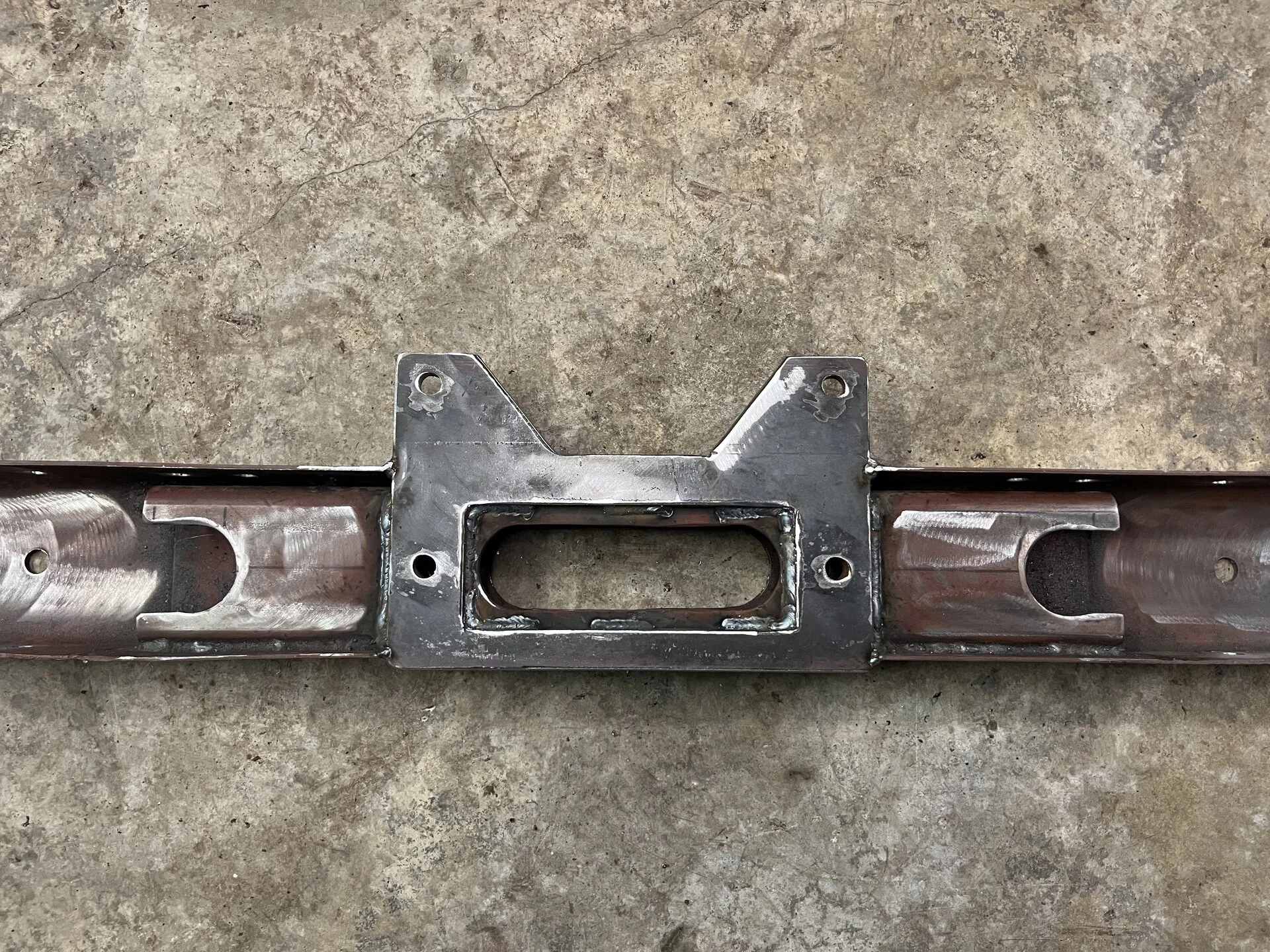

Welded in the internal support piece, drilled and cut out the winch holes and added the plate.

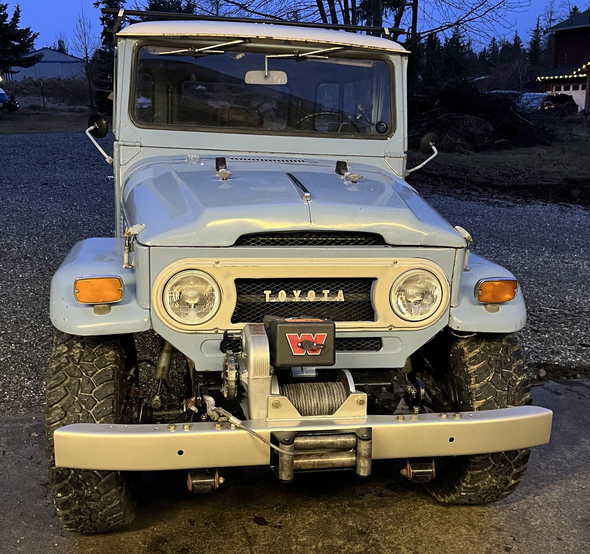

A coat of rustoleum metallic Satin nickel and ooooooh. It is still below freezing here so a big fire in the shop and a couple heavyweight beers are helping paint dry and keep me warm-ish.
Initial pic. Everything is installed and working with new 1/0 battery and winch cables. Tomorrow we are planning on driving up a VOLCANO!!!!! (Dormant) to get a Christmas tree. I’ll try to get some really good poser shots that will look awesome when taken out of context
Dormant?! Pfffff where is the fun in that? :p
Rig is looking great!! Those 8274s are always just perfect on the 40s. :cool:
Initial pic. Everything is installed and working with new 1/0 battery and winch cables. Tomorrow we are planning on driving up a VOLCANO!!!!! (Dormant) to get a Christmas tree. I’ll try to get some really good poser shots that will look awesome when taken out of context View attachment 3189453
I love it. Factory bumper makes it so much better looking than one of the flat jeep style winch front bumpers. I am going to need one of these now haha.

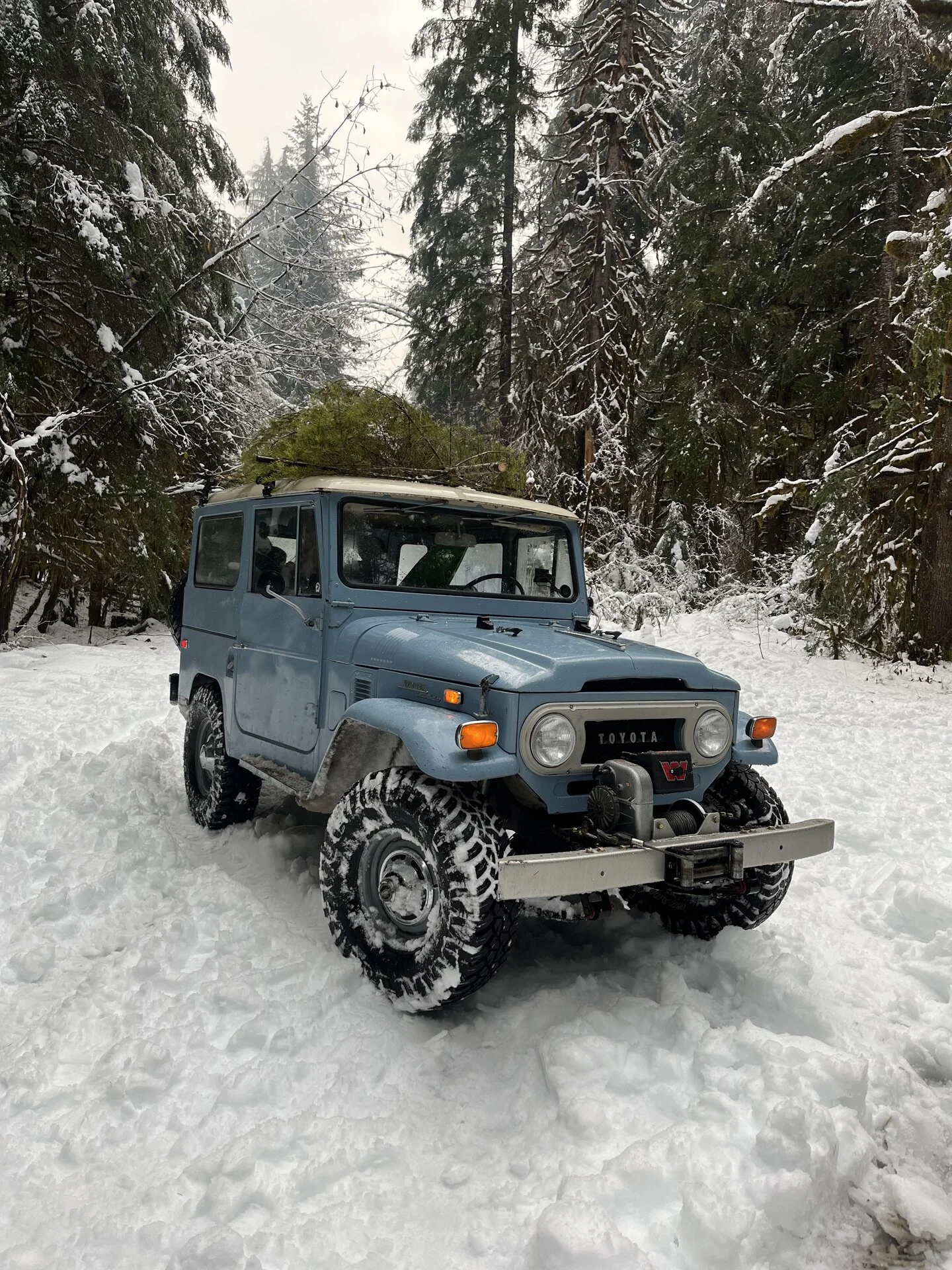

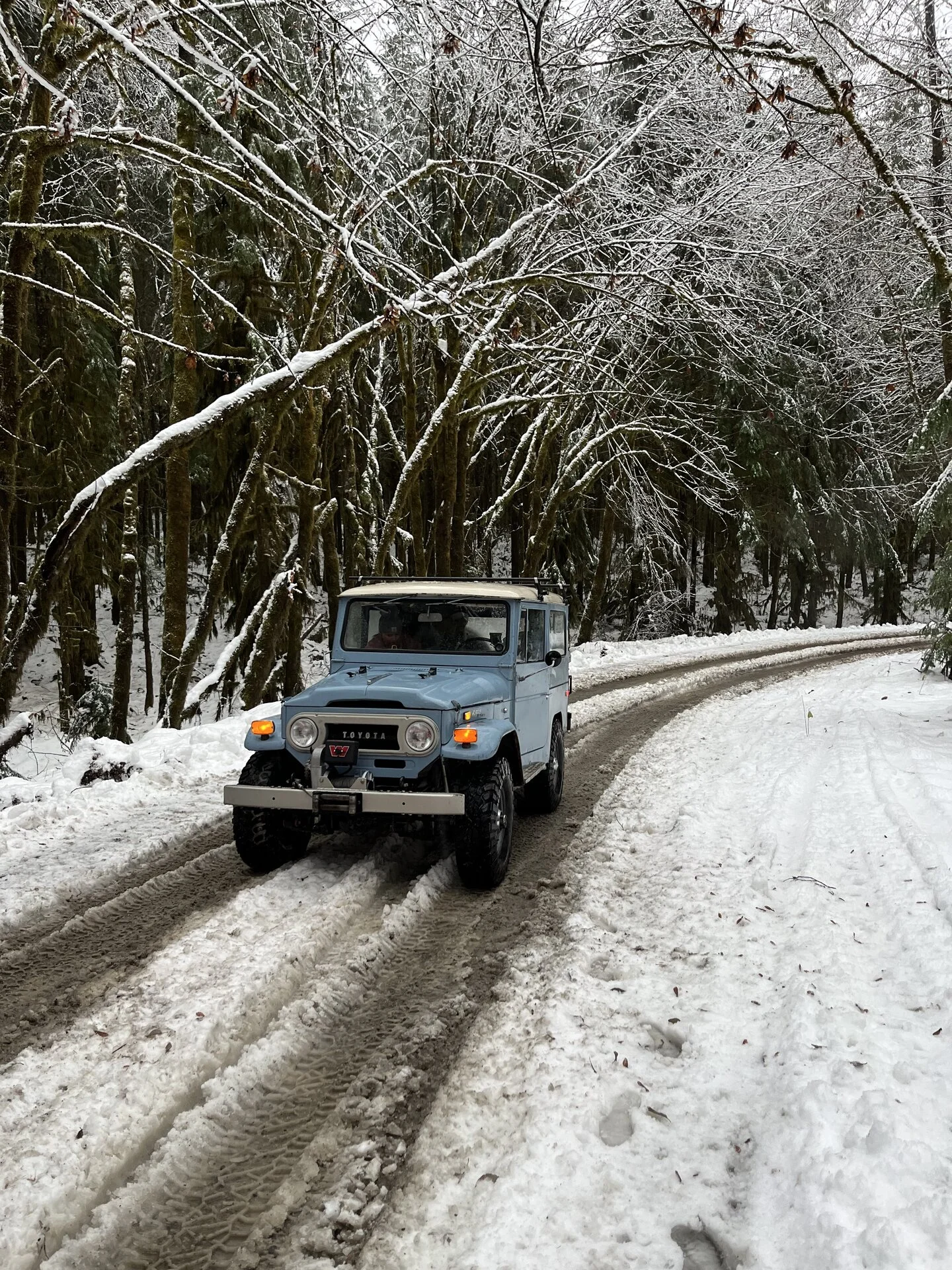

Left in the rain, got into heavy, wet snow, but found a tree. Was with 3 newer jeeps. Saw a bunch of other people and a few more jeeps. Everyone we talked to was most interested in the cruiser.

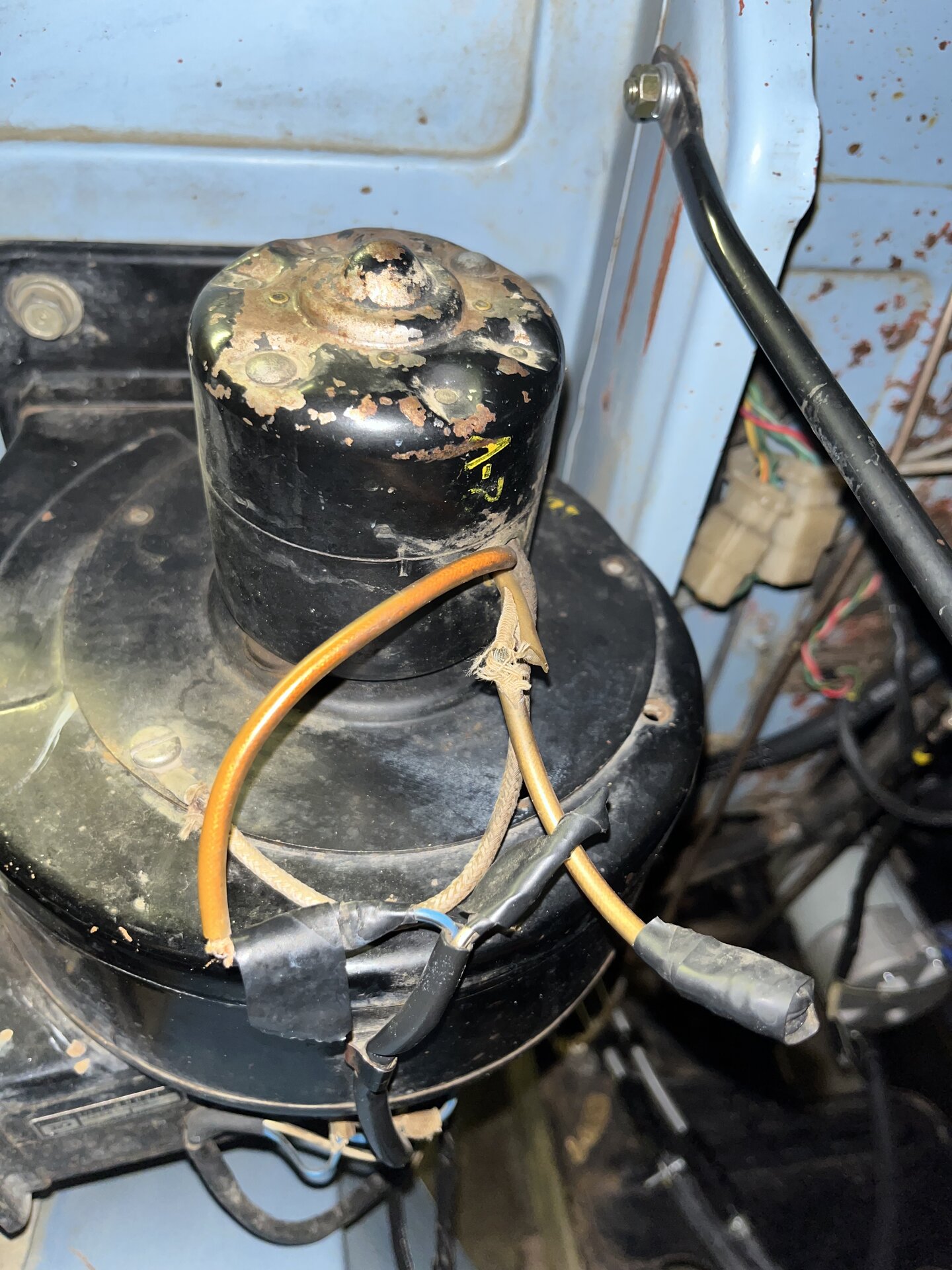

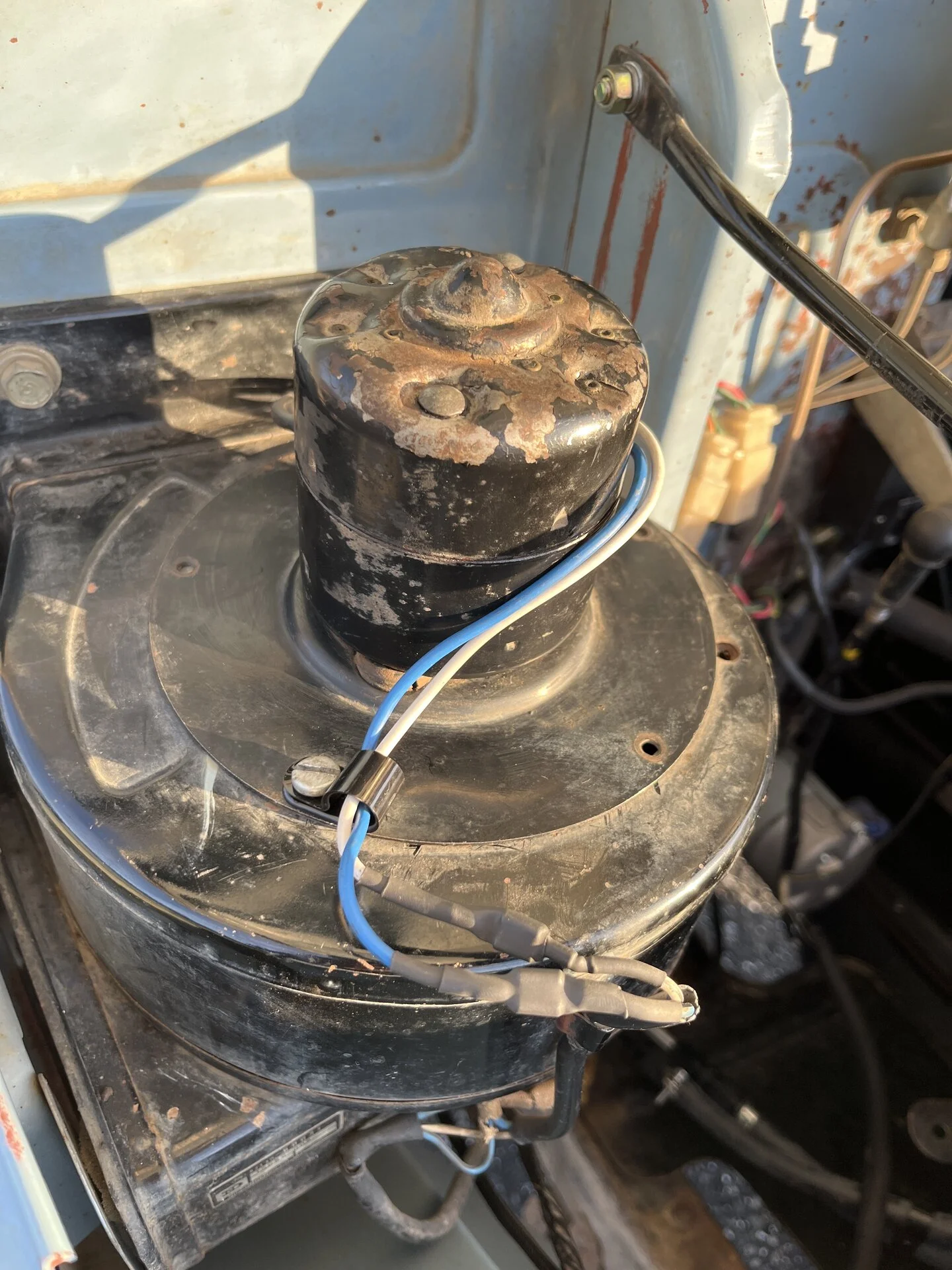

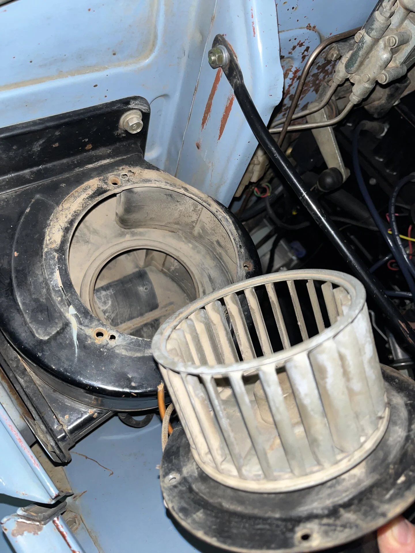

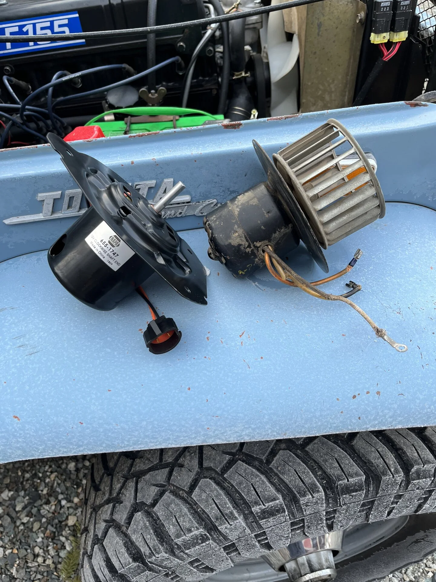

Next, I took a look at the blower fan. Mine isn’t stock, was replaced long ago with a similar size unit, but I think the squirrel cage fan is a lot smaller than stock. Opening is nearly 5” and the cage in there is only 4-1/8”. I picked up a new fan from Napa I’d read about: 655-1747. I’m going to return it because it seems to only turn about the same rpm as the one in there. I have no way to measure this, just seems about the same. It’s also way louder. It needs modified to fit and my current fan wheel would also need modified to fit it. Didn’t want to go through all that and end up the same. So I took my existing blower motor apart, cleaned it, soldered new wires in and put it back. Blows about the same.
If anyone reads this and knows of a good replacement fan (or has a good stock one), let me know. I found a larger wheel that will fit this motor that I may try.

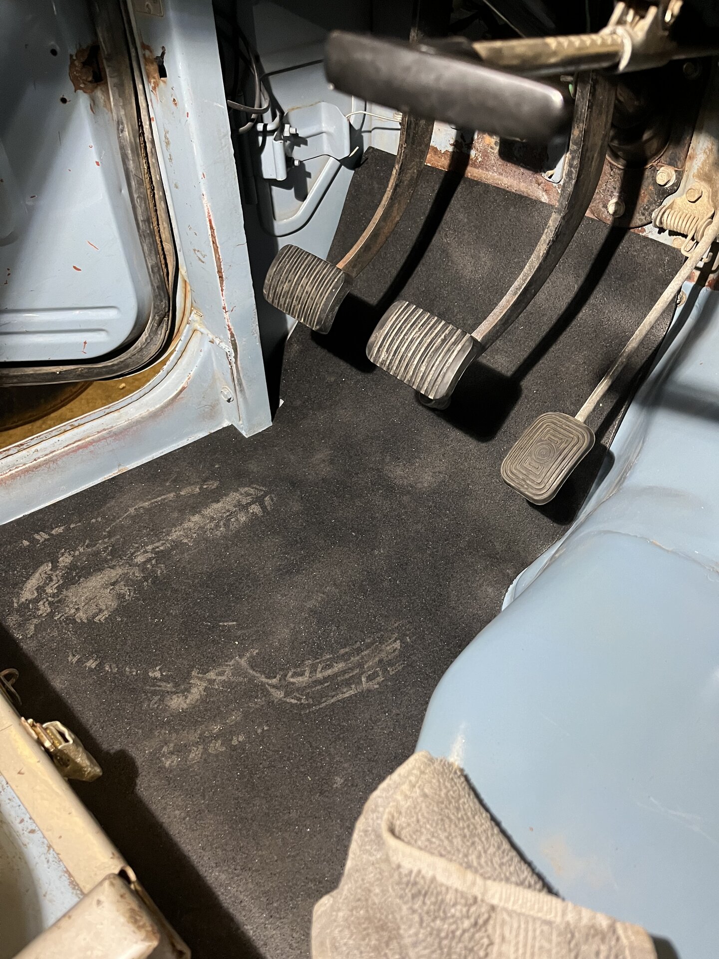

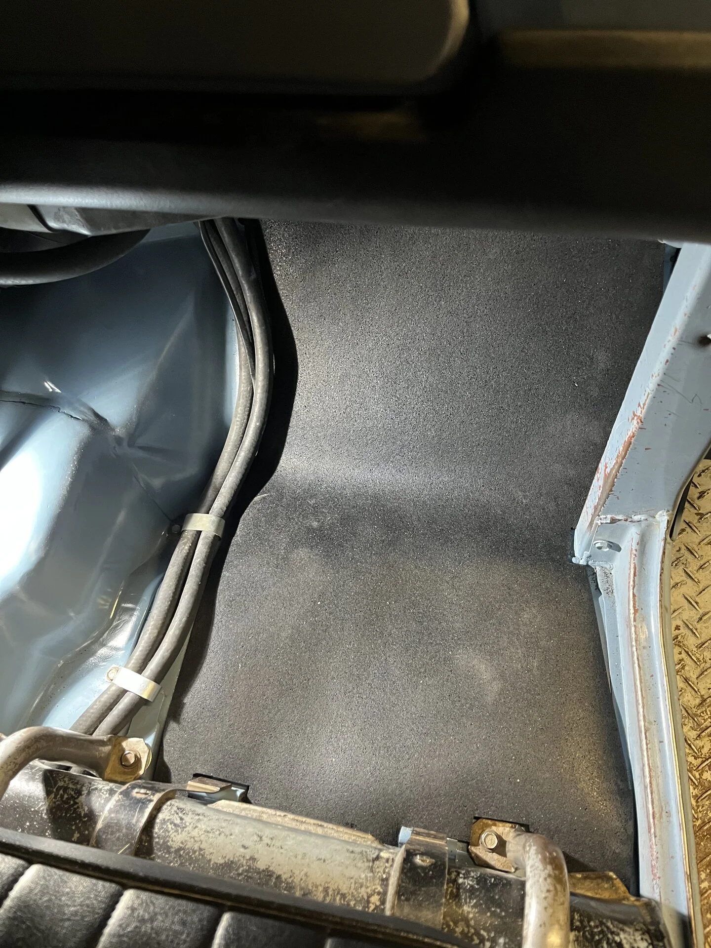

Then I started making floor mats with some material I got off Amazon. It’s like horse stall mats but thin, about 3mm I think. Pleased so far. Going to see how it conforms with a heat gun
Fronts in, need to heat gun them all to see how they react; if they’ll conform a little better. They are kind of tacky, almost like silicone, so dust sticks to them like crazy. But if they are like regular stall mats, that will stop soon. Pretty pleased so far.
