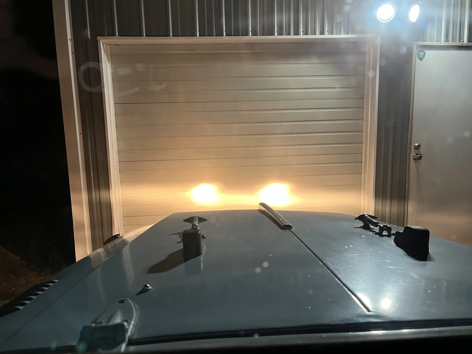

Before and after. Still need to adjust the aim.
Low beams.

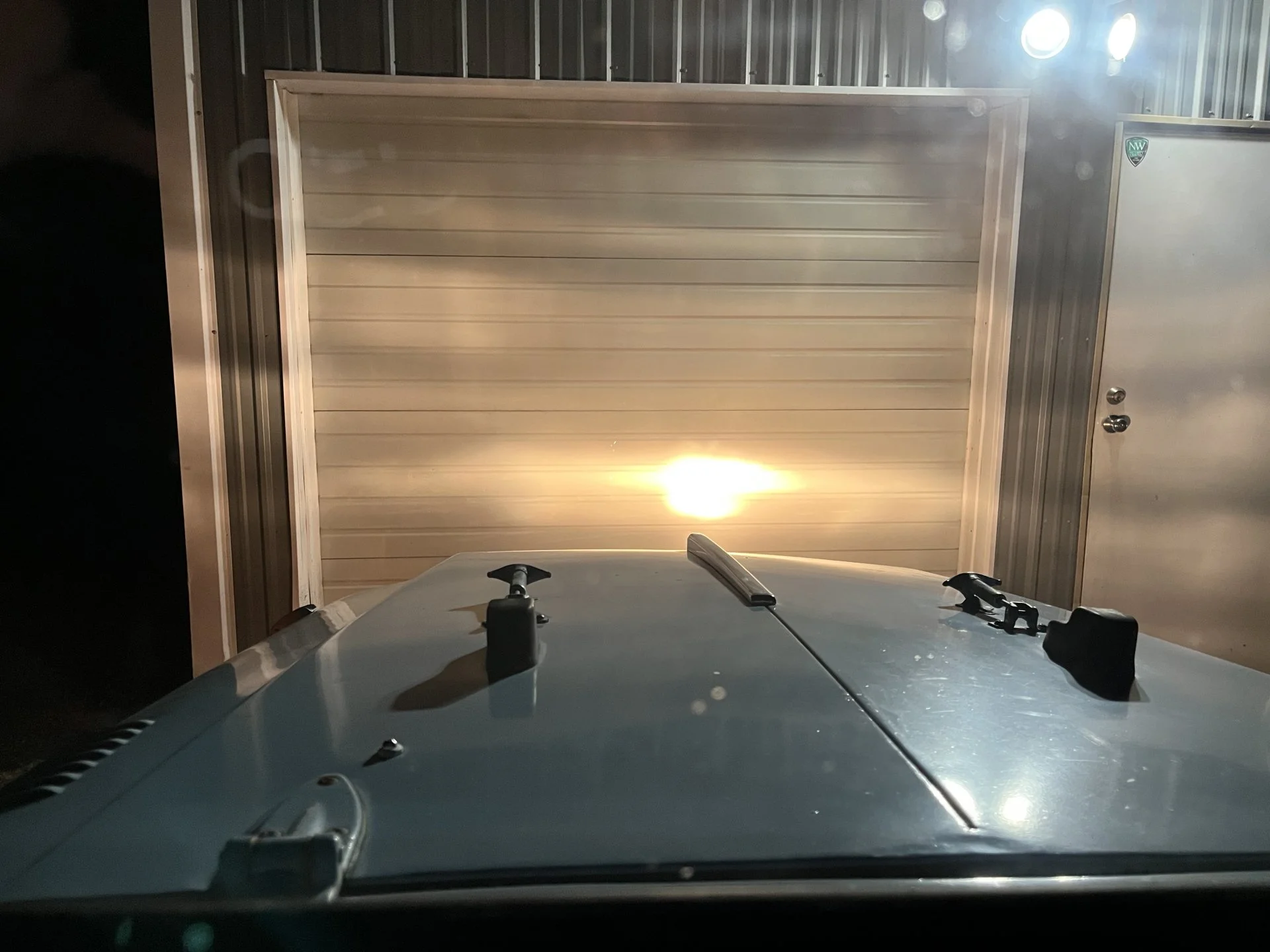

High beams.

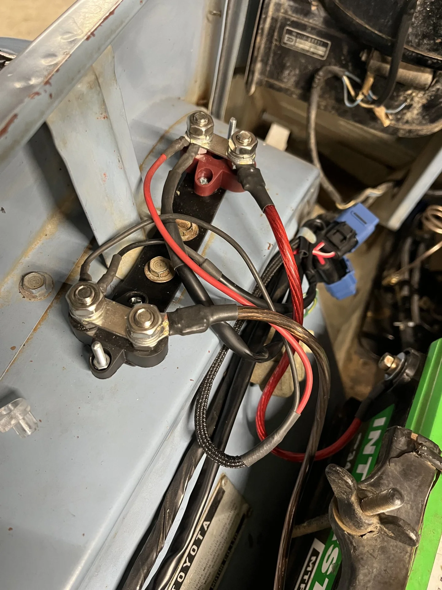

Here is the buss bars I used to wire to the battery. Bent a couple angles in a piece of aluminum bar and mounted to the apron/fender support. They have a cover to prevent accidental co tact cleaned the wiring up a little since this pic
I always feel like the low beams could be aimed a tad higher on mine, but the high beams feel like they should come down a fuz......
100% ! Glad I'm not the only one.

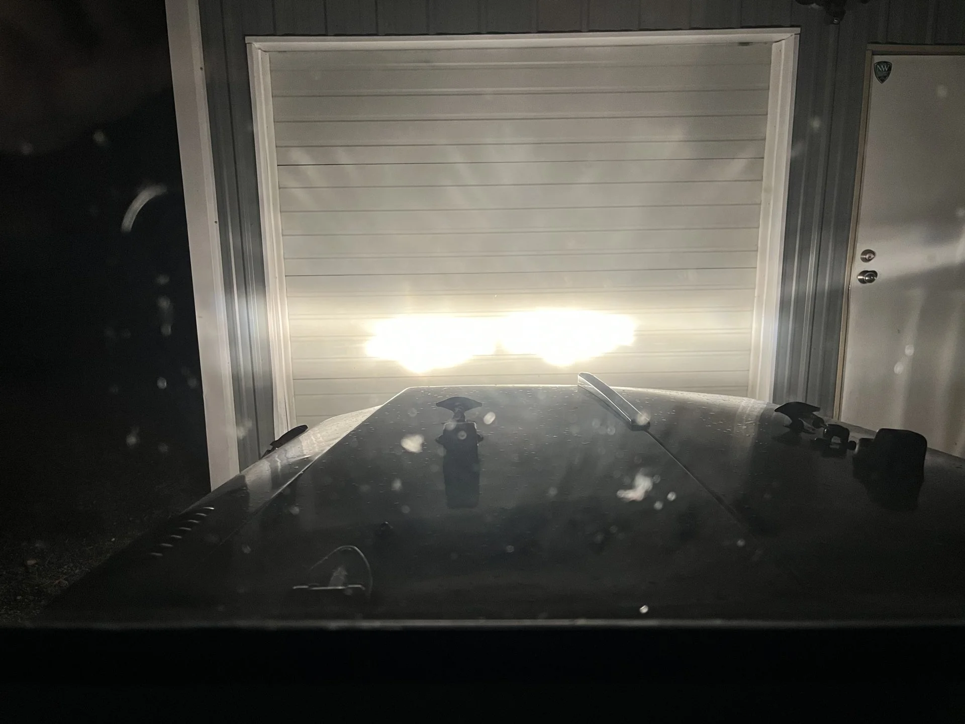

I adjusted the lights and drove it in the dark today. No noticeable difference in the cluster lights since they are led but there is a noticeable difference in the high beam indicator light and that one is not led.

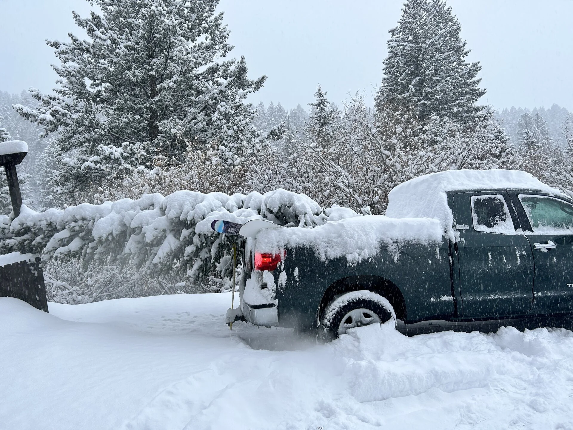

Happy tree hunting we got ours Sunday dragged it a mile out in the snow I know I’m not young anymore, but this one was a bugger
Happy tree hunting we got ours Sunday dragged it a mile out in the snow I know I’m not young anymore, but this one was a buggerView attachment 3182563
Last years tree came home on my 4Runner. Not as much room for a tree this year so will scale it back a little
