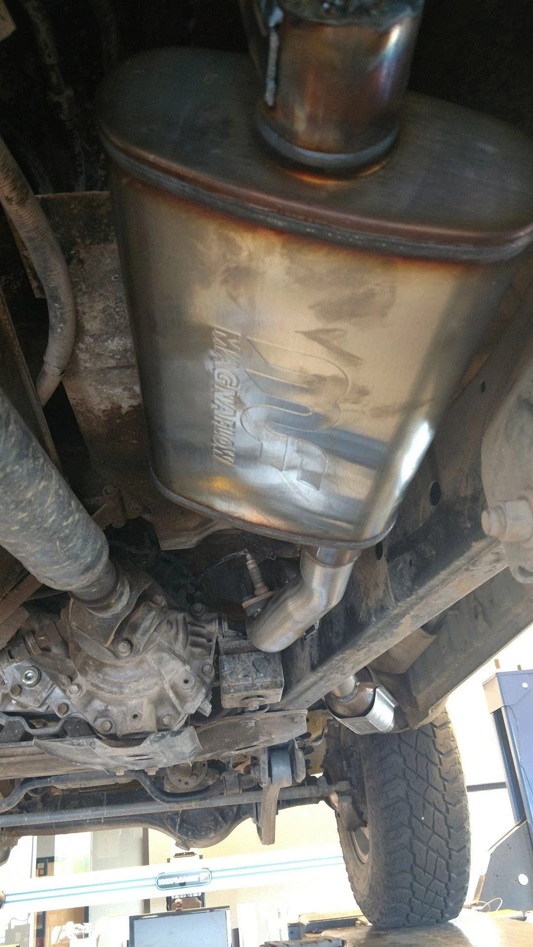

Here is what I did. Better clearance and I like how it sounds. Got to be worth 20mpg and 100hp

View attachment 1685699 Here is what I did. Better clearance and I like how it sounds. Got to be worth 20mpg and 100hp
Who did you're exhaust? I need to do something with mine.. cat is rattling like a tin can, I had to cut the resonator off, cuz I smashed it and my stock 20 year old muffler needs new bearings.. LOL
ScottyDog
Mesa Muffler! They kept it high and tight.
