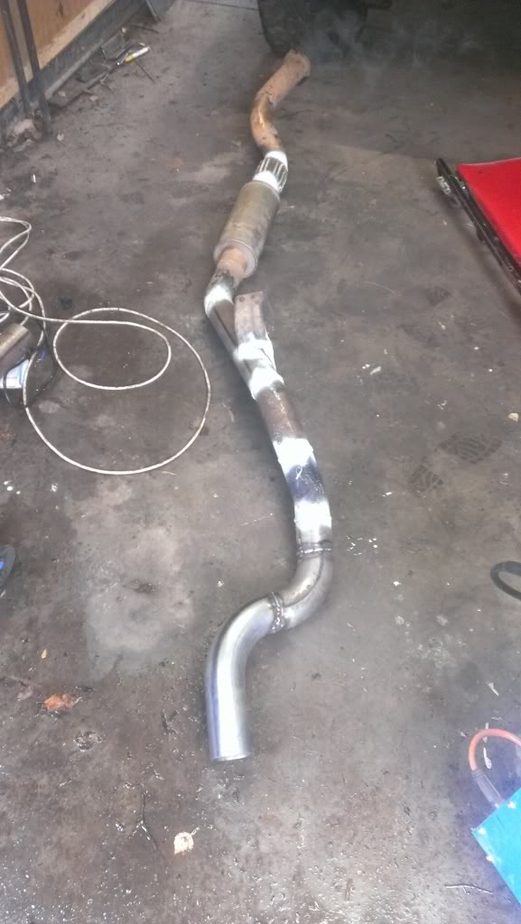

Brakes are in and working, still getting stuff done on the car for the queens birthday long weekend. This weekend I hope to finish the exhaust off, got two mounts today from work which I was happy about didnt know we made them. Also fitting new belts, suspension is mostly done except rear shock are now to short so I have to measure up some more and get some $$$ together. Ordered a 34'' light bar and starting to make the rack for it.

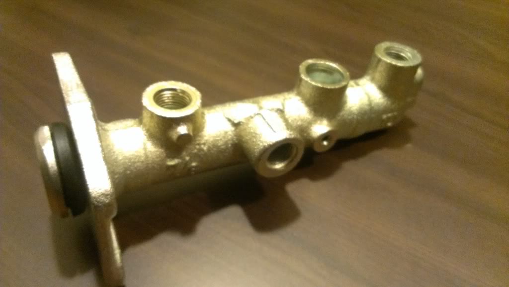

Is that a new master cylinder or is it a original bored out to 15/16" ?
Original bored out.

Been doing alot more work, since rear leaves are now 13 leaf I have found my shocks too short, just ordered a pair of EFS elite 79 series 2'' lift which match perfectly. Also nearly finished the rear section of my 3'' exhaust from gearbox to bumper. Once that is done my light bar should arrive and I can build the roof bar and wire it in. Getting close to trip ready, just over a week to go!
