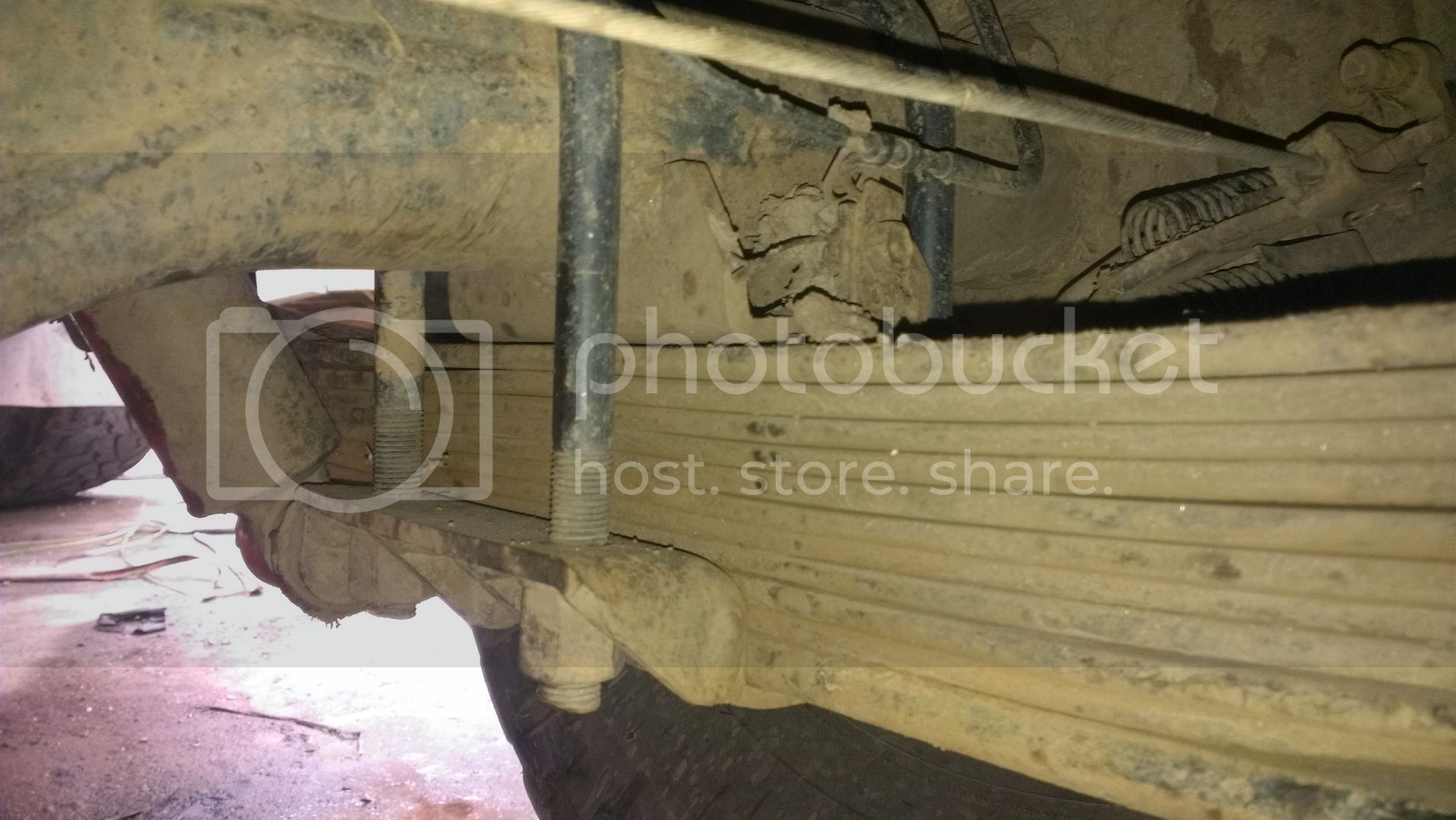

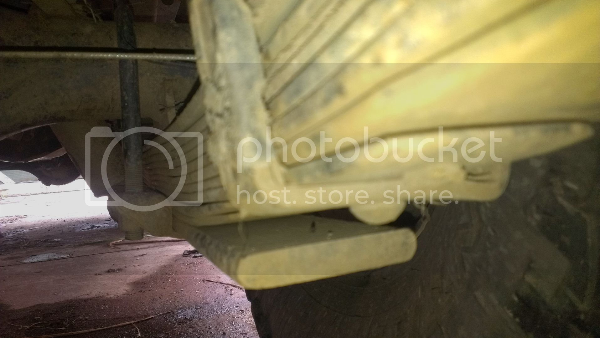

I have noticed front and rear that the springs have been sagging, after the easter trip I had a look at the rears and they are toast. Bent "W" shaped, they are a 11 leaf pack too including the overload leaf. This is the 3rd pair I have "W"'d and the 4th pair wrecked (also snapped a pair).
Unfortunately my budget is very small and I would like to improve the high speed dirt handling of the car. I'm either looking at second hand packs from the wreckers, or build some packs up from spares I have or I'm looking around for a cheap 80 series rolling chassis to coil the rear end, bummer is a mate recently sold a rolling chassis for $700, would have been perfect.
Doesn't look like the end of the world.
Coils in the rear would be a permanent fix.

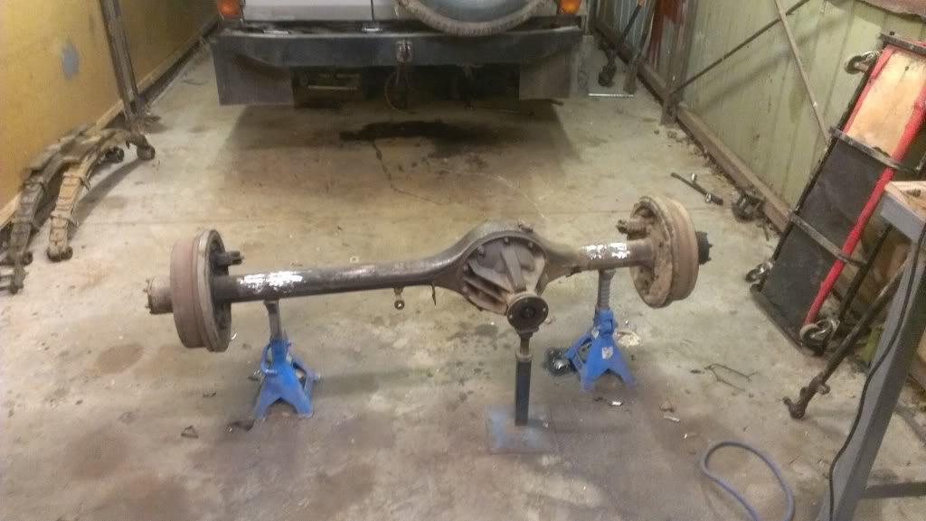

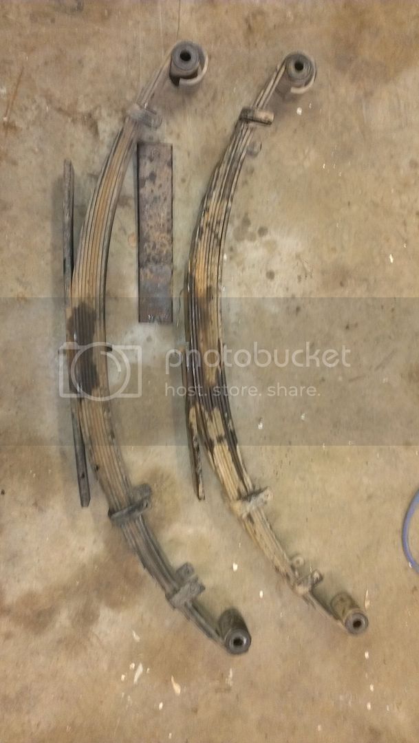

Found a big part of my problem, for a long time the drivers side spring was softer than the passenger side and sagged etc. I thought it was just worn out, judging by the break it has been broken for a long time. Pretty sure I am just going to re-use the backs with a couple of replacement leaves and load leaves.

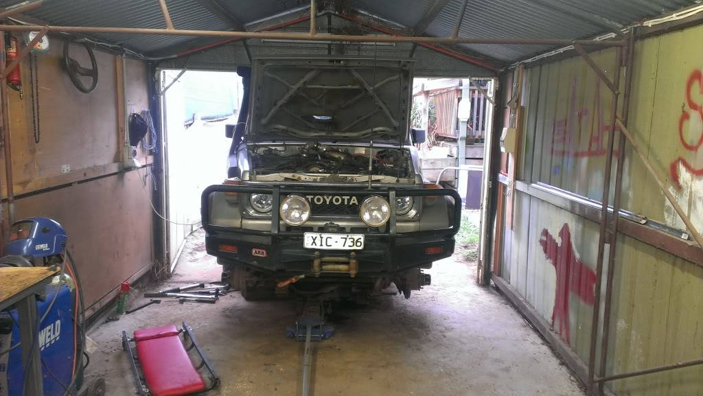

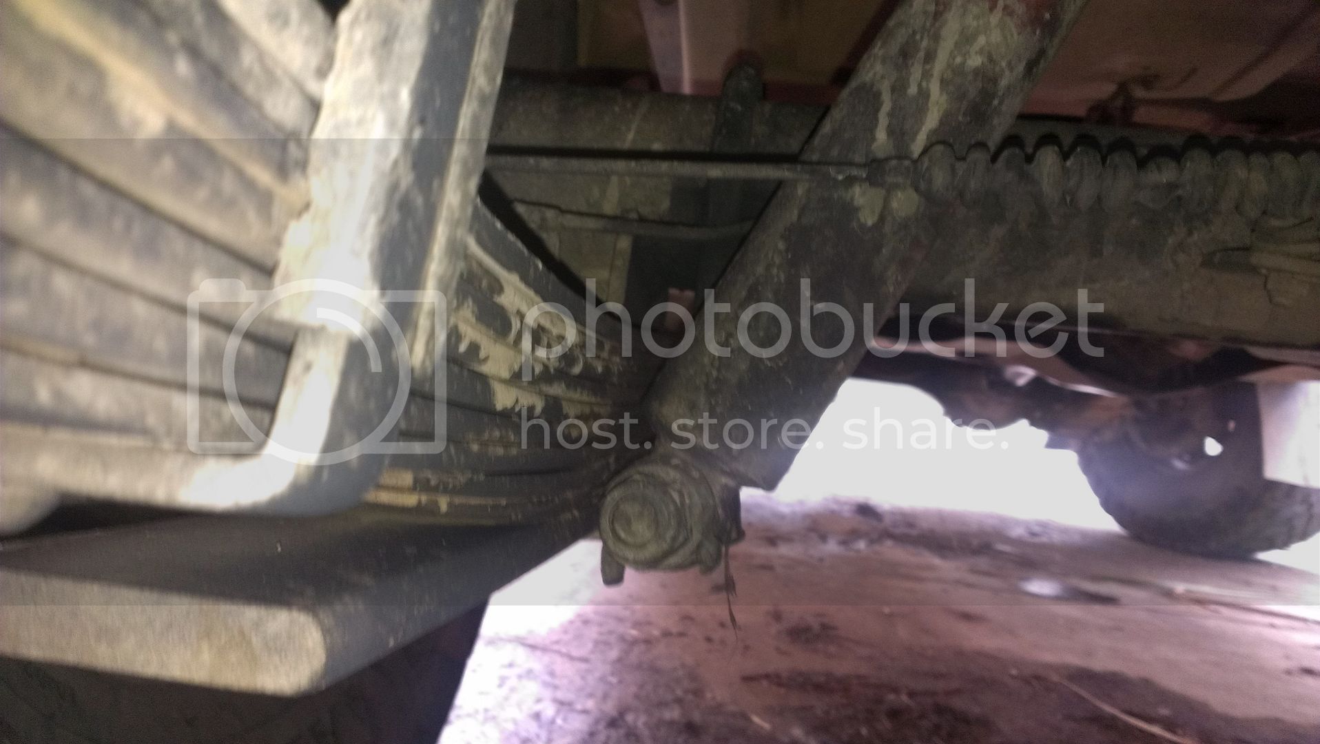

Last weekend I re-did the front leaves, new leaves added and fixed some steering issues.
