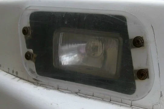

Howdy! If you mean the ones next to the rear side marker, mine are open thru the fender. If your talking about the ones over the front wheels, mine are fake steel louvers. I swapped them for clear plexiglass and mounted "parking" lights inside. Not real effective, but fun to blind other drivers with on the streets. John

Neat, got pictures?
