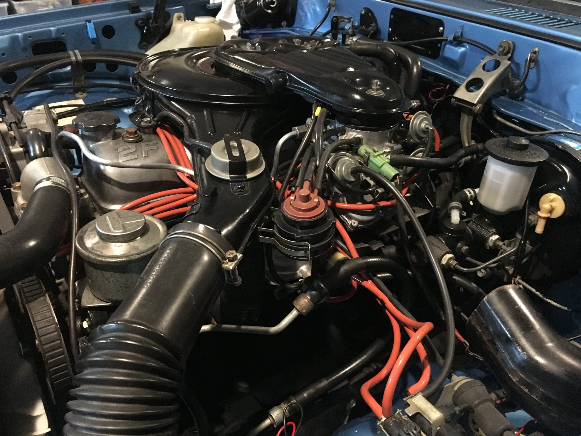

85 FJ 60, 2FE, H55, 62 axles
@Spook50
What's the diaphragm on the drivers middle fender? Cruise control?
What's the red box?
And could you give some details on the remote oil filter on the back passenger firewall? Curious of all the different mods.
Yeah the diaphragm is the actuator for the cruise control. I haven't been able to find any documentation on the kit that was used beyond finding out that it was apparently made by Dana. I think it was a dealer install because it was done very clean and for many years I thought it was factory, until I learned it wasn't a factory option on 62s.
The red box is a Mallory HiFyre 6A that I put in maybe ten years ago or so. It's a capacitive discharge system that piggybacks the factory ignition. I still have the stock igniter that feeds signal to it, but now the Mallory box controls the coil (which I also replaced with a Mallory Promaster several years back).
The remote filter is actually a moisture trap for an air system that I use as a PCV catch can. Here's a thread I started when I initially installed it: PCV catch can; homebrew Condensator writeup

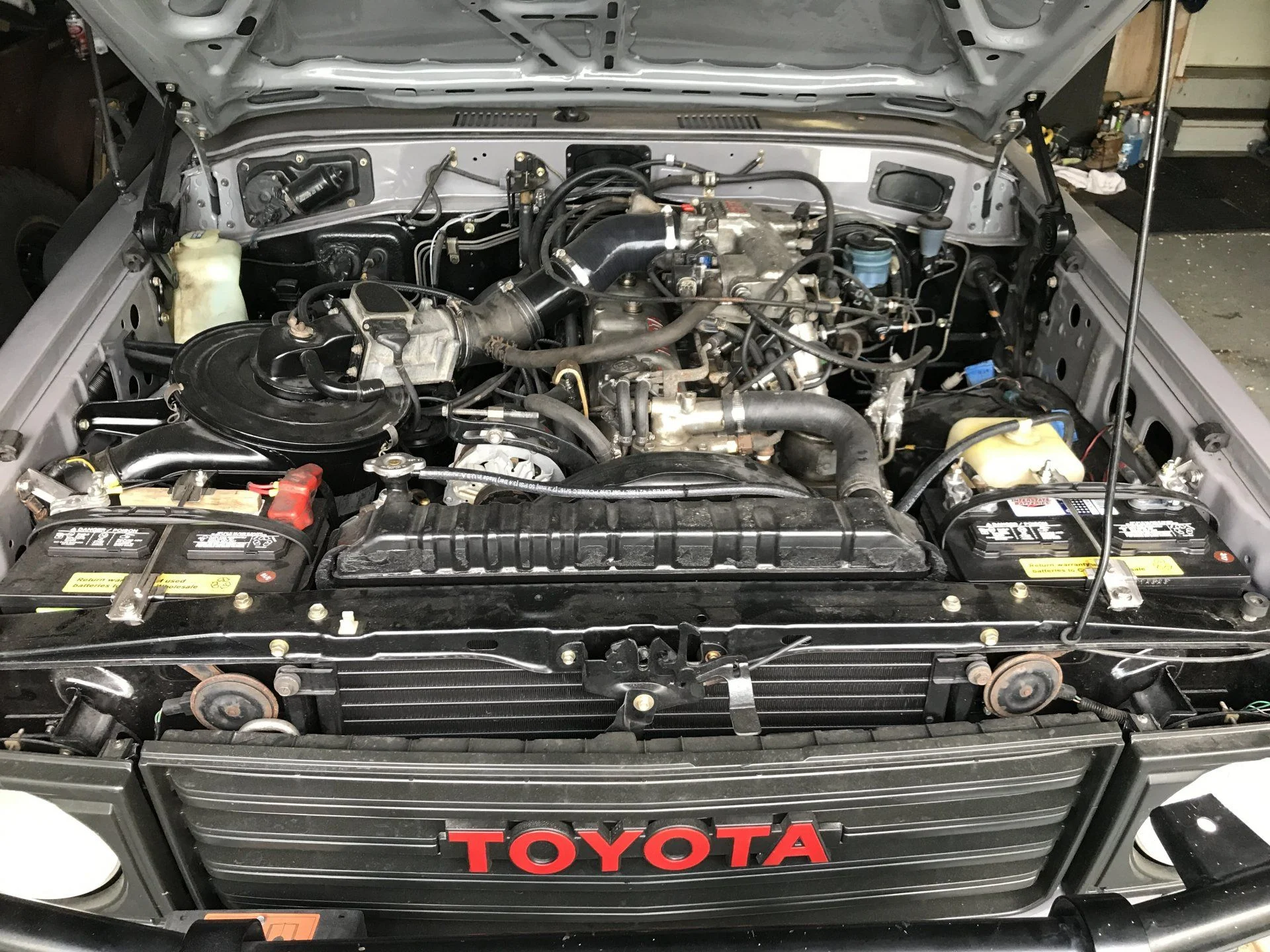

1987, 2f, fully smog with custom snorkel intake.
