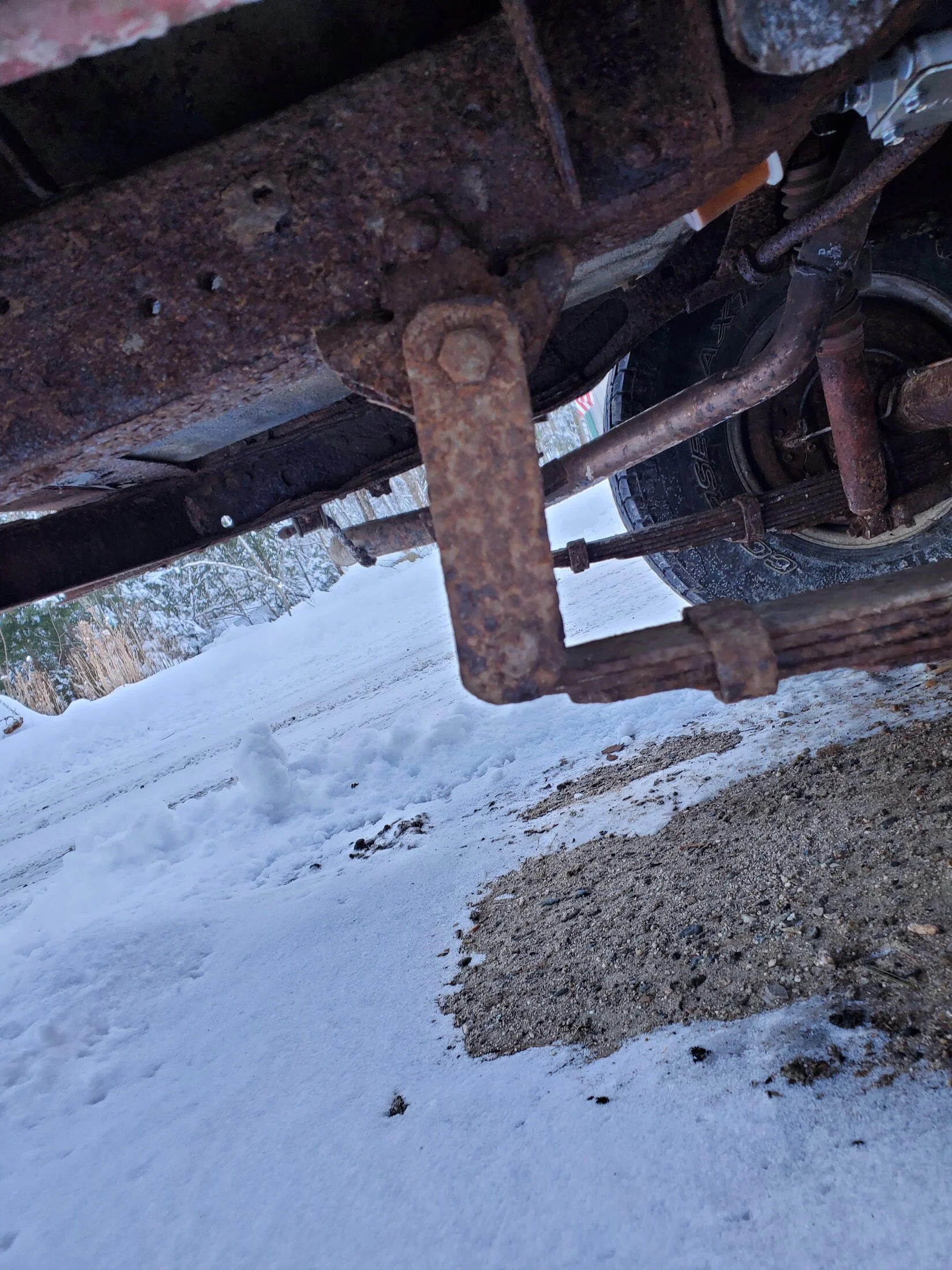

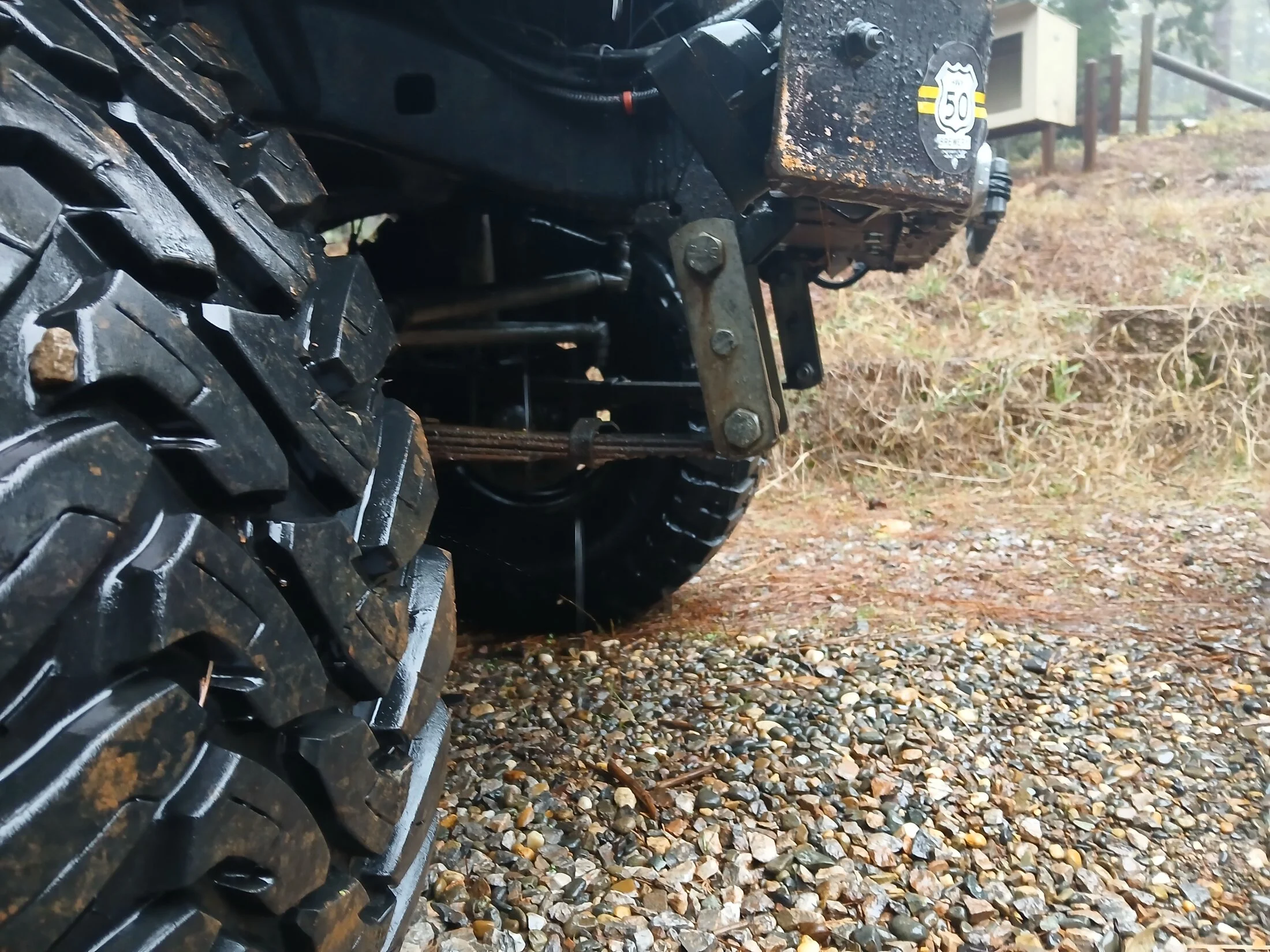

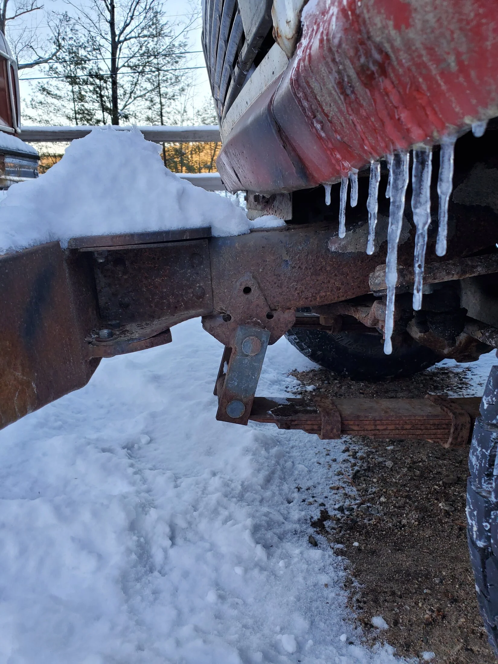

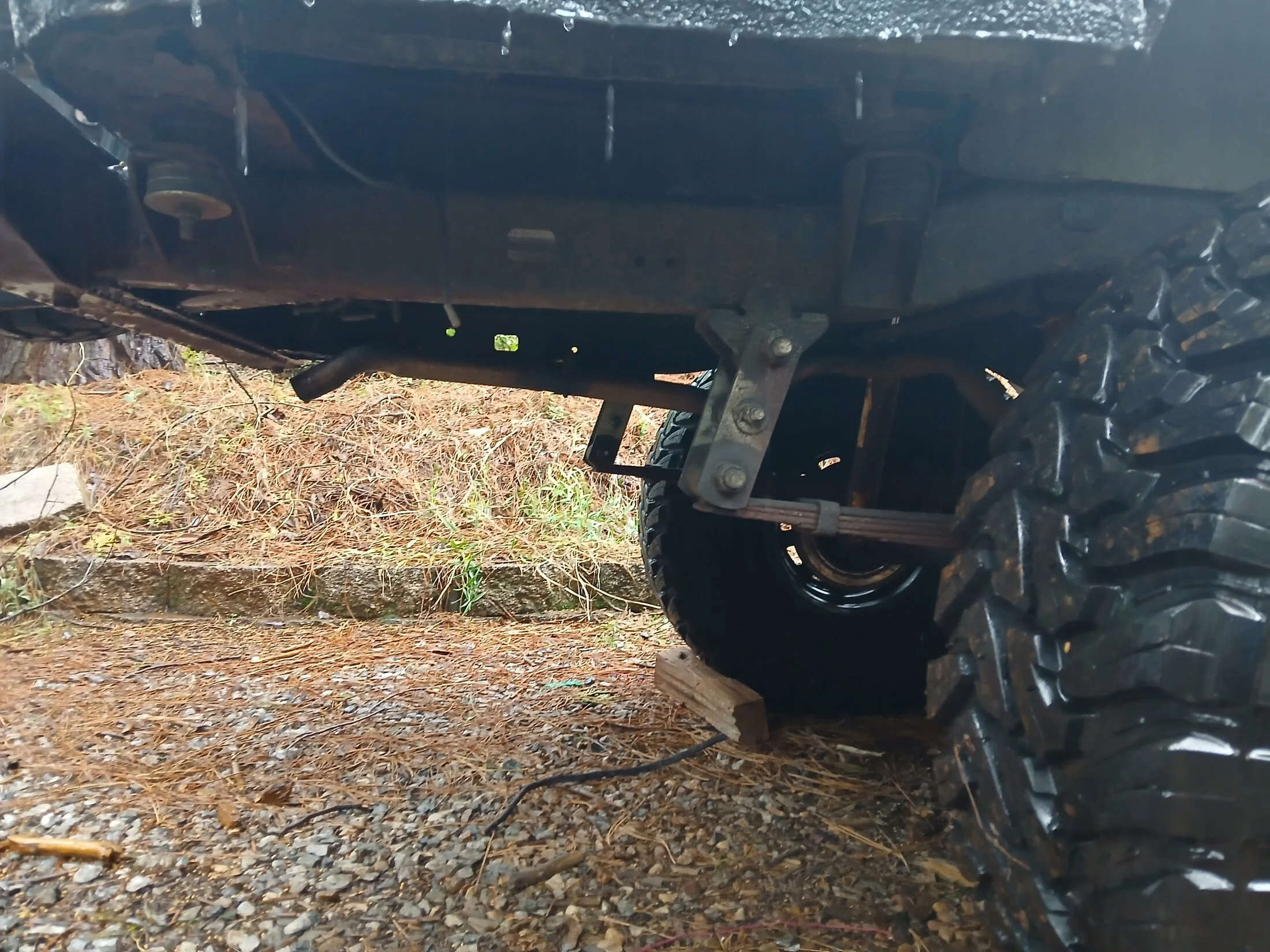

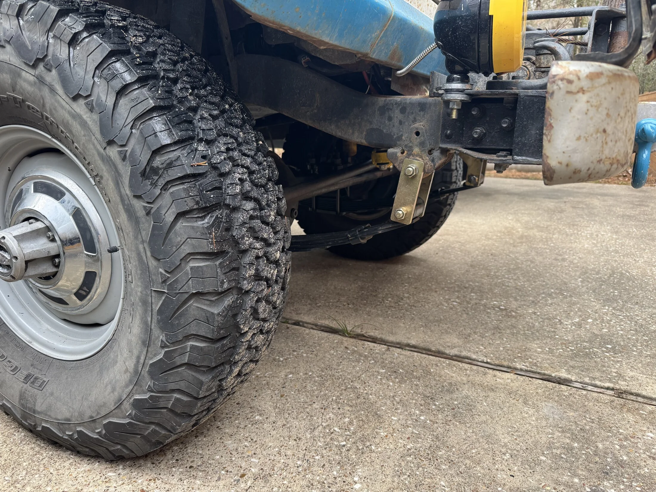

Show us you Sweet Shackle angles 🤣🤣🤣🤣🤣
bobm
WTF, dat mean. 🐖👈
Oct 20, 2010
96
12,465
Land of the Free/Home of the Brave
Hair B mine 😘. Ya I'm ****ing bored.
Been plowing Snow all morning 🤪🤪
Howbout you rotate your potato phone just a bit more so no one has any clue what is level or 90° just some rusty shackles floating in mid air at random angles!!! 🐖 👈
How bout you rotate dis 🖕and dat not rust it Imaho potater dust. So b4 you jump on my 💩 post ya crooked 🐖👈🍑👈 Shacklees angles 🧁🤔🧐😳😲🤪😉😘🤣🤣🤣🤣🤣😘😘 Biatch 😘🤣🤣🤣🤣

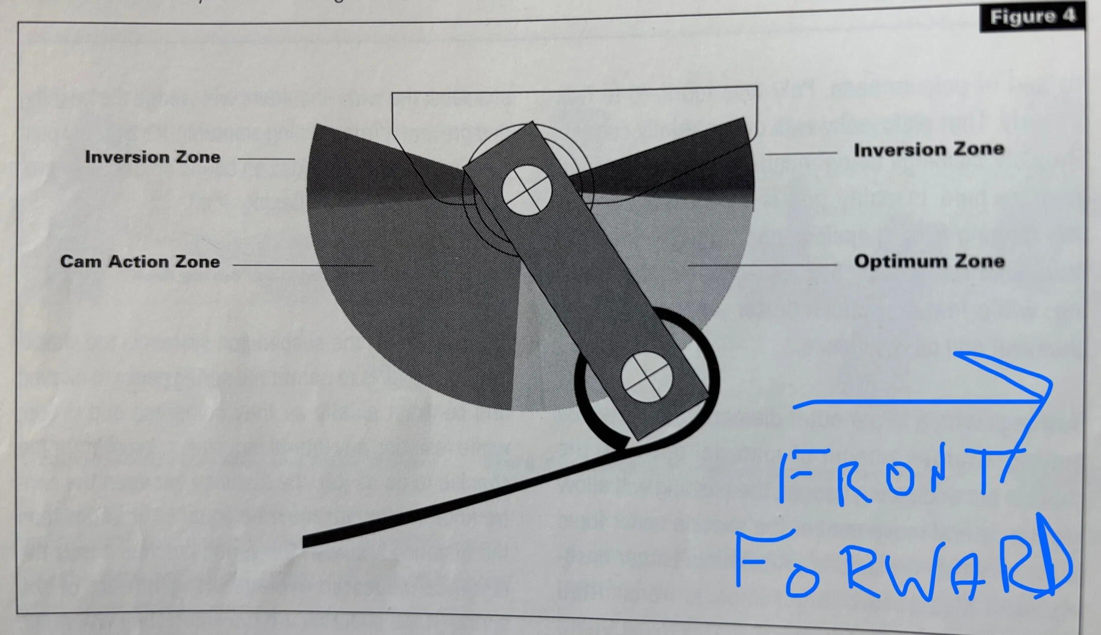

We really need to come up with a weight based formula, the setup is what varies here. Bumpers, winches, motor swaps all play into spring length and therefore shackle angle. Prolly why it’s so hard to provide off the shelf kits (especially if designed for 4Xs). Something like if your front axles weight is between x-y buy Dakar or Ironman, y-z look at Dobinson etc for quick reference. All bets are off on outside those, should go custom.
