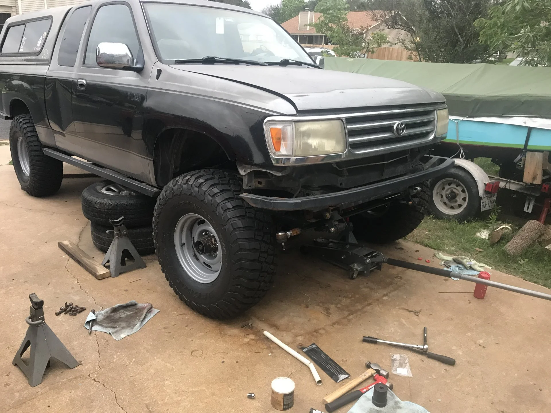

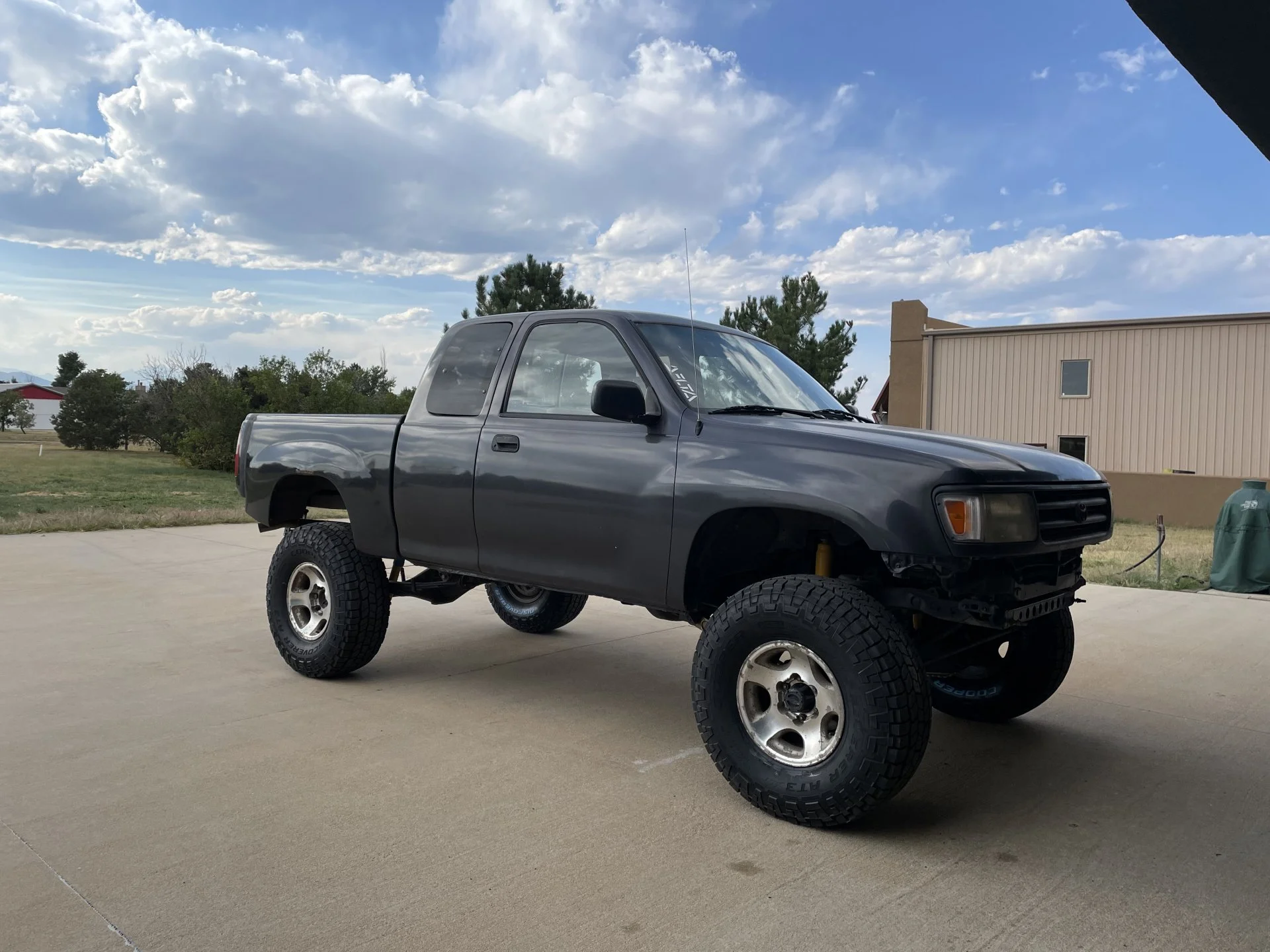

Man, there’s a lot of 1 off T100’s out there. Probably cuz nobody makes fun stuff for them. I’m here cuz I just got an Lx 470 and love it. But I’m in the middle of a SAS on my 96 t100 too. Always have something going on, I guess. Maybe don’t make fun of the 10 bolt tho…. I’m poor. But here’s a few of her. 4.56’s, 35km3, front axle forward 2.75”, blazer leaves, custom shackles forward, custom spring & shackle mounts, steering box forward 2.25” mounted to .25” plate custom frame stiffeners from A pillar body mount forward. Instead of buying all the premade stuff, I bought a 4x4’ 1/4” plate and a plasma cutter. Feels good but takes 4 times as long to do everything. 😂
Absolutely has an old Land Cruiser vibe with those wheels and that paint scheme. I love it. My uncle has a T100 I've been trying to get off of him for years but it's just regular white paint and still stock wheels.
Rattle can is your friend! The wheels are k5 blazer look alikes. Another tribute to the donor of the axle.

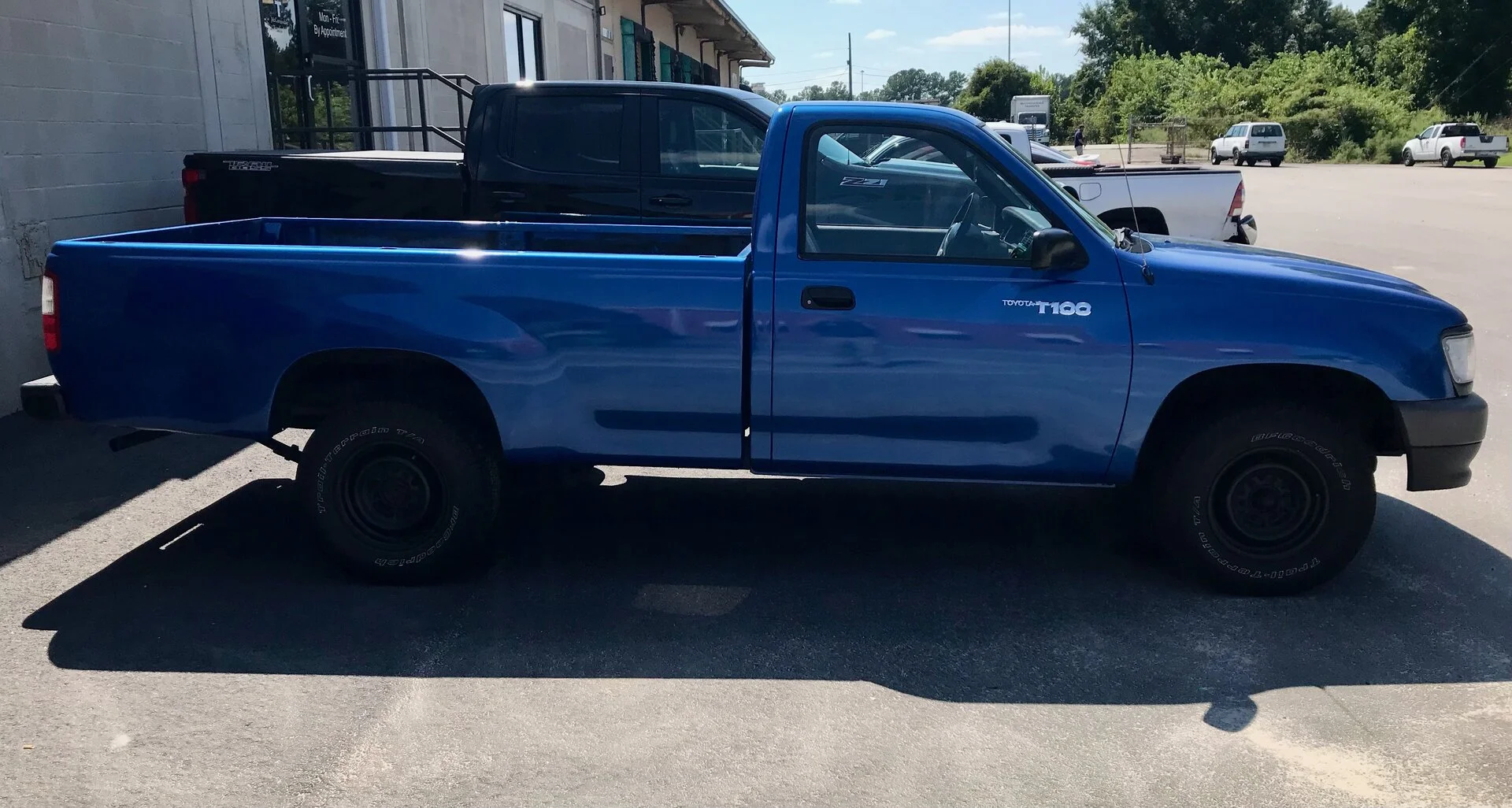

Here is my all stock, other than wheels and tires, 1996 T100. 395k on the ODO. I inherited it from my father after his passing several years ago. I'm proud to have it and have been gradually been replacing worn out parts. It cranks right up after sitting for weeks and drives pretty well, all things considered. Very impressive.

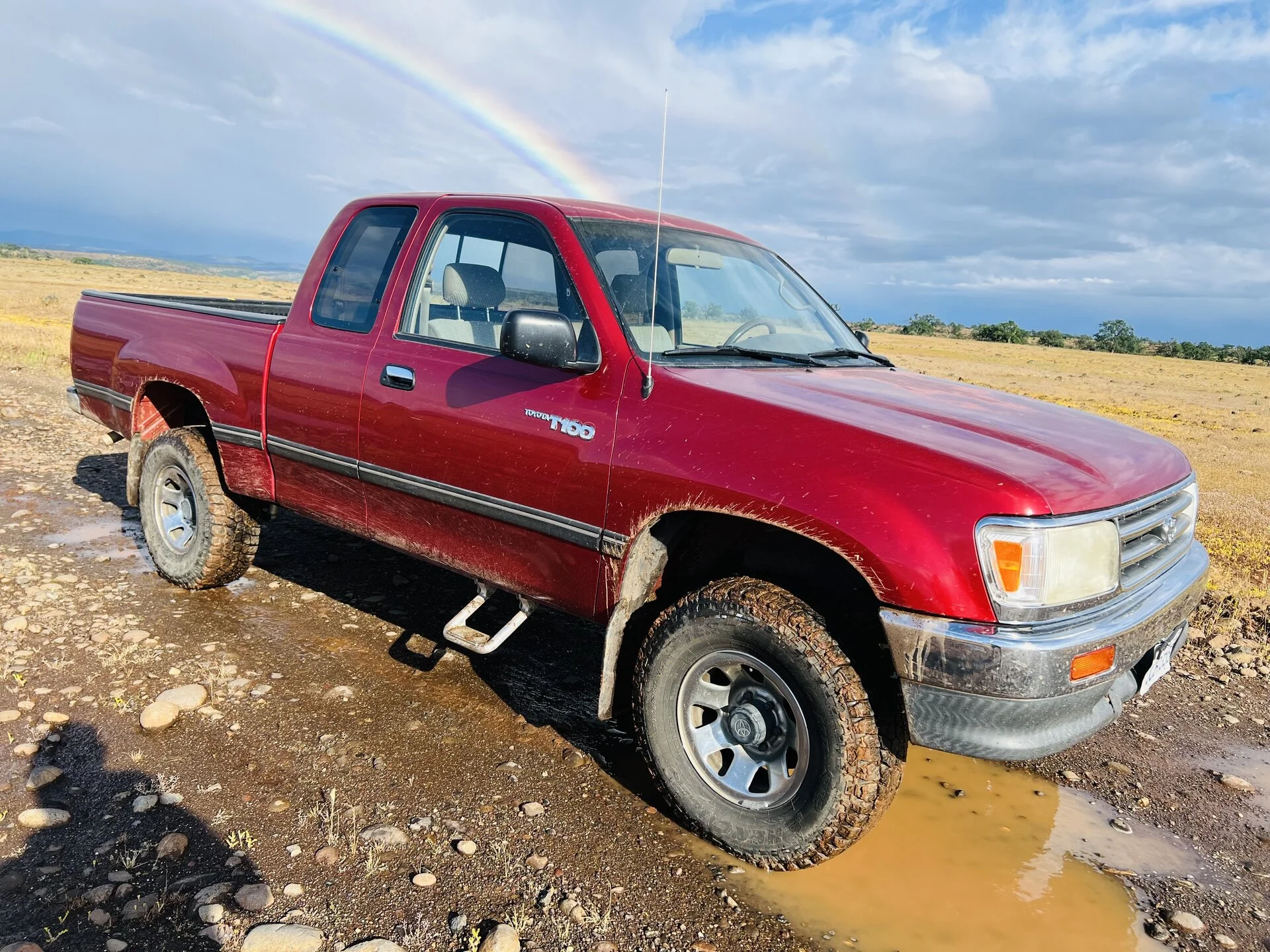

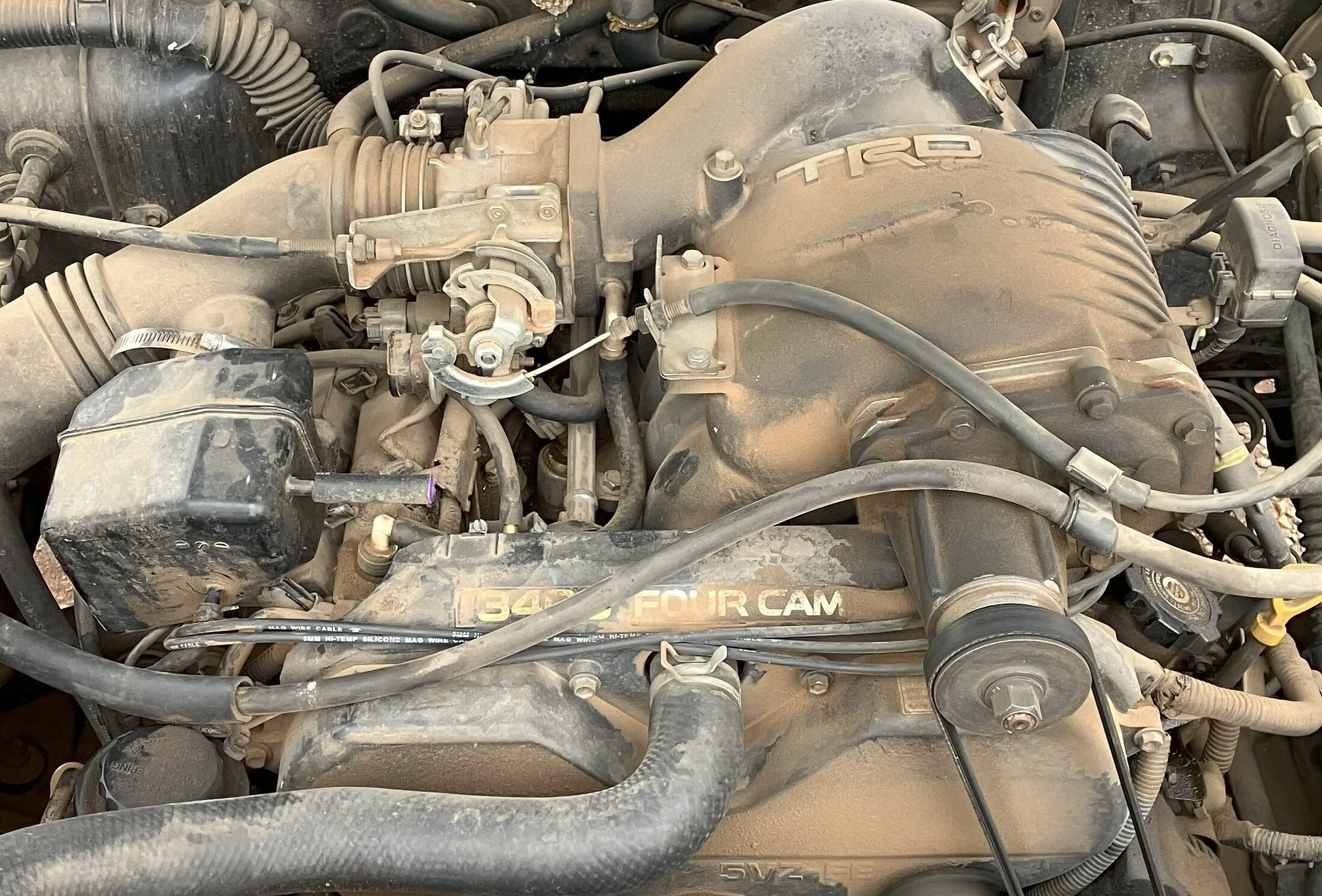

Fresh engine, fresh supercharger, 4wd, manual transmission, extended cab, and patina of a bygone era.
