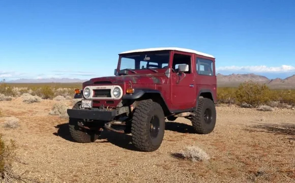

tall skinny on 4" lift...this was my rig MANY moons ago ... 4" skyjacker w/conferr rear shackles and front SR... the 34x9.5's on 15" oem steelies is the same size as most 35" tires :meh:
I like the look with those tires :cheers:

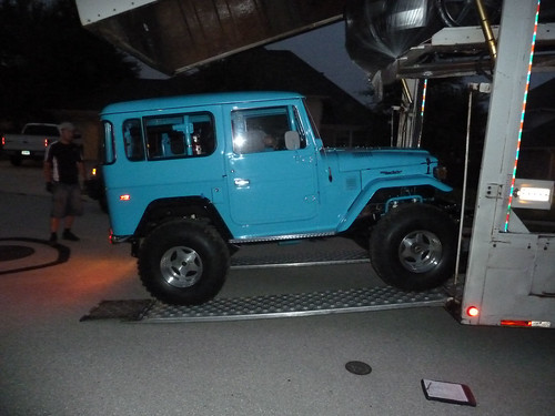

When I first bought my rig it came with a 4 inch Spring under lift and 35 inch tires (12.5 inch wide) on some aluminum rims that had been bored out for the FJ40 axle hubs.

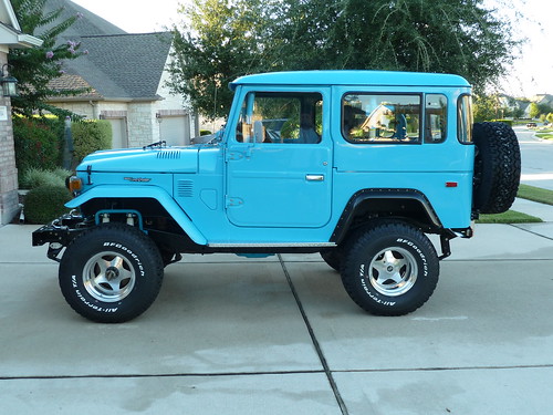

The tires were too wide and had bent the tub and were hitting the inner tie rods on full turn to turn steering. So I swapped out the rubber and rims for 33 inch tires and stock steelies:
