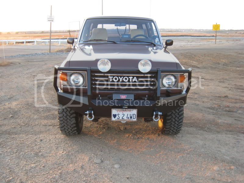

The front bumper was fashioned after the ARB, but is a lot stronger. I have seen more than one truck dissabled due to a dear strike. I figured this would help. A friend of mine built this for me.
[URL="http://i144.photobucket.com/albums/r170/fj60/001.jpg"][/URL]
[URL="http://i144.photobucket.com/albums/r170/fj60/004.jpg"][/URL]
[URL="http://i144.photobucket.com/albums/r170/fj60/IMG_3784.jpg"][/URL]

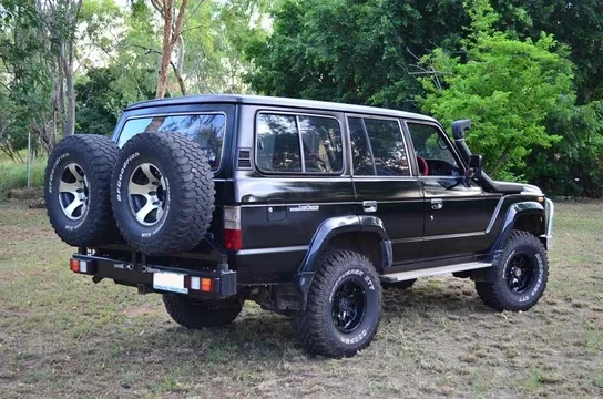

The rear bumper was built by AJ @ Bent Up. It has a swing out with highlift jack holder and fuel cans. Also has quarter protection and can double as an air tank.
[URL="http://i144.photobucket.com/albums/r170/fj60/IMG_1379.jpg"][/URL]

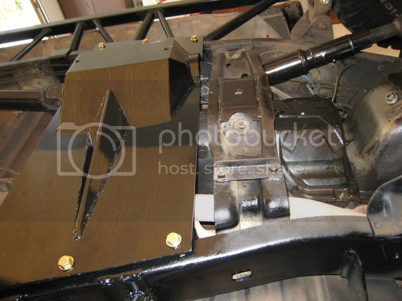

A bit off topic but a close friend of mine fabbed up this trans protection plate as the stock one is a bit on the weak side and H55's are not cheap so I wanted it protected well!
[URL="http://i144.photobucket.com/albums/r170/fj60/IMG_1478.jpg"][/URL]

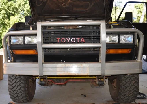

I would want to have this smooth, shining, polished bumper for my Sequoia. You really did a nice work on your front bumpers. I've seen one in an online shop(see Replacement Toyota Truck Bumper). I'm still not sure if I'll give it a shot but it is worth the price.
custom built

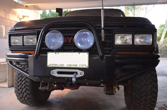

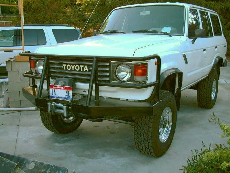

Here is mine: from $80 in steel...most of it from 1/4 and 5/16 I-beam & 3/8 Angle. Tubing is from my well 1 1/4 Sched 40.
Front is 4" channel.
Top plate is 1/4 steel.
I't's a bit overkill, but I don't think it will ever bend.

My custom homemade rear dual tyre carrier
