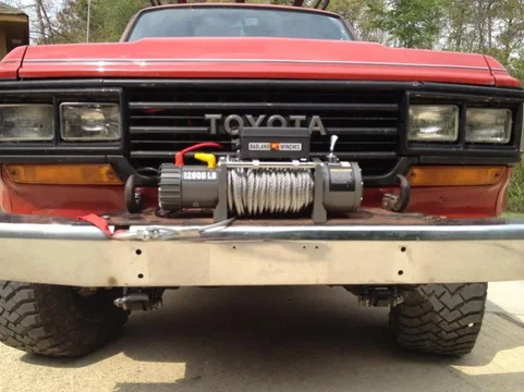

This is my OEM Custom Winch bumper :) extended and reinforced mounts on a fj62 bumper with an added winch plate on top :) I love it! It looks factory and adds the ability for a winch, I'm going to be building a bull guard here soon!
