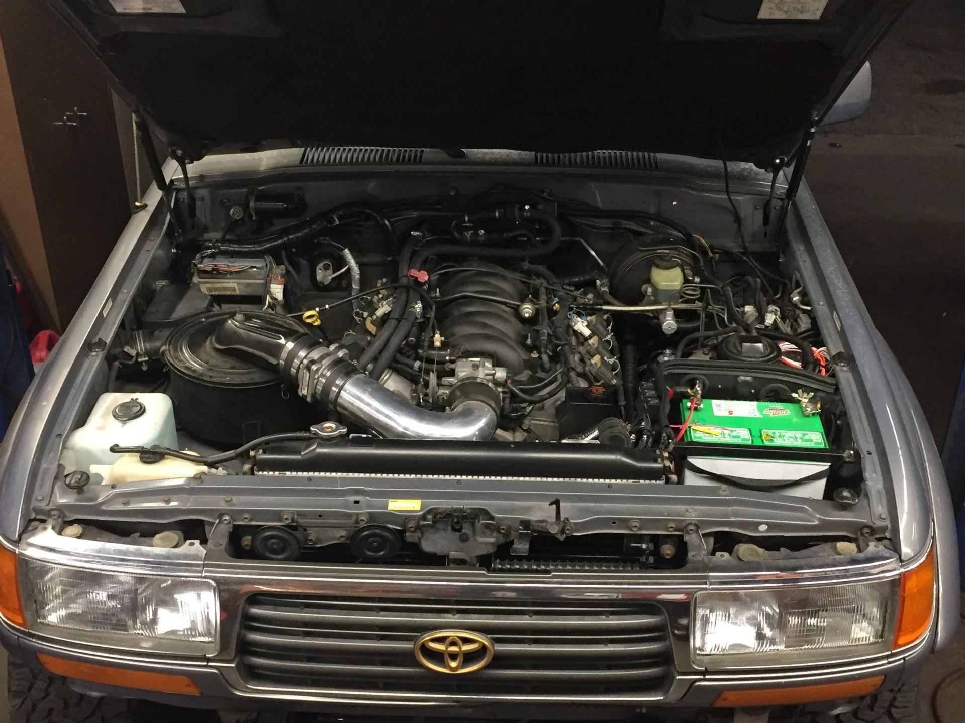

Here are some finished engine bay pics, prior to the second battery install
