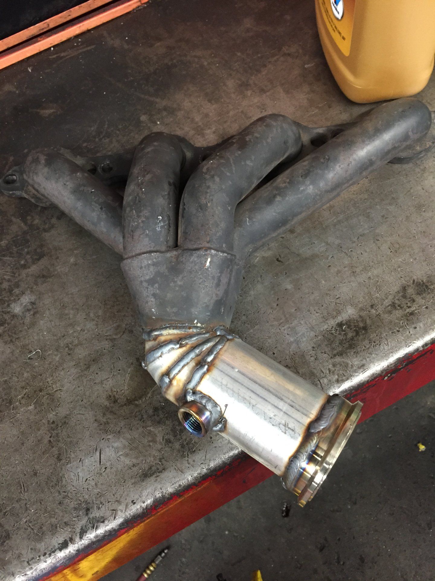

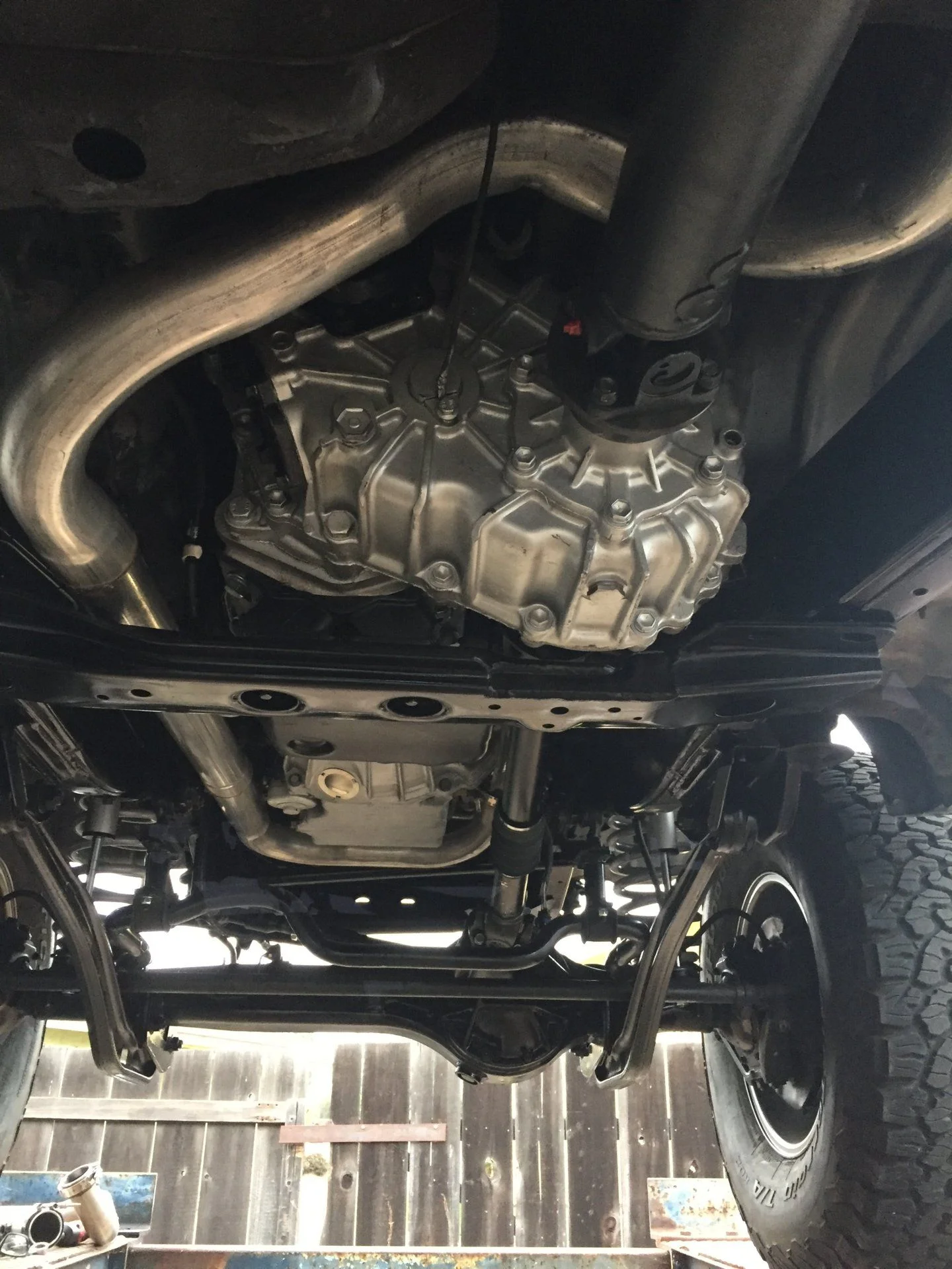

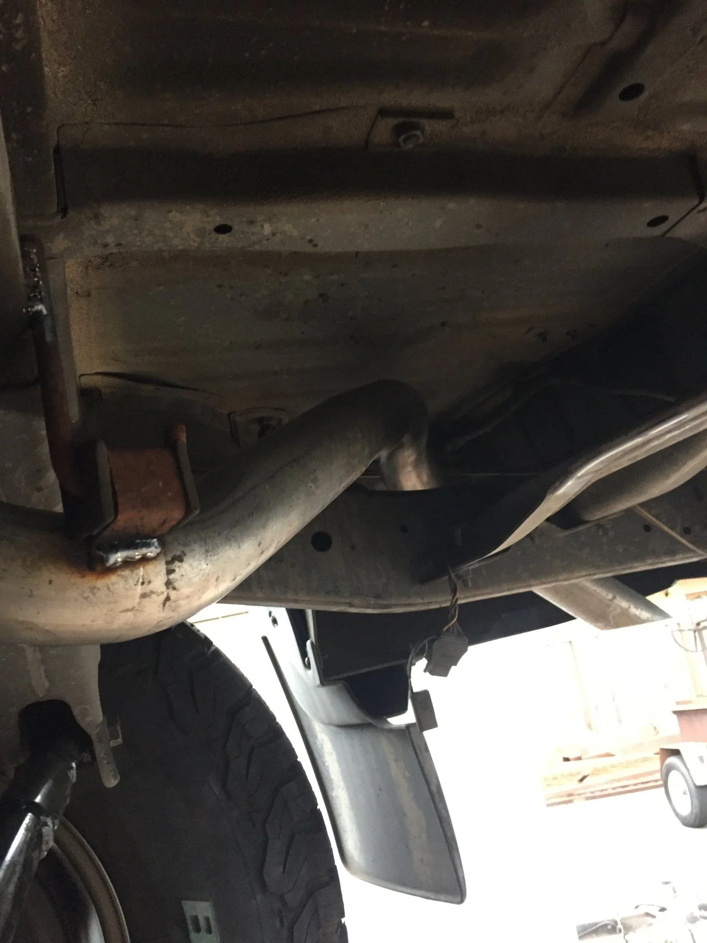

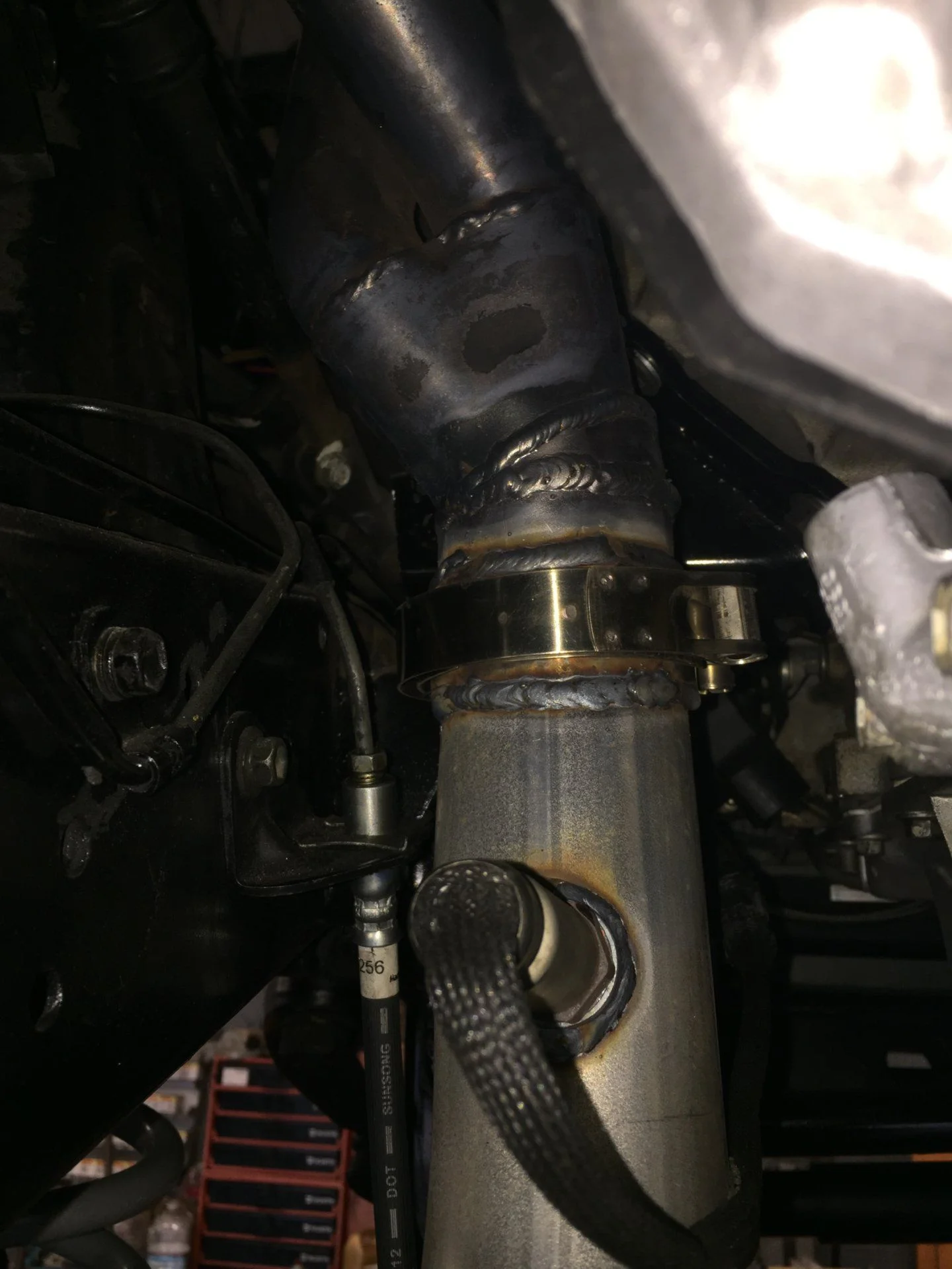

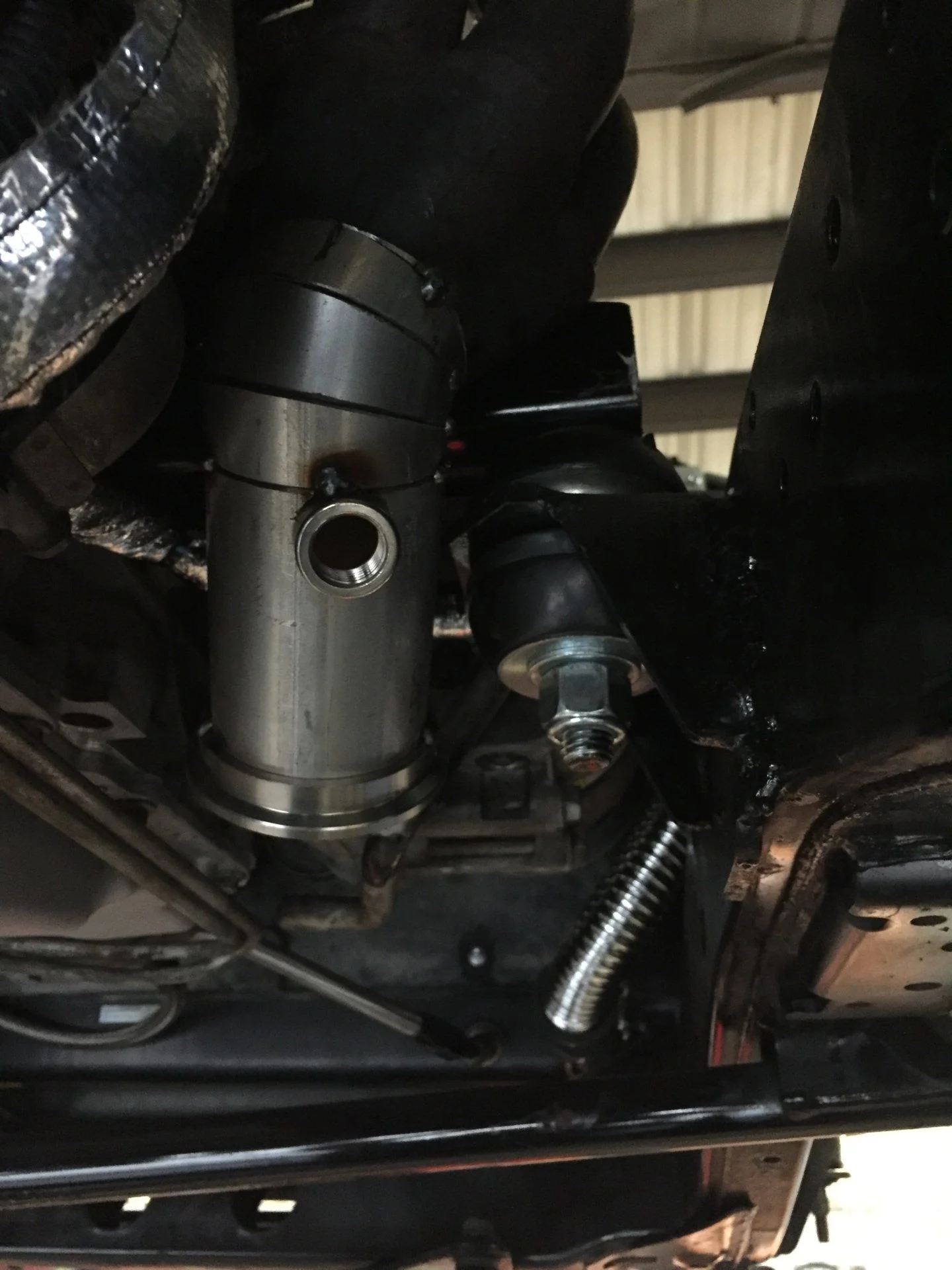

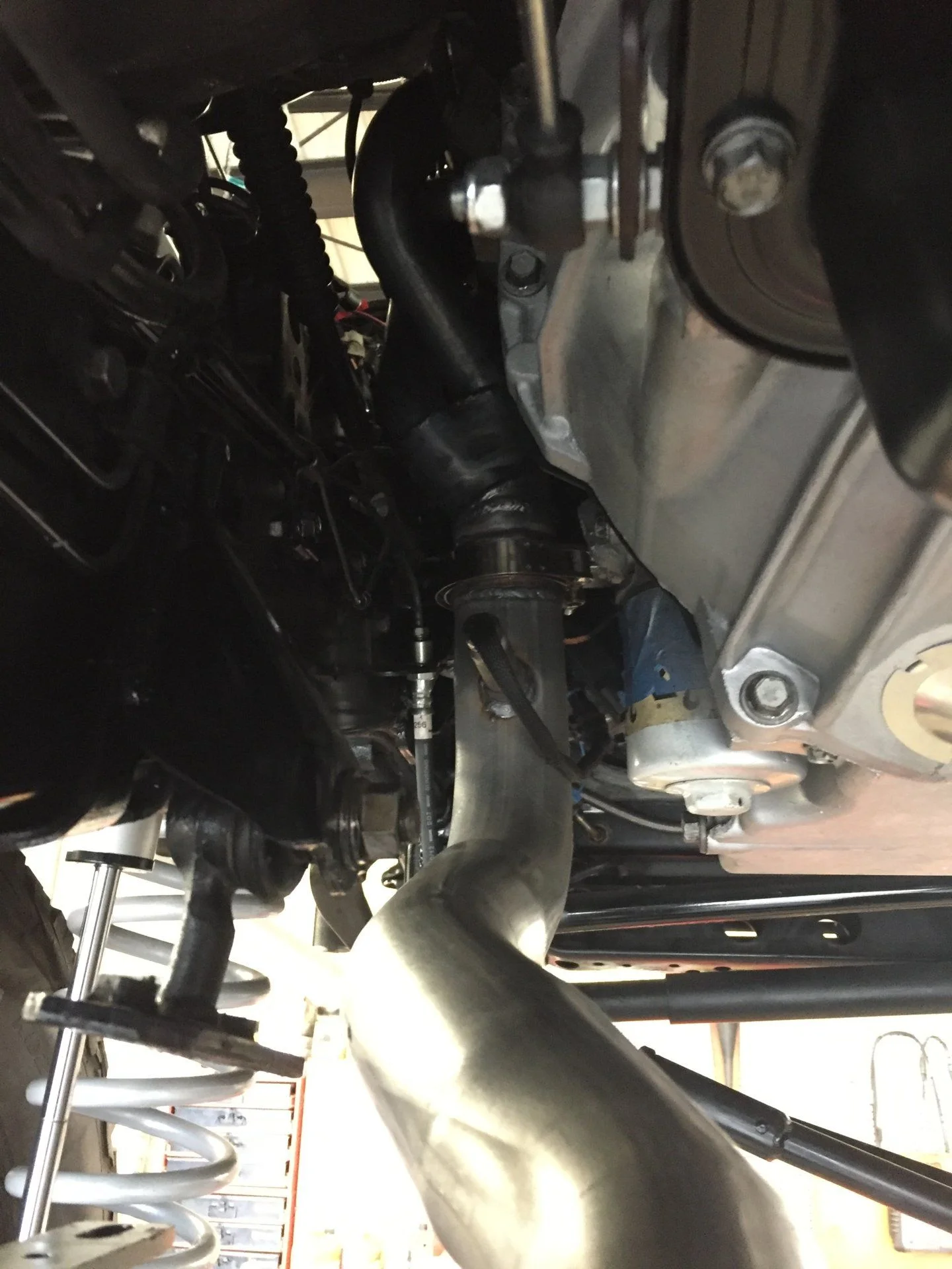

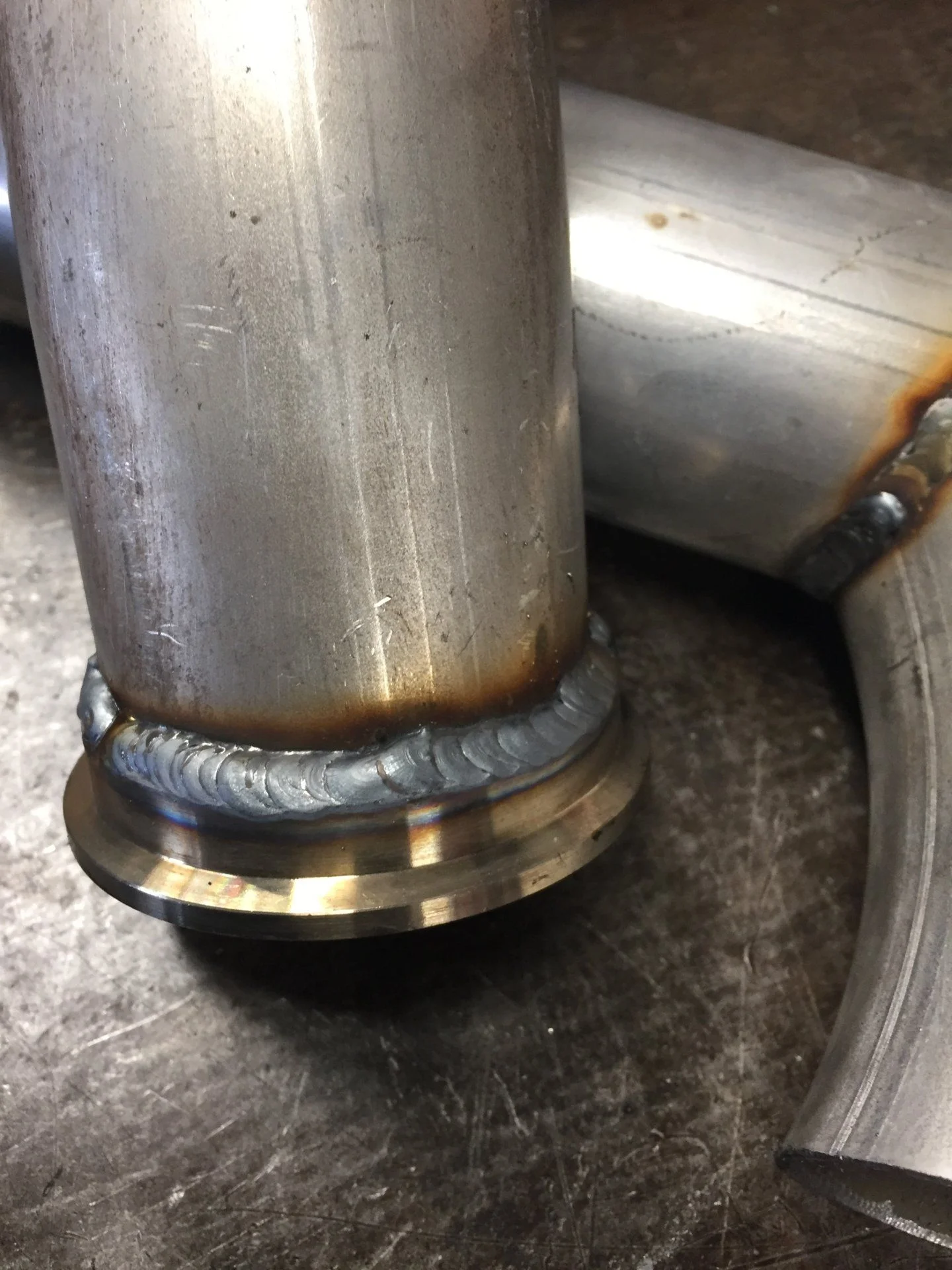

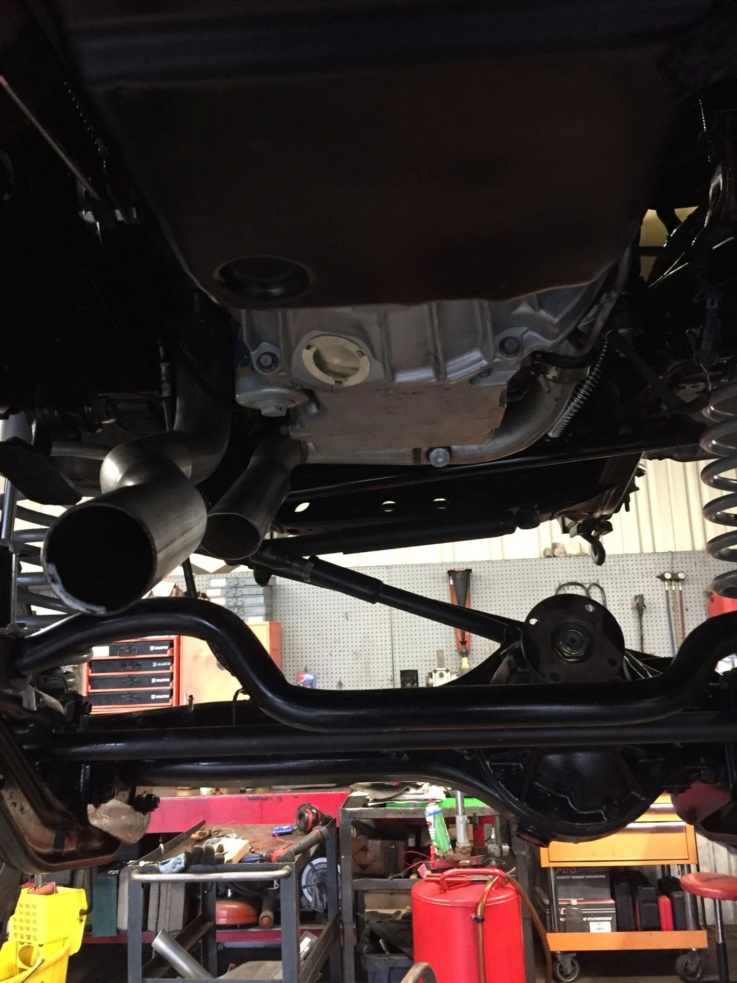

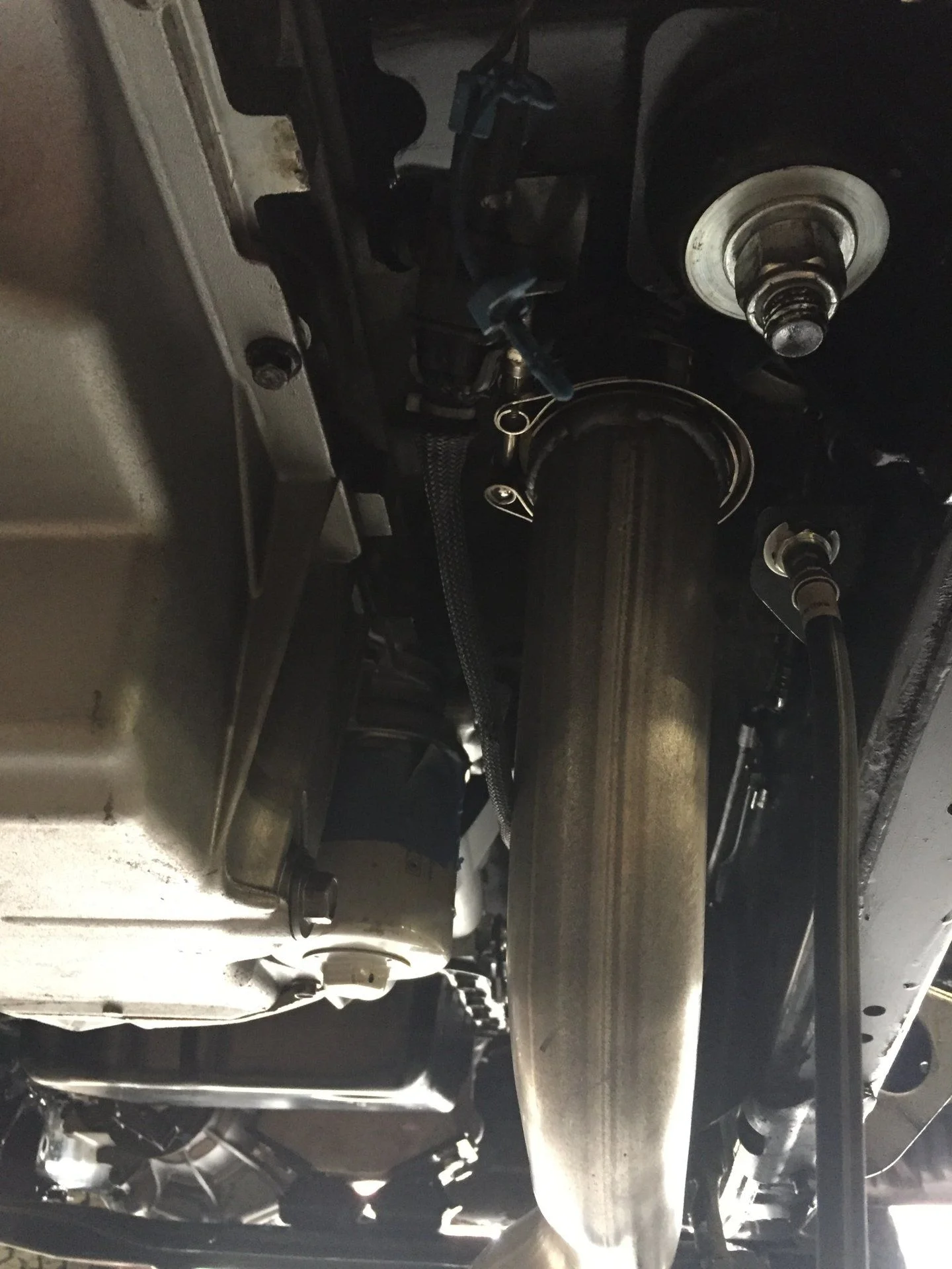

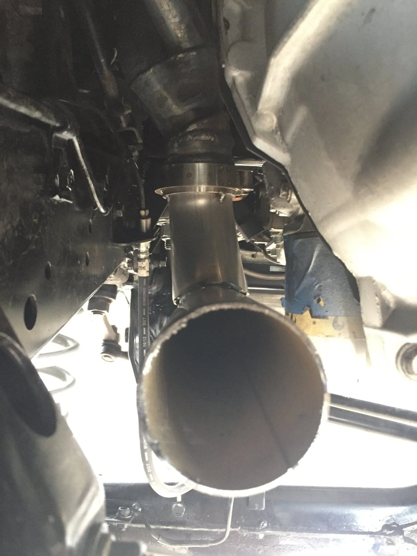

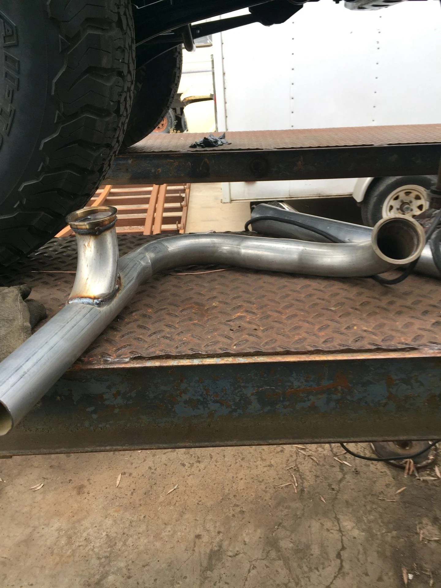

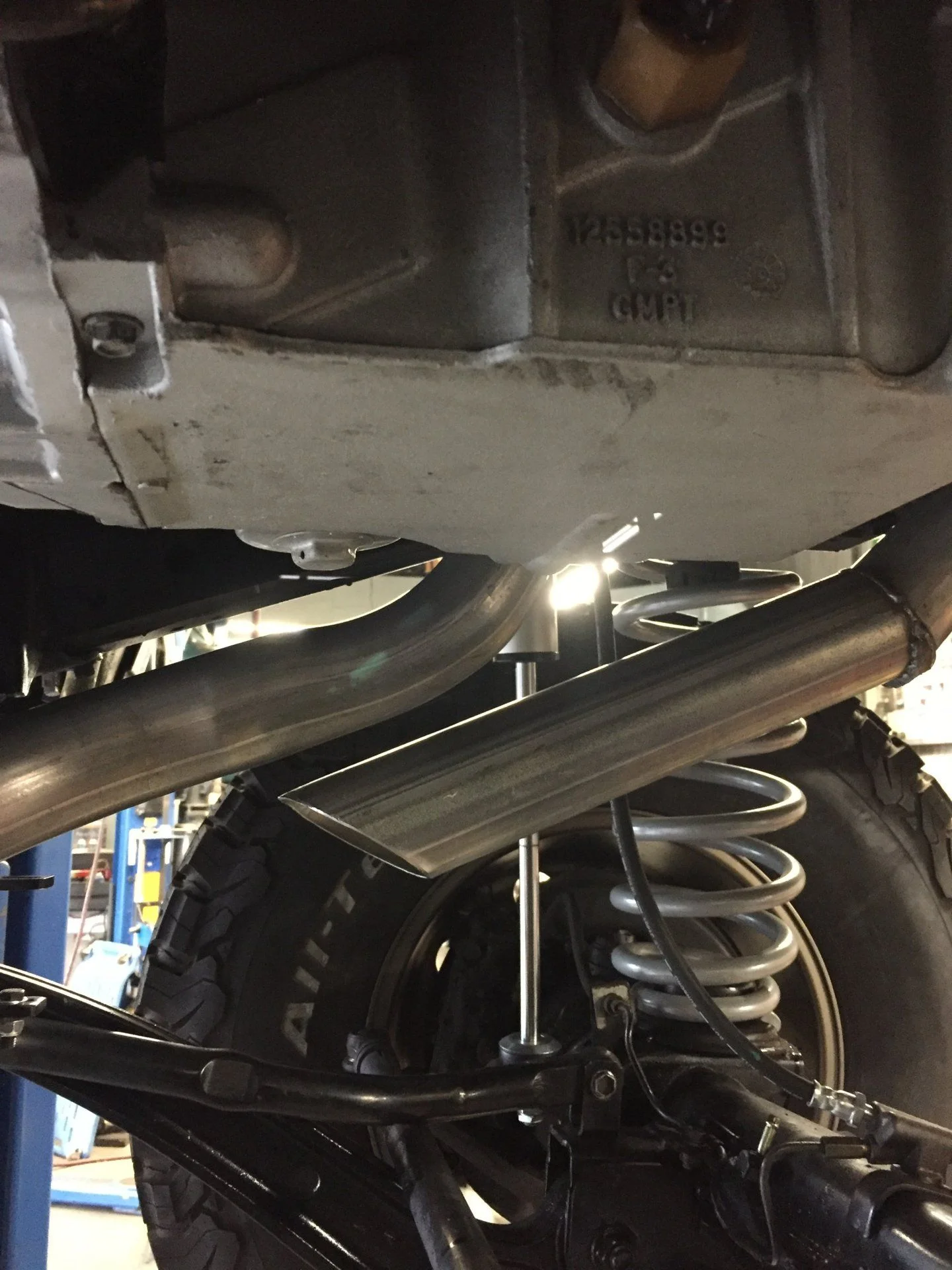

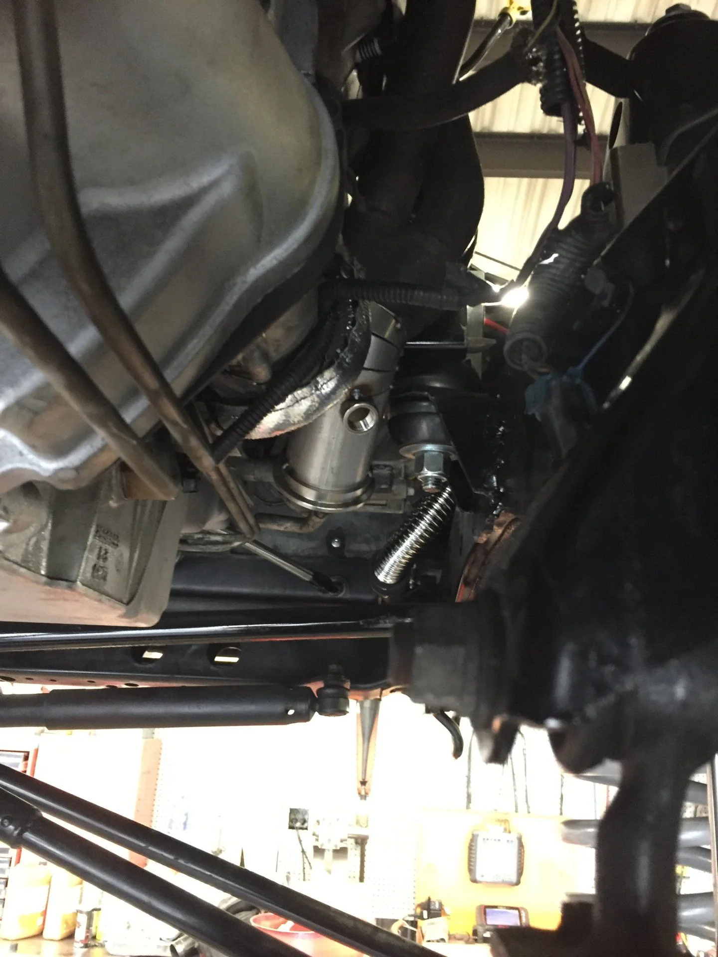

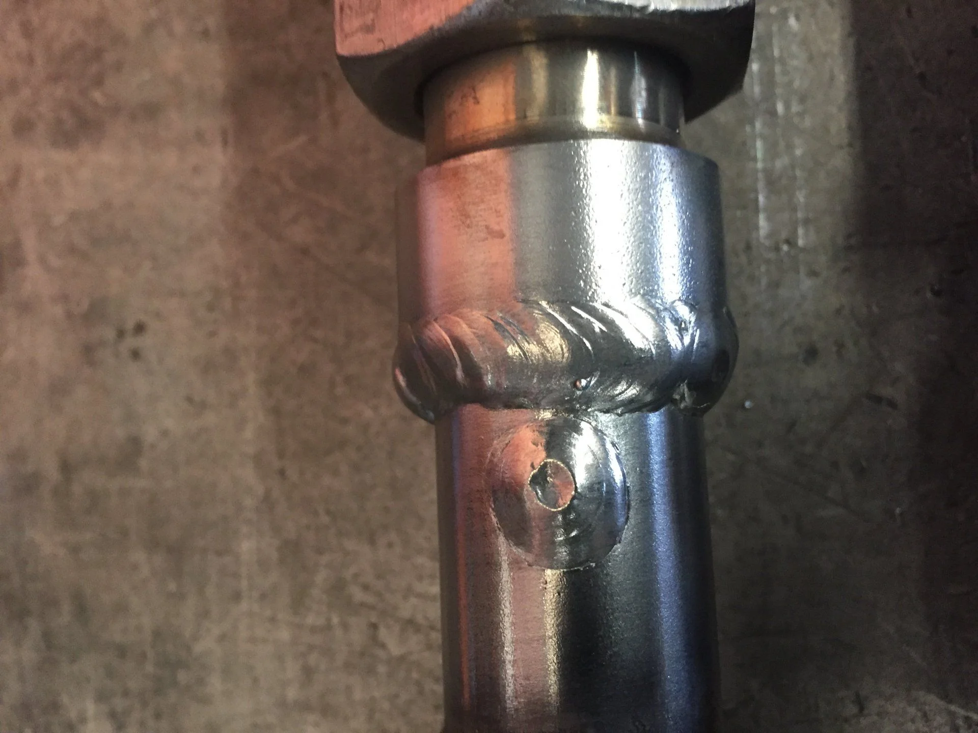

The exhaust was a challenge I enjoyed. I wound up with some block hugger hooker super comp that were laying around the shop. I cut the flanges, turned and installed V Band flanges for no leaks.
I was always thinking, if I ls swap, I’m gonna run 2-3 mufflers. I LOVE how quiet my stock exhaust 1fz is. Then again I love the sound of a throaty ls, but I could always run electric cutouts and get both!
Nice work op, I’m jelly
I can say When I’m driving my stock 80 w 1fz It’s not like I want it to be louder ever. On a good trip the LS could definatley be quieter tho. At 65 it purrs down the road. Cruising at 80 it can get annoying. Now I have to get the stereo mod

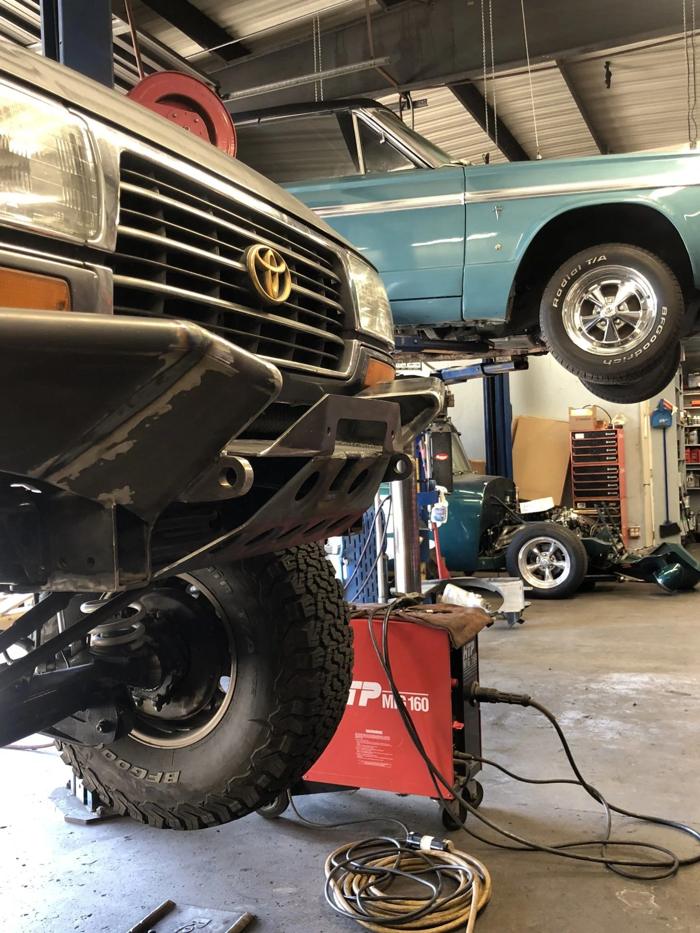

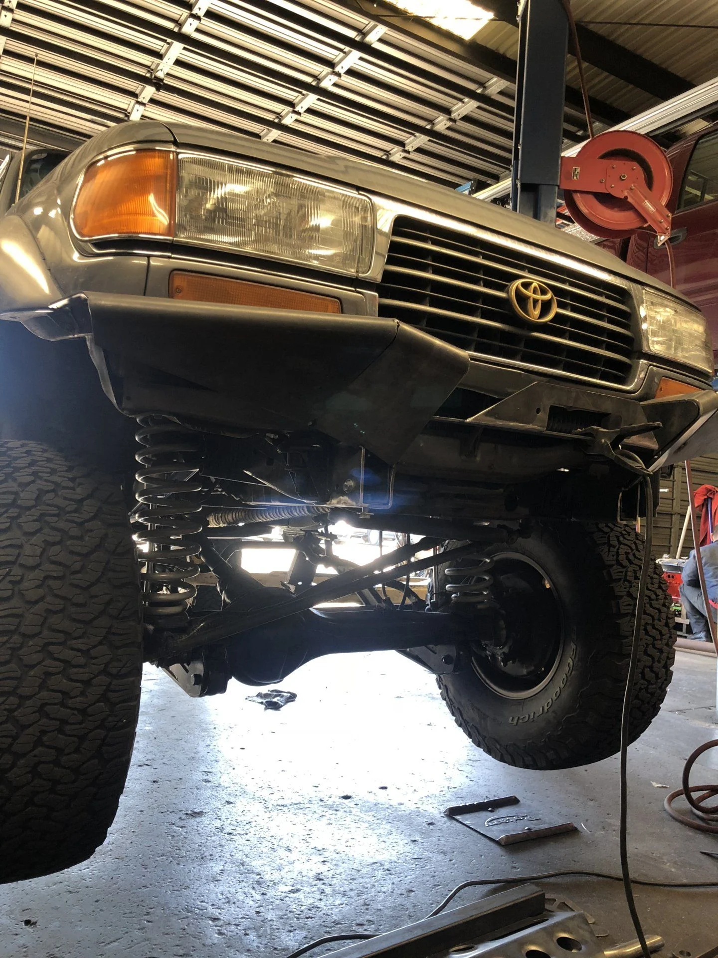

This thing was fairly easy to assemble however no instructions or good pictures to go off of made for a creative time. I still need to mount the winch and set the bull bar locations
