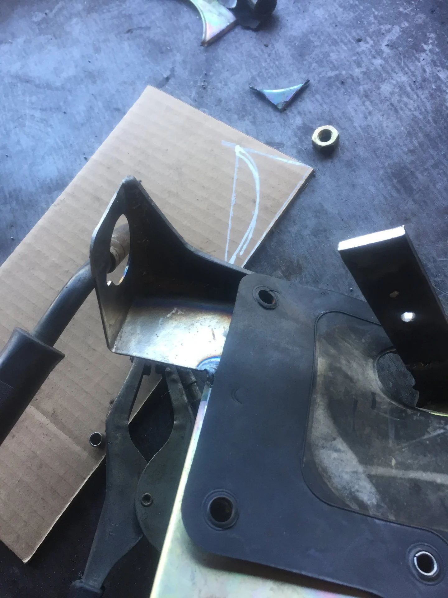

As far as the auto shift...
I messed around with the shifter base and swapping the lower connecting arm to the other side/ cutting the base and such, but in the end the stock Toyota shifter with its shift arm below the base cut and lengthened with a piece of metal worked the best. And allowed the rubber grommet for the shift arm to be utilized. I wound up getting a 91 shifter, using its base for the proper shift detects and using the 96 shift button, handle and shaft...fabricated a bracket for a GM shift cable and attatched to the trans
I found the length and throw of the shift arm on the trans affected where I should drill and attatch the cable to the shifter arm. I simply measured the distance from park to low on the trans arm. Then I picked a spot on the shift arm that moved the same distance. I used a piece of paper to make marks at each end of travel. Draw a straight line and measure. It took a few tries until I found the right spot on the shift arm to drill a hole. After that I created the bracket to hold the cable. The first bracket I made was angled wrong and a little too long so I couldn't use it.
I would recommend installing the shifter and cable in the vehicle then placing the cable housing in the correct spot for adjustment both ways. Try to make sure you get a full range of shift. Then measure how long and what angle the bracket should be that holds the cable. Kinda like the measure twice cut once. It's a pain without a bracket which is partially why I made the first one wrong. I just needed a base line to go off of so estimated the first try then fin tuned off that. I did t get any pics with the cable installed but this is what I came up with.
Once the bracket is on the shifter I had to cut some of the LC body to fit it in place. Silicone and body glue to seal it all back up. But only once everything is in for good. I still haven't sealed it in as I know it's possible i may be pulling the shifter out for some reason. Figured I'd wait till I plan on going through a water crossing

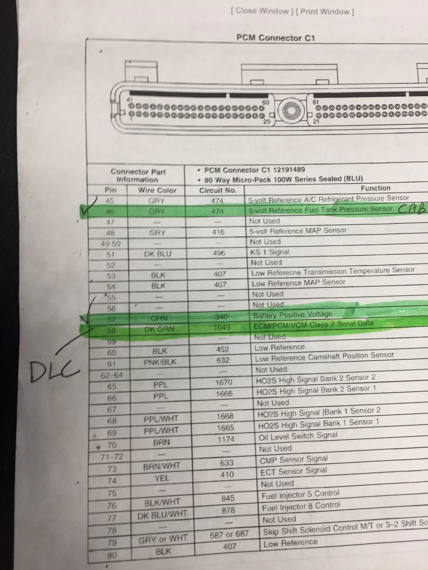

Far as the ECM mounting I just mounted it to the firewall using the stock Camaro plastic holder. There was a stud sticking out from the HVAC unit. I used that coupled with a few self tappers seemed to hold it well, plus the stock harness fit there as well. The Check engine light Ground was tied in at the ECM Y-R wire connector D-Pin 4. It was the only connector left after 1F harness was removed, easy to verify the right wire also, just ground it with the key on.
DLC was wired in at the OBDII connector under the dash. I went ahead and ran a wire from passenger to driver side that was easier for me than finding it in the Toyota harness. The Blue LS connector 1 Pin 58 Dark Green Wire is Class 2 Serial Data. Goes to Pin 2 on the DLC
Cruise Control is not quite there yet. I was thinking I may be able to utilize the stock toyota , being i have a cable operated throttle body. If I get the toyota ecm powered up and the correct inputs I may be able to trick it into working, otherwise gm or aftermarket will go in. but more on that later.
I used a separate fuel pump relay (I mounted it near the battery) triggered by the gm ecm and attached the feed wire at this connector behind the driver side kick panel. eliminated pulling the carpet for me
Beware there are 3 wires in the gm harness that need power aside from the pcm inputs. One is for the bank 1 injectors and 1 for the bank 2 injectors. And also there is one that powers up MAF sensor circuit. They require 15 amp fused KEy On circuits. I believe they are all orange or likely pink wires but double check per diagrams. Won't run without them

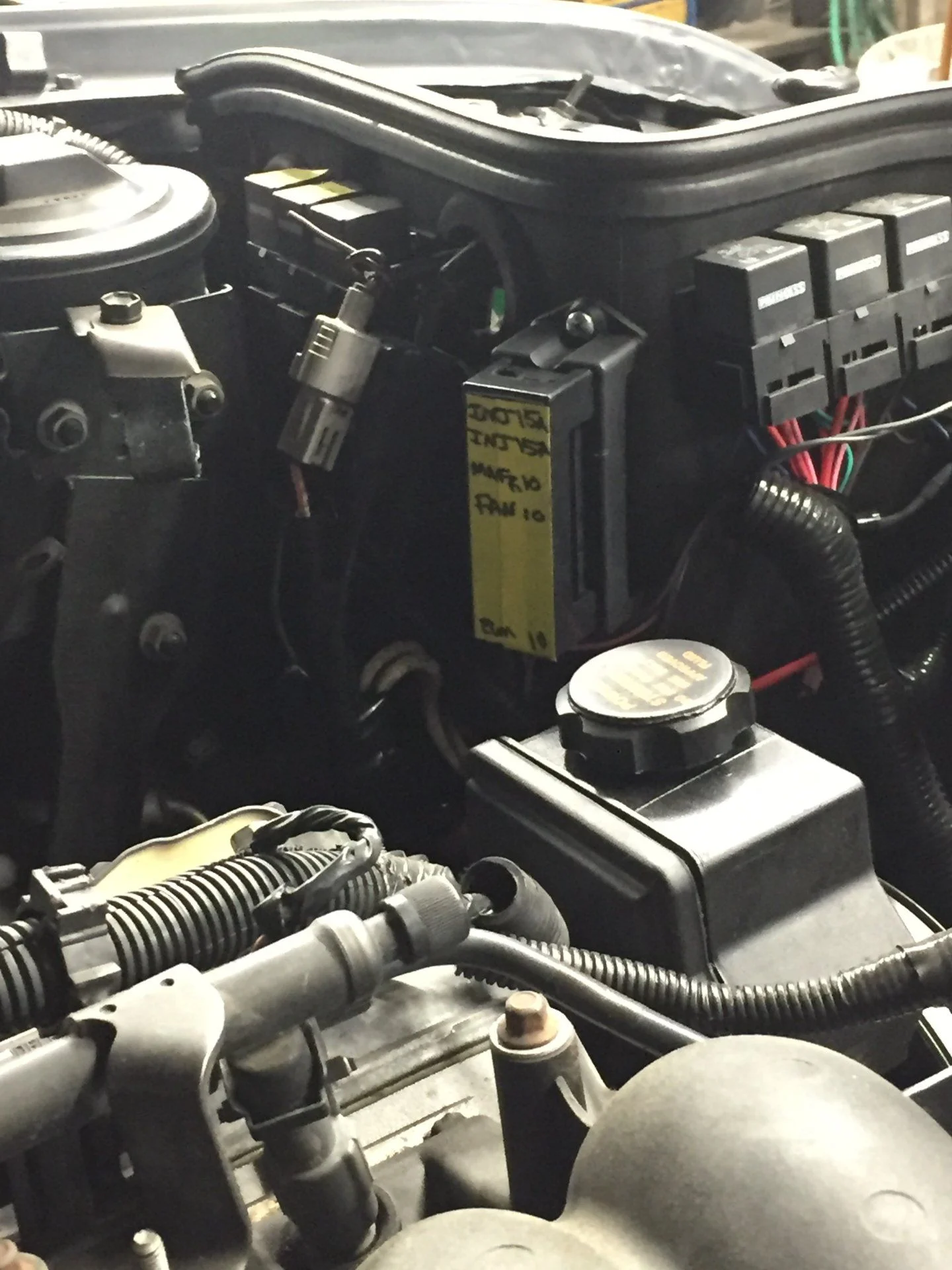

So along the lines of wiring I finished some loose ends today. I had just thrown some power to the harness to get er going. Today I wired in a fuse block and added some wire to get everything fused properly. Carefully labeled the wires with little tags and tucked everything into some loom. Really cleaned up the install and got a clear understanding of how the it's all wired.

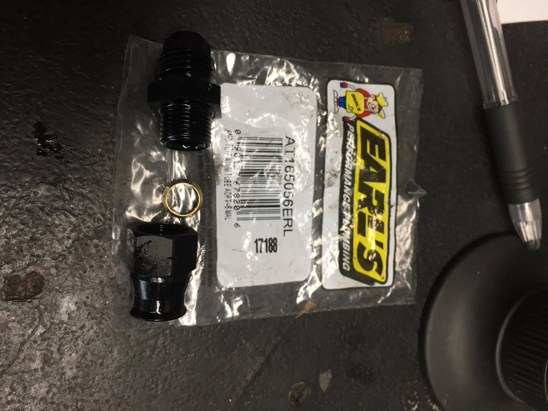

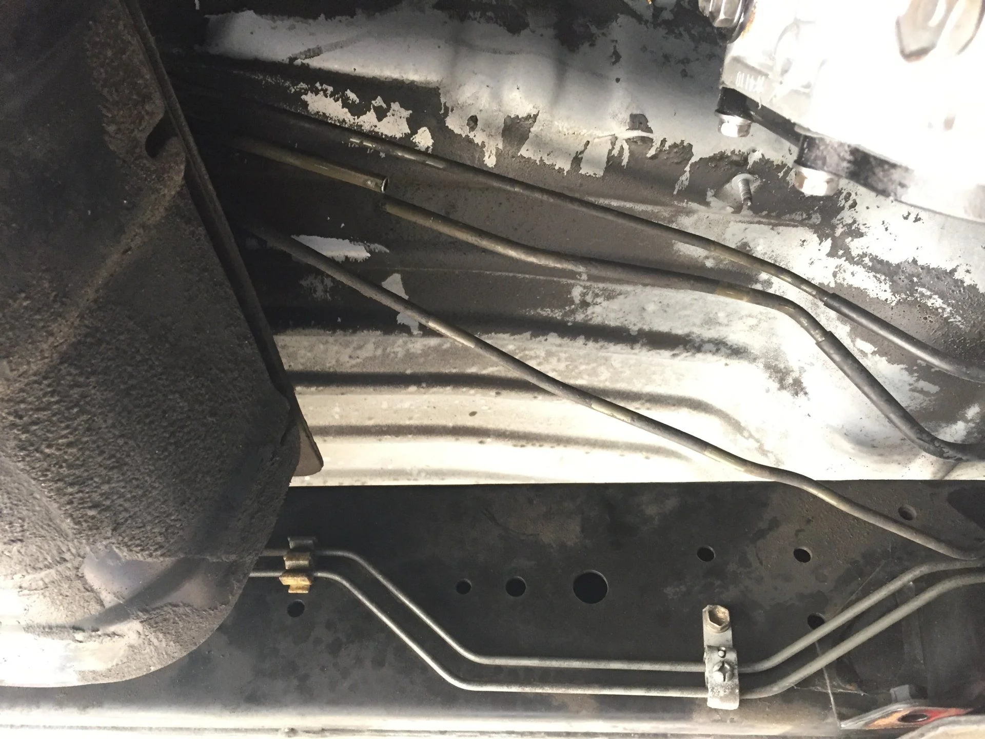

I used the stock fuel lines and installed Earls AN line unions to switch to AN Braid. Just send on earls website and searched fittings until I found what I was looking for. (Listed on the first post). Also found a fuel filter/regulator kit from summit that includes the an fittings.
Cut the lines just in front of the fuel tank an installed the earls fittings. They are snug fit but went on nicely. Then made a couple short hoses to adapt to the filter. The filter returns the fuel after it regulates pressure the thus allowing one feed line up to the fuel rail. Clean and easy. Ran it along the stock lines and even used the studs to attach line clamps to hold it in place.
I used the same style earls fittings on the transmission lines. One trans hardline went earls-6an braid hose-the cooler tubes under the battery where I just slipped the braided hose over the barbed tube and double hose clamped. The other trans hardline went earls fitting- 6an braid to the radiator fitting on the passenger side.

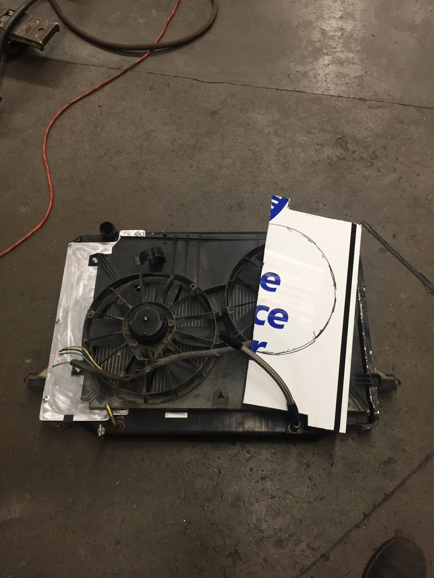

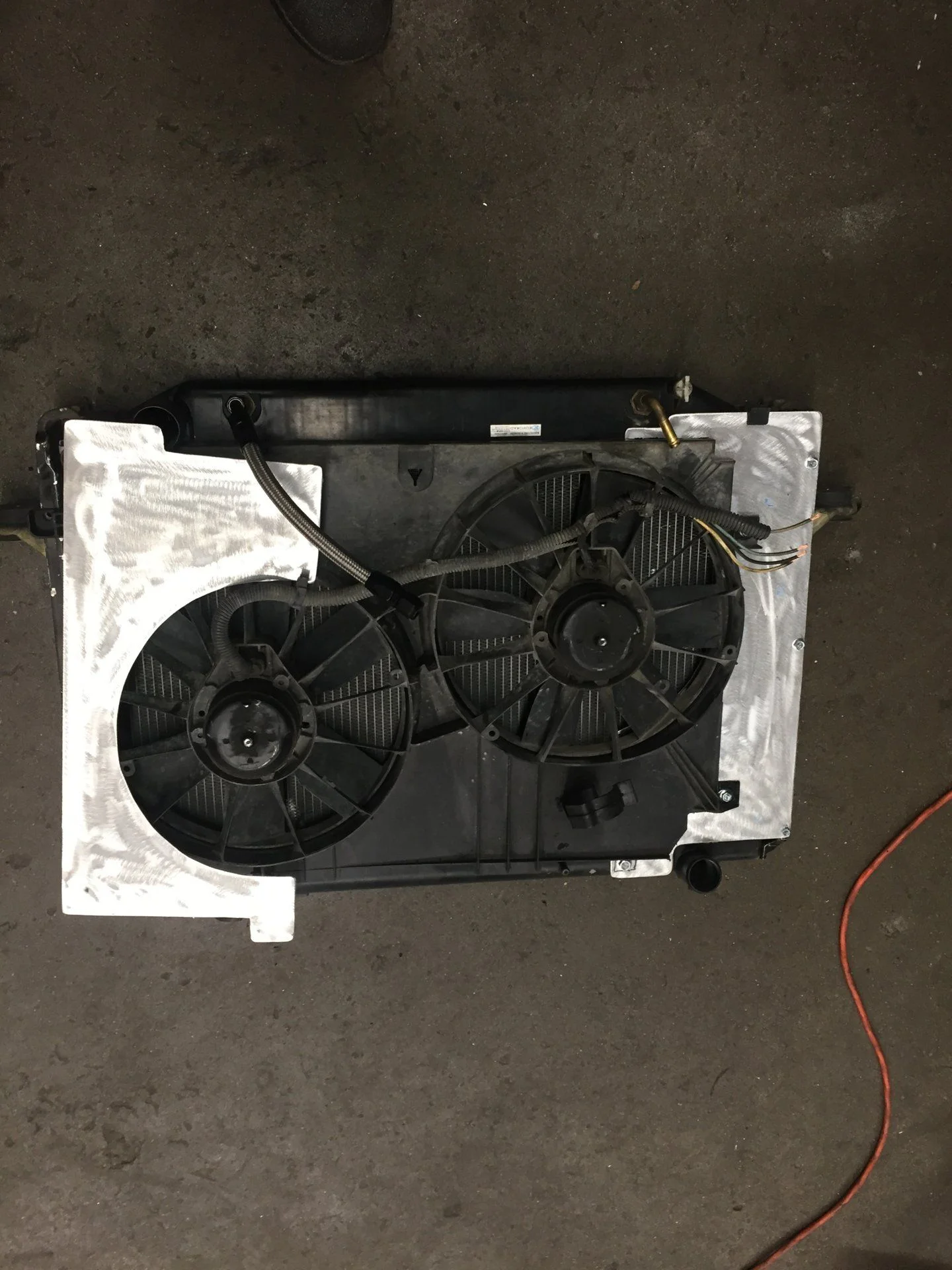

I cut an old AAA sign up to make a shroud for the LS dual fans was pretty simple just had to slide the metal untie the bottom shroud bracket and trim out some moons for the fans to pull from 6mm bolts and self tappers to attach all. Trimmed the fan shrouds to make a nice flat surface to attach and no air leaks. Worked out good and sturdy. Also have had no overheating issues whatsoever and it was cheap! Installed new fan relays to finish it off.
Once I got the radiator in things we're really coming together. The trans was in, the engine set and shifters working. All that was left was radiator hoses and driveshafts. I tried finding some radiator hoses by walking the isle at the ZONE and after several attempts at different hoses I finally just sucked it up and bought the summit stainless upper and lower hoses. I call them "You bend em" hoses. I've used them on some hot rod projects before and have had good luck with them so I figured I'd try it here. The heater hoses I used are listed on page one. One hose was little short so I used a barbed brass hose connector NOT some chinsy plastic to join hoses.

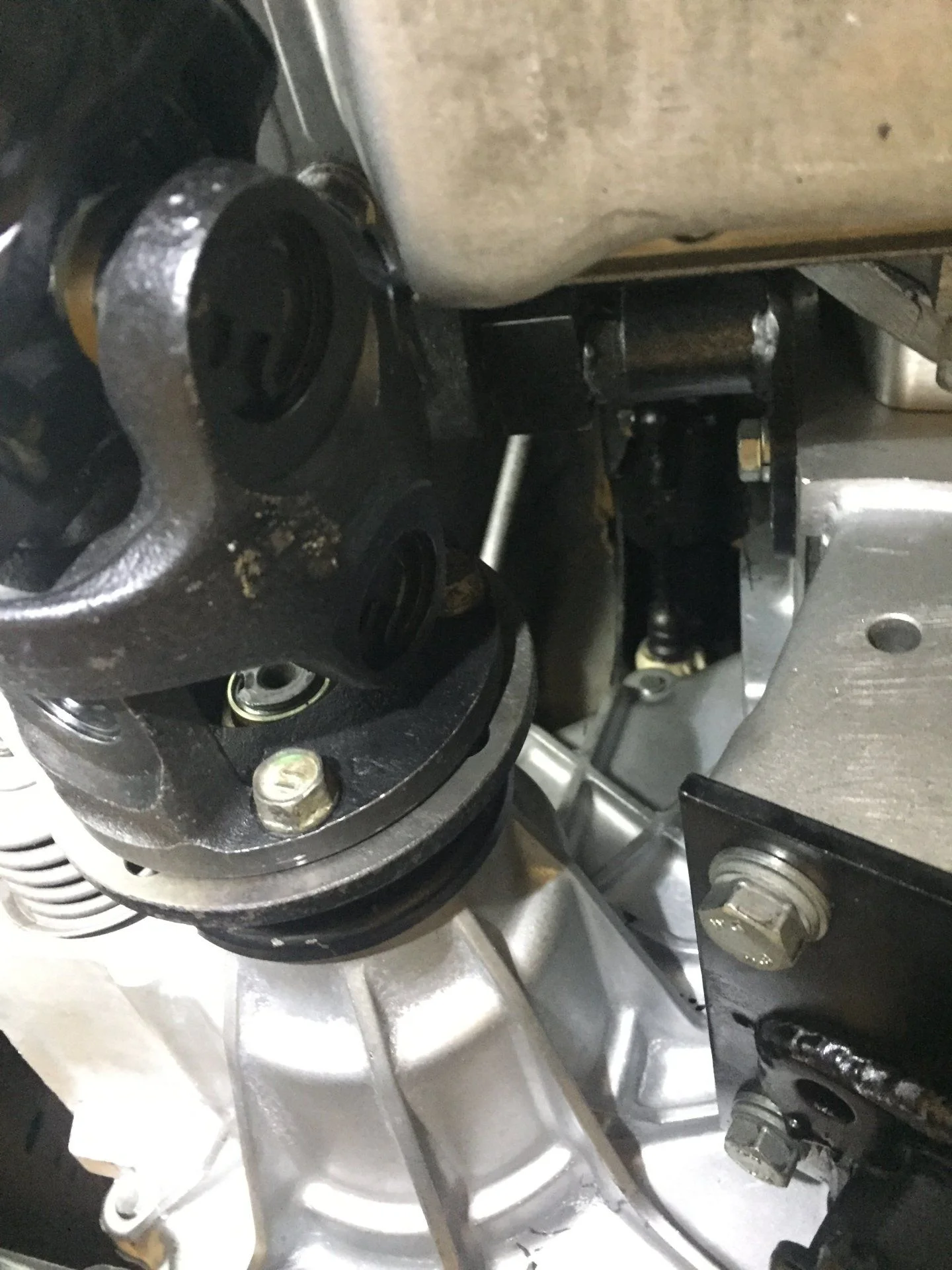

The driveshafts were fairly easy but had to be subbed. I went with Tom Woods driveshafts front and rear. They are very helpful and have a good product for a very reasonable price. Plus it shipped writhing 48 hours. Give them a call, you probably won't regret it. The front shaft is very close to the trans oil pan. You actually have to beat the Pan in as far as you can to clear the shaft. Careful not to busy the 2nd gear accumulator housing inside so just easy taps until it forms around the inside parts. I wa sable to use the stock split case flanges. I went with the small flange pattern on both ends of the front shaft so I would get the most clearance. For the t case flange I pounded out the studs and clocked the driveshaft 45 degrees and drilled new holes to match the smaller pattern. Went right in. Also had a double cardon shaft.
NOTE if you order a double Cardon for this type of install ask them to weld the balance washers on the shaft and not the double Cardon.
The read shaft was straight forward. Measure, order, and install.
