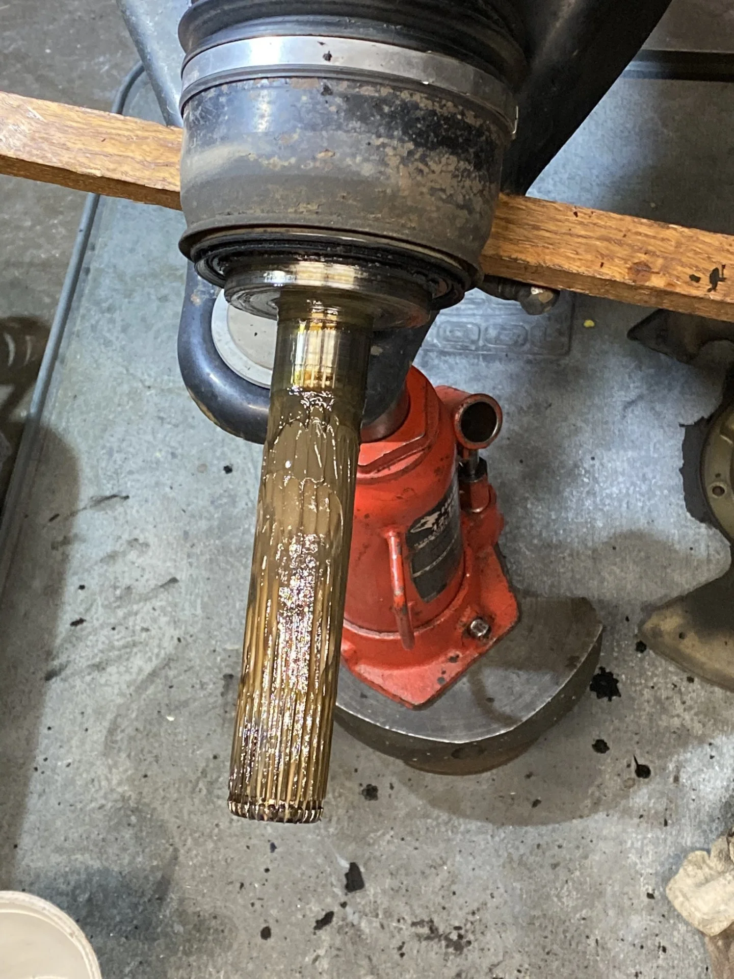

Old grease cap was reused, which had some chisel marks and did not very tight when removed. Water entry damaged axle and wheel bearings (other side not pictured, was worst).
Grease turns brown when water mixed in. Apparently it was a pink grease, injected with a Slee spindle tool. 150K miles and I ended up replacing axle and wheel bearings. Which is very rare to need to replace any.
