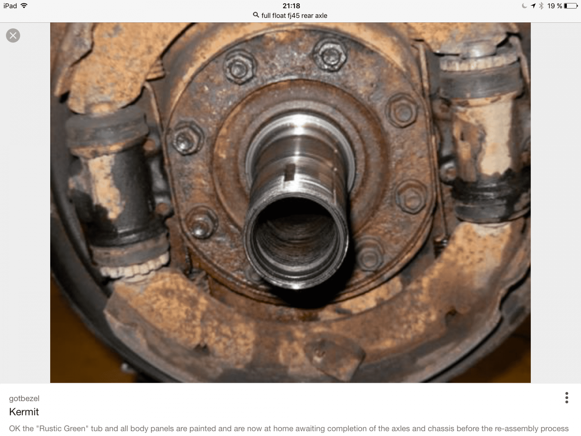

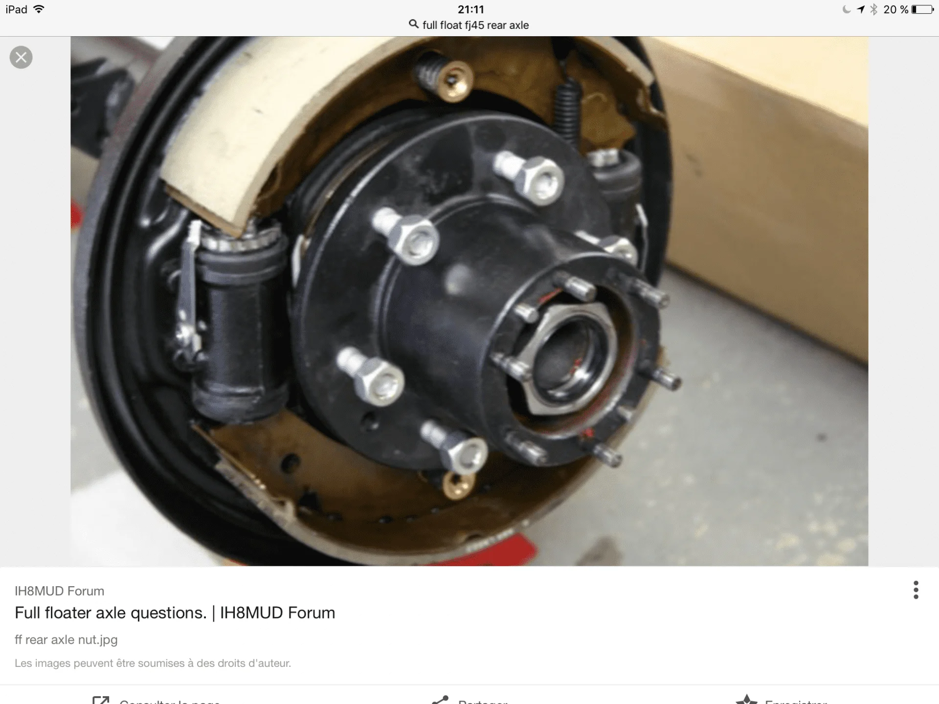

So, I have a canadian fj45 rear axle and I want to install the TrailGear studless hub.
The problem concern the inner seal that prevent the diff oil to mix with the grease inside the hub.
There seems to be 2 types of seals:
1) canadian version: The seal is made to go on the end of the outer 54mm bolt that screws at the end of the spindle. So, that bolt with seal extends the spindle about 3/8".
2) us / australian version ?? : pretty different seal that goes inside the tip of the spindle. Thats the ont I'm interrested in.
My problem is: if I do install the TG studless hub, the locking puck sits about 1/8" (or even closer) to the end of the spindle. So, I have not enough space to put that canadian nut with seal that I have.
My question is: will those us/australian seals fit inside my spindles? The inside of my spindles are 35.12mm
Is there à shoulder to prevent the seal to slide inside the spindle?
I will try to post pics later I'm on the ipad
The seal style change is based on the production date
9/75-1/79 is the old, 1/79-97 (and newer non-NA models). There is a larger later seal too: Cruiser Outfitters
And without machining, newer spindle end seal won't fit into your axle.
