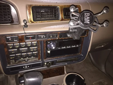

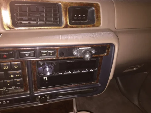

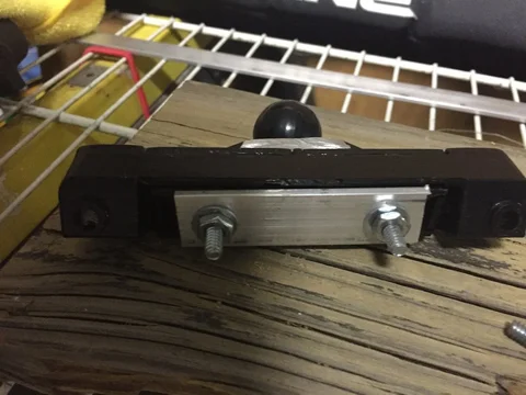

Here's the current status of my unauthorized Ram Mount phone-holder install.
I took a RAM 2 7/16" X 1 5/16" base and with my cutoff wheel grinded it down to fit the height of the bezel. I drilled holes in the blanks and bolted the base to it. Its solid on the blanks, but I'm going to either glue them in place or add a brace across the back to reinforce. Then I installed the bezel and clipped a Ram Universal X-Grip to the base. Still need to paint the bare metal on the Ram base.
Only issue I have is the screw on the right side of the bezel into the dash isn't long enough to bite. Going to replace it with a longer wood screw tomorrow unless y'all have any advice for me.
I'll let y'all know how it holds up, and I'll post better photos during the day.
that's a lot of weight for those little tabs. I'm very interested to see how this works out.
Agreed! When I remove it to replace the short screw I'll post a shot of the bracket on the back. The way the bracket joins the two blanks together it tightens it up on the bezel's center strut and holds very well. The stress is more on the two screws holding the bezel in place than the blanks, but even that is mitigated by the overall shape of the bezel fitting tightly into the dash. I know it looks iffy, but I have a lot of confidence in it.

that makes sense. I'm glad you figured out a way to make it work for your needs.

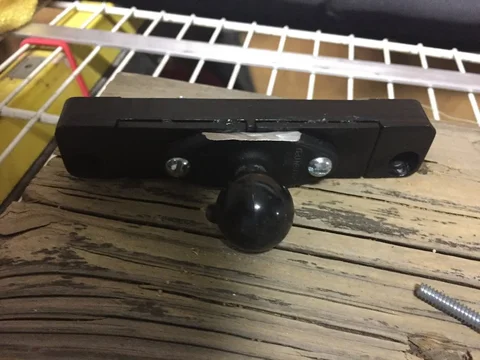

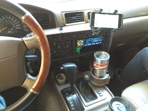

Here's how the bracket fits, takes all the strain off the tabs and puts it on the center post and frame of the bezel. Feels very sturdy! Should you ever make a blank bezel I might consider purchasing it to take the tabs out of the equation, but for now I think this will last the long haul.

That looks pretty stable. I love seeing other uses for my stuff. I'm working on a phone mount for the bezel right now. I have gone through a few prototypes and will have something to show you guys after the holidays.

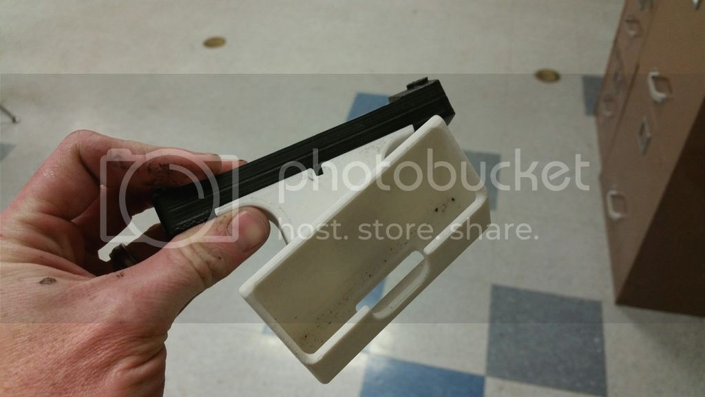

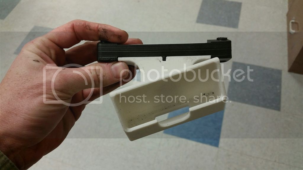

I made two prototype phone mounts for the new bezel and shipped them out a couple weeks ago. I should have pics of the phone mount installed with some good feedback really soon.

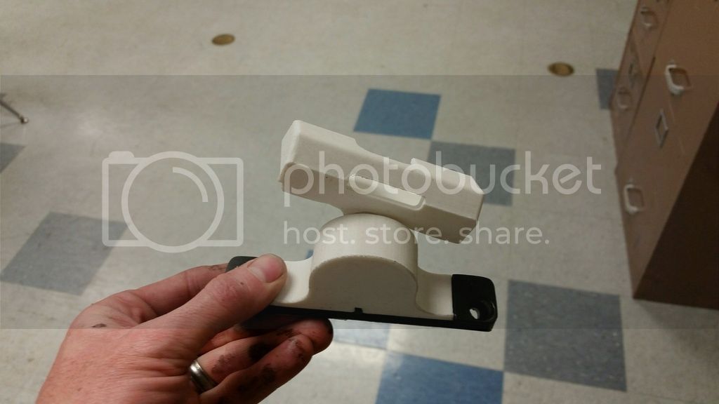

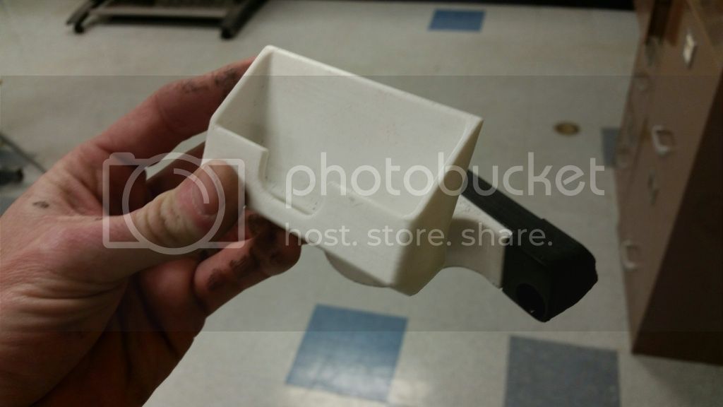

Here's an early rough prototype of my idea. This was not the final design I shipped out for pics but you guys can at least see what I was thinking. I always prototype in white to better see features but the final design will be in black to match the bezel.
